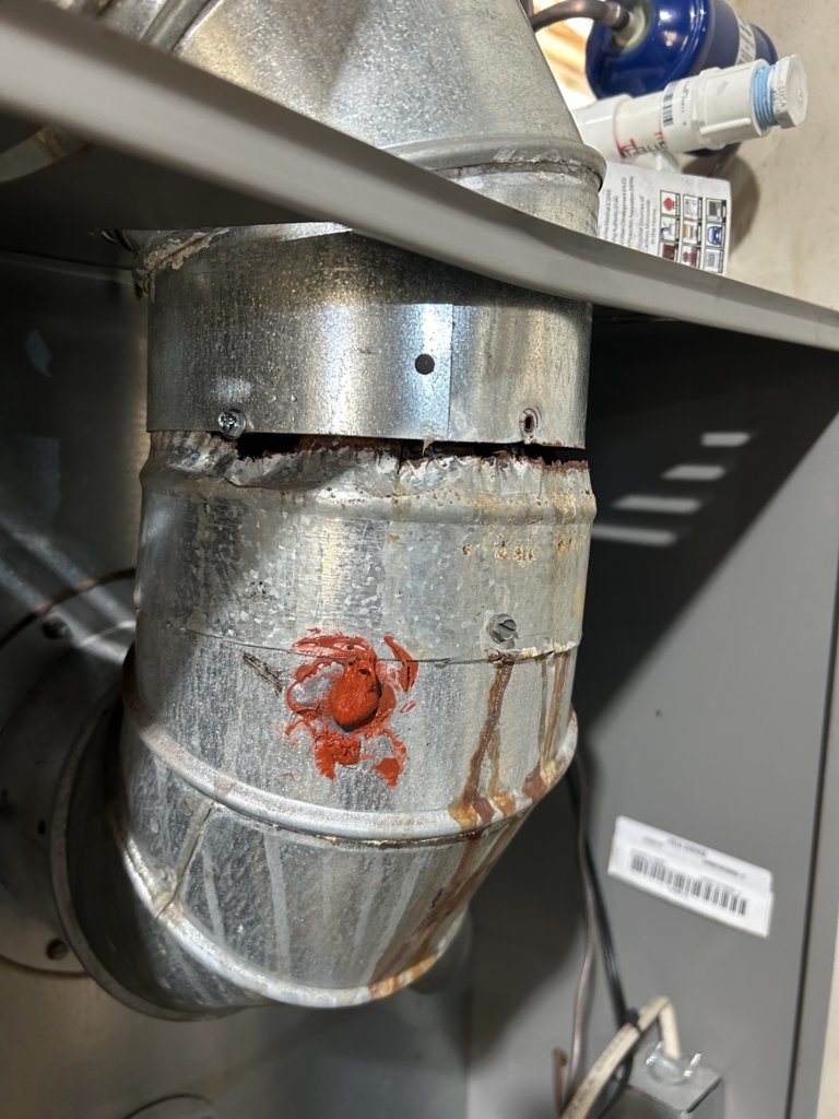

    I had to relocate some duct from the HVAC to begin the PEX A and this is what I find…IMG_8329.jpg a few other joints with big holes as well. We recently (4 months back) had a new HVAC installed. Quality work is non existant in the northeast.

    HVAC foil tape or redo the ducting?

    I used foil tape

    both those elbows should be replaced

    Is that the flue? Seems like a lot of condensation coming back.

    Since the condensate is acidic, it accelerates corrosion of metal wherever it comes in contact.

    If that’s 4 months I would call them back and see if they have proper airflow to prevent potential health risks as well.
    This is a gas furnace right?

    Oil

    Yes

    The flue pipe needs to be all metal, replace it.

    I agree. If it were mine I would have workers replace at their cost expense, or replace it myself the correct way.

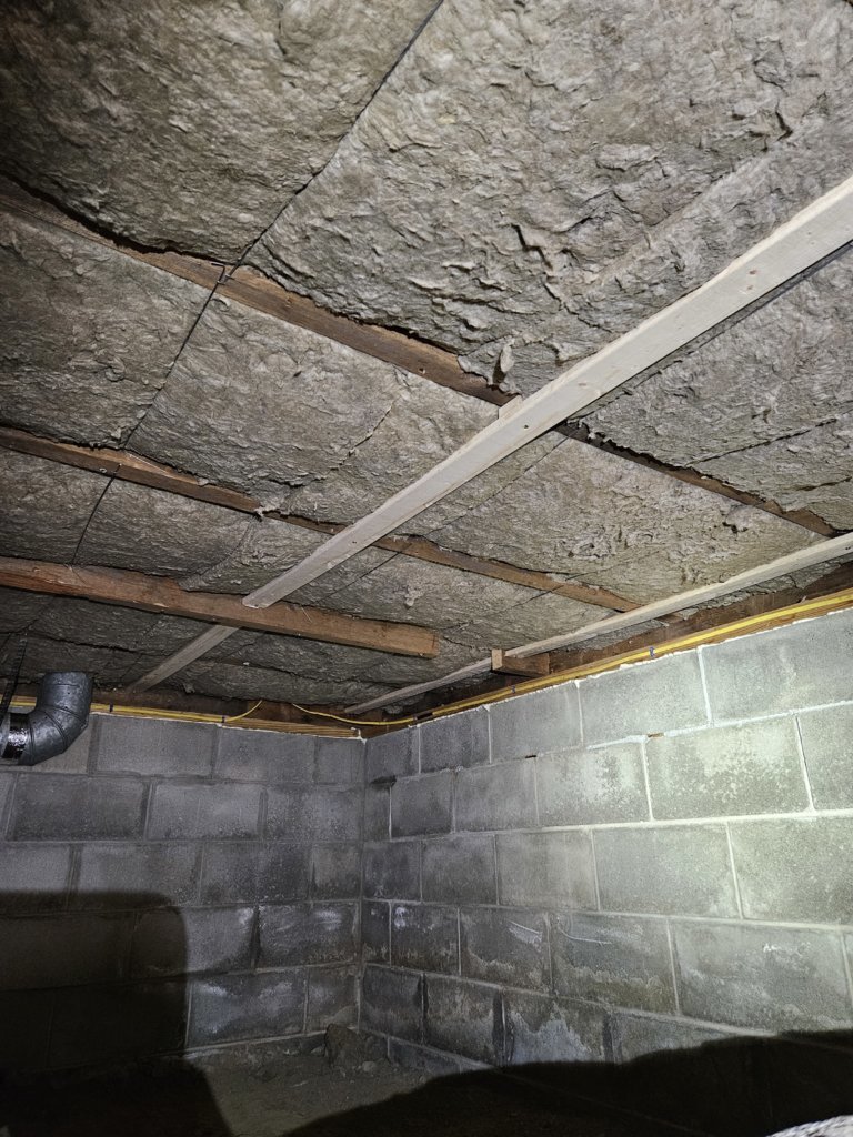

    Finally got the Rockwool up in my crawlspace this weekend. With a lot of help from my old man. What a chore..
    Rockwool Comfortbatt was the only option in my area to fit 24" OC x 5.5" (R23). The stuff is not super fun to work with overhead.. We used insulation wires to hold it up as we went, but I need to strap the entire thing with 1x3s as time allows. Even the wires aren't doing a great job
    Started with two straps. Now Im thinking three per 48" batt, unless anyone recommends something else

    I've always seen the wire run zig-zagged
    could do a mesh like bird netting
    or hardware cloth if you're looking for rodent blocking

    @CraigF has a solid idea too, alternatively twine plus stapler!
