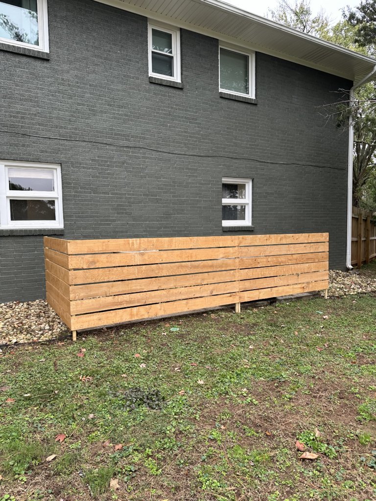

    This looks great but why didn't you at least use 2x4 post?

    Wanted the minimal look. These 1x’s are about 3ft in the ground, so plenty sturdy to hold the thin fence slats. They were also easy to shape into a “spike” for driving into the ground lol

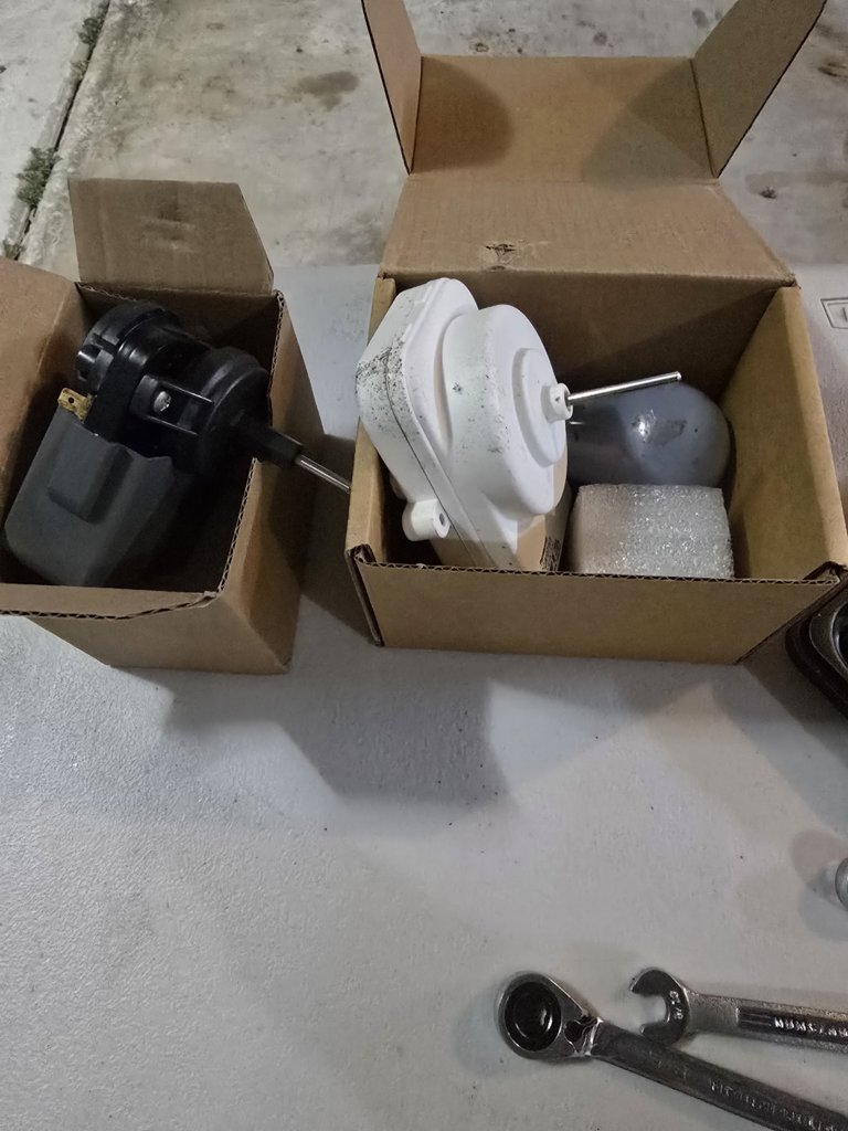

    My garage fridge bit the dust during last hurricane power transfer to the portable generator. I watched a few videos on diagnosing and repair, and I got lucky, well, got lucky with the fridge. The compressor seemed to be running fine, but only the bottom of the freezer was freezing. That was a clue. I found that the compressor fan was not operating, and the cooling fan was also observed not running. I pulled both fans and after some diagnosis decided this was likely the problem, could have been the board but my fingers were crossed and the diagnosis of the fans included extraction and connecting to 110V which produced nothing.
    I figured fixing better in the long run as compared to a trip to the metal/appliance recycling center which probably would have produced about $30.00.
    Got the fans from Amazon, $16 + $19 and some change and taxes, plugged them into the fridge in their location, and wa-la, all fans are now working. Cleaned the heck out of it, found out there are 5 bulbs in the fridge and freezer combined, replaced 3 of them, tightened a loose door hinge bolt that has been loose for the past 6+ years lubed up the lower hinges and the popping noise is gone and the doors are SO smooth operation.
    https://www.amazon.com/dp/B09DJW3MDR?ref=ppx_yo2ov_dt_b_fed_asin_title
    https://www.amazon.com/dp/B08XPBQ99V?ref=ppx_yo2ov_dt_b_fed_asin_title
    pics:
    Dead Motors:
    Installed & Operational Motor 1:
    Installed & Operational Motor 2:

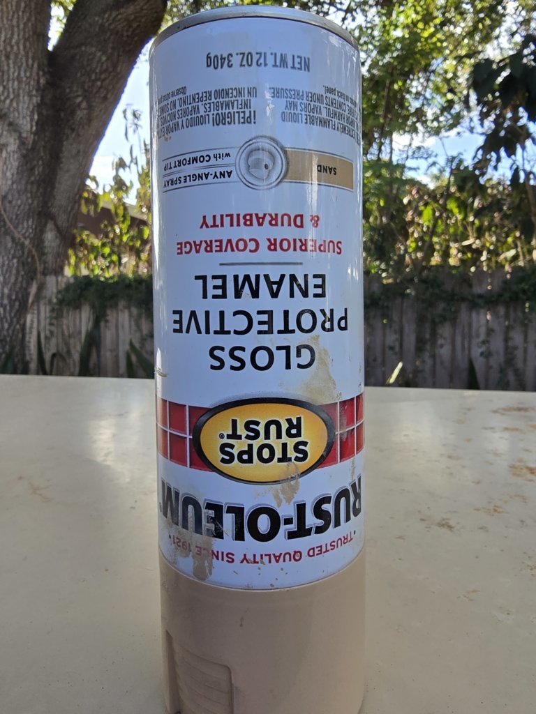

    Guys I could use some advice on my generator case lid. I'm getting some surface rust, what are some options to arresting this rust-advancement?
    Can I spray this rustoleum directly without any preparation more than scrubbing off dirt with a kitchen scouring pad? Which I've just done.
    Okay, after zooming into preparation, a light sanding is suggested, I suppose I can hit it with 220 grit.
    20241111_143245.jpg 20241111_143234.jpg 20241111_144414.jpg20241111_144839~2.jpg

    If you want to do it right, that rust needs to all be sanded off smooth as possible. Then a treatment product followed up with your choice of finish.

    Yeah I want to do it right. Darn, thought I was done with this never ending maintenance after the scouring pad cleaning today. :(
    Which treatment product could handle this?

    If you sand off enough I've had very good luck with this product.
    https://www.lowes.com/pd/Rust-Oleum-Flat-Gray-Spray-Primer-NET-WT-15-oz/3729777
    They make rust reformer products, but I've never used them. I always try and get off as much rust as I can. If you do want something more, OSPHO makes a really good product.

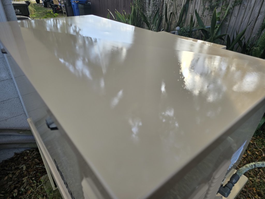

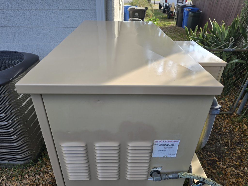

    Handled it. 220 grit all over the top, cheesecloth, then rustoleum. If the rust would have been worse I would have thought more about using a primer but it came off with sander, more of a discoloration of paint rather than rusted through.
    Thanks.

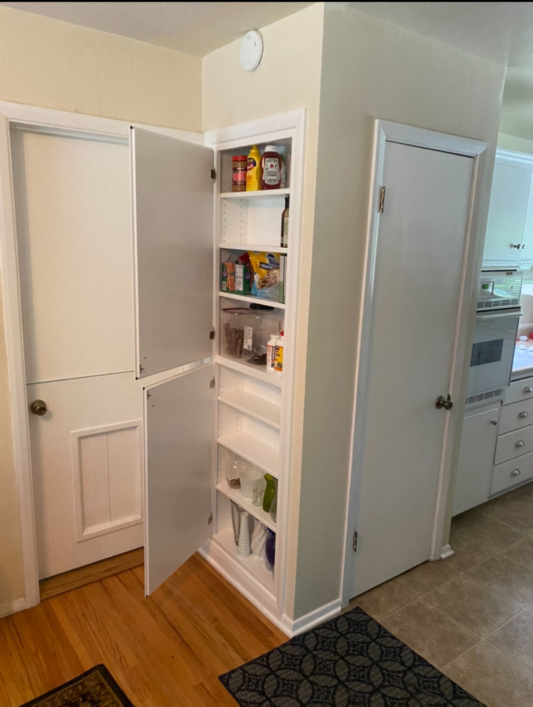

    Thought I’d share a recent project of mine, I never liked the way this wall was so I decided to give my wife a little more storage
