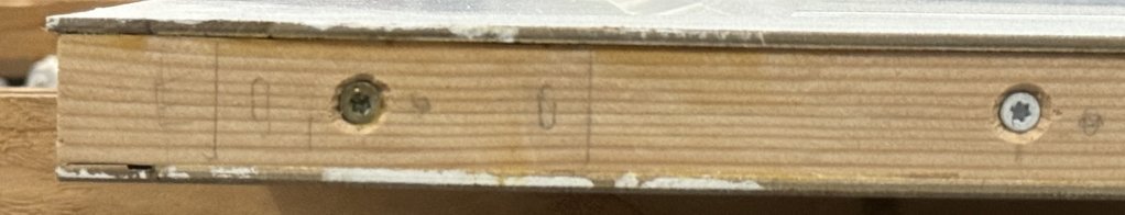

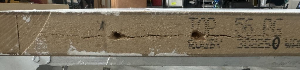

    Toddler toilet training temper tantrum…one of our bathroom pocket doors got slammed open hard enough that one of the brackets it was hanging from started pulling out of the top of the door. After a few weeks it gave out completely. Finally took the door down and found that the MDF it was formerly screwed into was toast. Picture is of the top edge of the door.
    I routed out said MDF about an inch deep, leaving the veneer face on each side in place, and glued and screwed in a strip of real wood in its place.
    Not pictured: new wood has been painted, hanger brackets screwed in, and door re-hung. Still need to put the trim around it back up.
    Hopefully this version will hold together better.

    Excellent, creative, solution. :thumbsup:

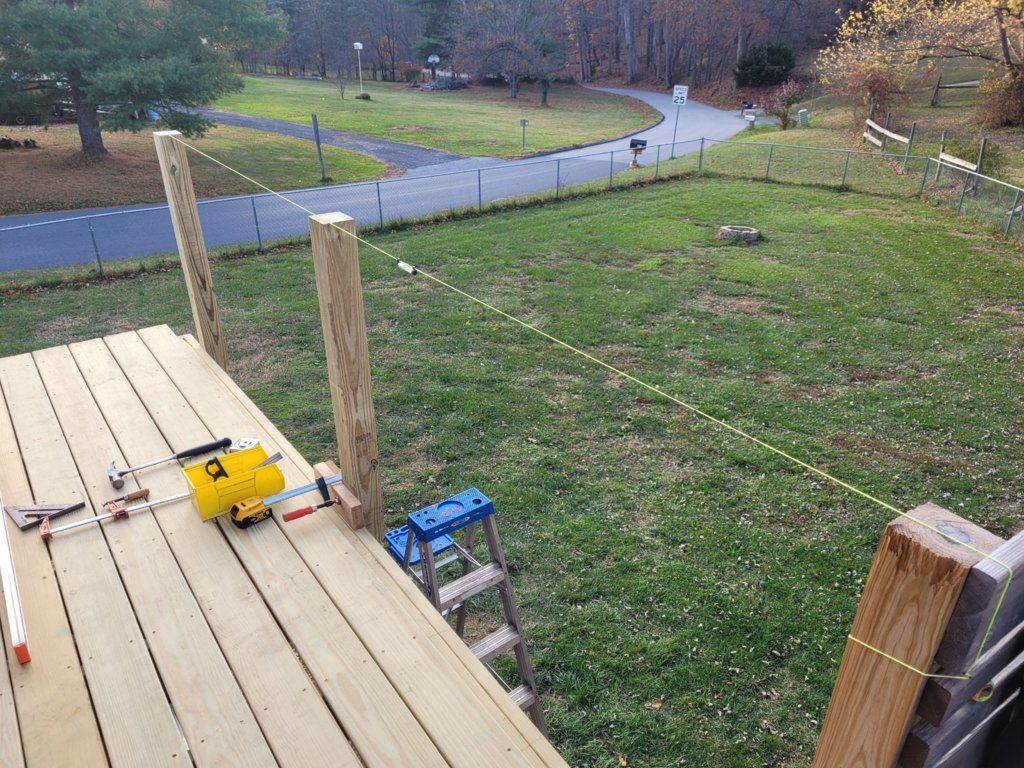

    Is this how the pros do it? I have less than no idea, but it never stops me from trying.

    Lasers are the way to go. I always notch the posts in, so they aren't just hanging on bolts. Deck looks good.

    String or laser.
    Or precut them all and attach a temporary cleat to support the post when attaching it, then they'll all be at the same height. Probably all the same amount of work in the end.
    I put posts inside the rim/band joist so blocking can be added for support in all directions. With lags bolts and/or GRK structural screws.

    Thanks. I'll be glad when the last screw gets driven into place. I didn't get "permission" to rebuild the decks, so it wouldn't have really mattered but the county strictly prohibits notching in the posts. I personally think that it makes a more solid connection.
    I went 1/2" galvanized carriage bolts for the posts. I thought about lags from the joist side to have a clean outer appearance but it was too late, as I already installed a few posts.
    The deck that you posted up turned out great!

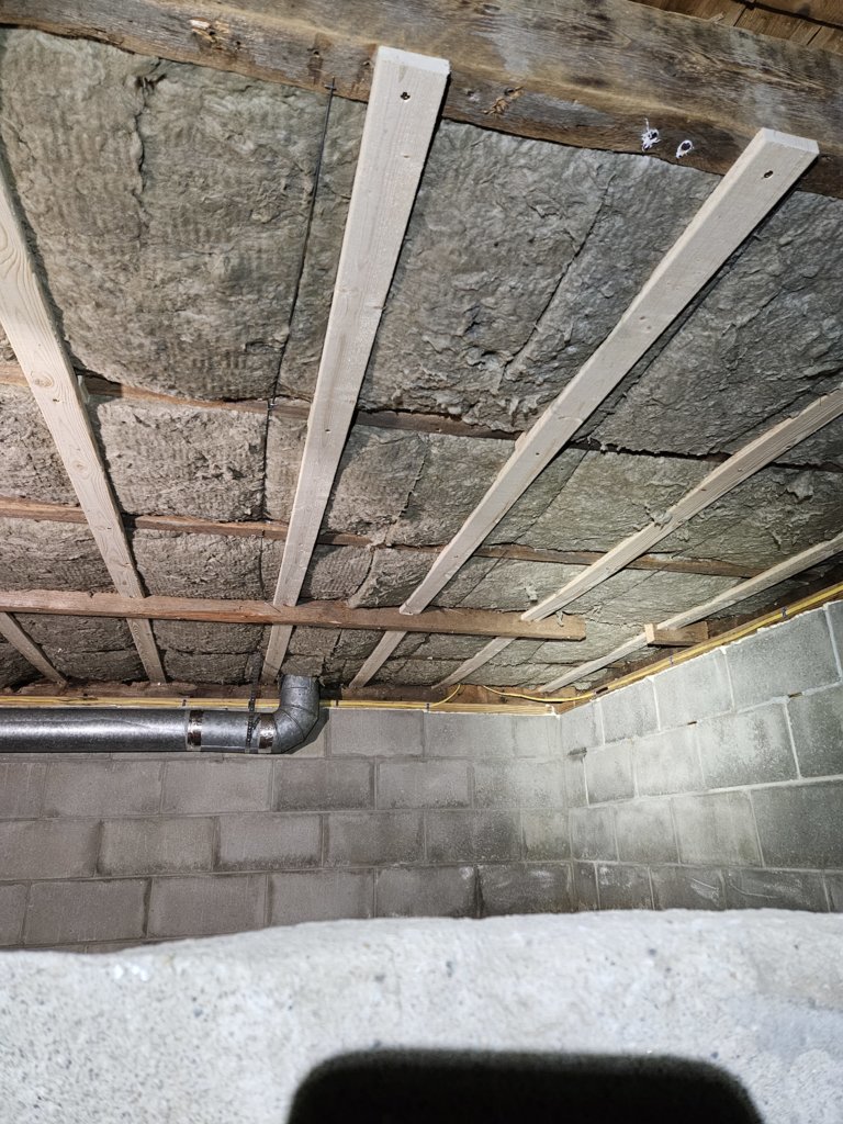

    Finally got the strapping up on my basement crawl space insulation project.. This whole ordeal has taken way longer than expected. :rofl:
    Very happy with the results though. There were two batts in the entire job that didn't feel right - they were loose and floppy for lack of a better term - like they weren't made right at the factory. One of them is in the last pic. You can see it had already started to sag down over just a month or two.
    98% done at this point though. Just a few small gaps left to fill
