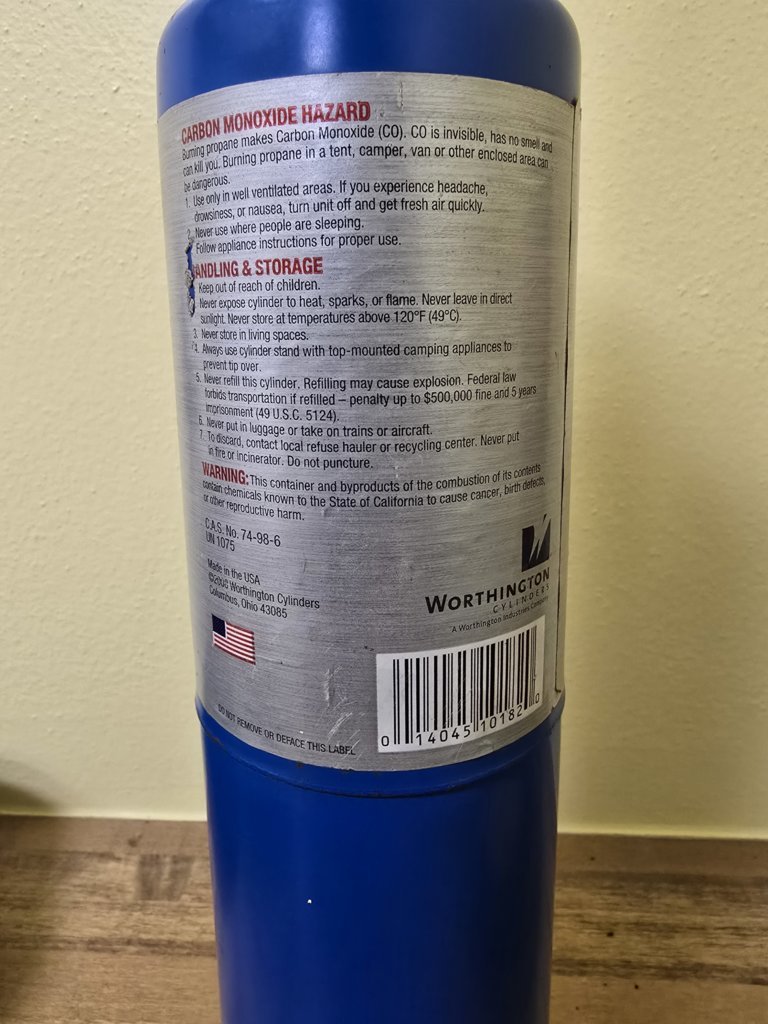

    You're not supposed to refill those. :boom:

    I think you're right, but this warning was created before the versatile refill adapter was made, they just need to update the warning, to state, Do not overfill.
    Wait, the 'warning', I'm not sure, doesn't it state 3 possibly conflicting statements on refilling?:
    1. Never refill this cylinder.
    2. Refilling may cause explosion.
    3. Federal law forbids transportation IF REFILLED.
    One might interpret as such. [and Never say never...] "Never refill this cylinder, but if you do be careful because it might explode if you overfill. But hey, if you got it refilled without exploding, okay, just DONT transport this cylinder anywhere using an automobile or other motorized vehicle, but you can take it with you if you travel by foot."

    Hahaha…one might interpret it that way. I interpret it as “Hey! Hold my Beer”…..

    Very interesting, I could see that.
