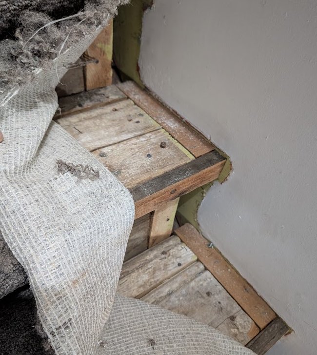

    My basement stairs have awful carpet and a few make squeaking noises and felt like the edges were breaking off, so I peeled back some carpet to take a look - figuring maybe I'll buy new carpet and replace the (assumed broken) treads. I expected to find 2x10s. Instead, I found this
    Any idea why anyone would do this? It seems like an insane amount of work for an inferior end result. What I thought was edges of 2x10s breaking off is actually the 1x2 on the face of some treads separating from the rest.
    Dimensionally, they're 9.75x1.5", so I feel like that's close enough to just buy 2x10s, cut them to the right width, and swap out these things. Thoughts?

    Looks like originally they used the leftover concrete form wood to make basic utility steps (wall paint, side filler and the color of the 2x4s)
    If there is a center stringer 2x10s should work just fine

    Makes sense. The basement used to be finished so he must have figured once carpet was over them, who cares. I am pretty sure there is a center stringer - it's all closed in from the back now but I can always pull one step if I don't have photos from before.

    If there's a center stringer, the treads and risers should be nailed down. A magnet through the carpet might even tell you. No need to rip anything apart until you're ready to replace them.
