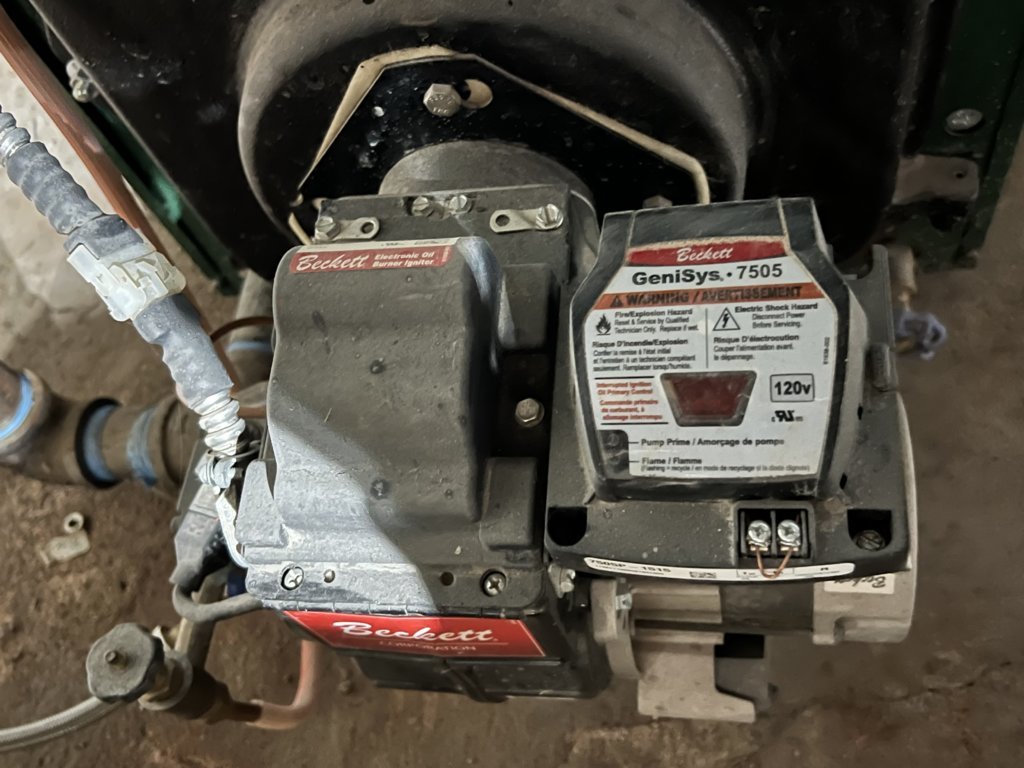

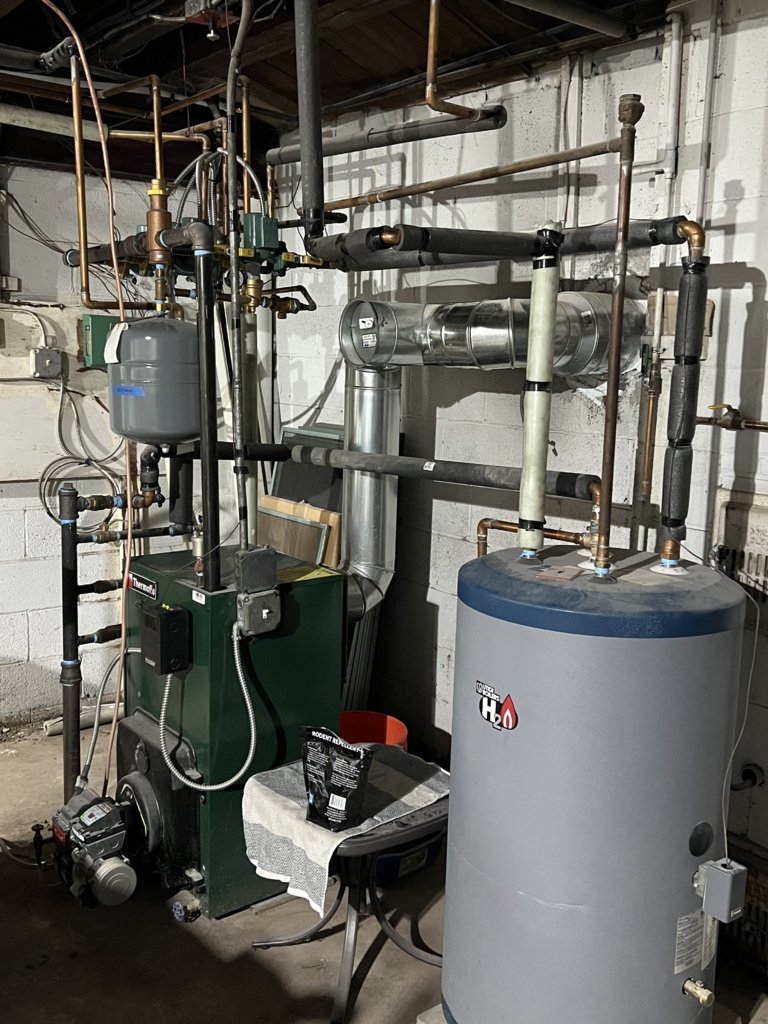

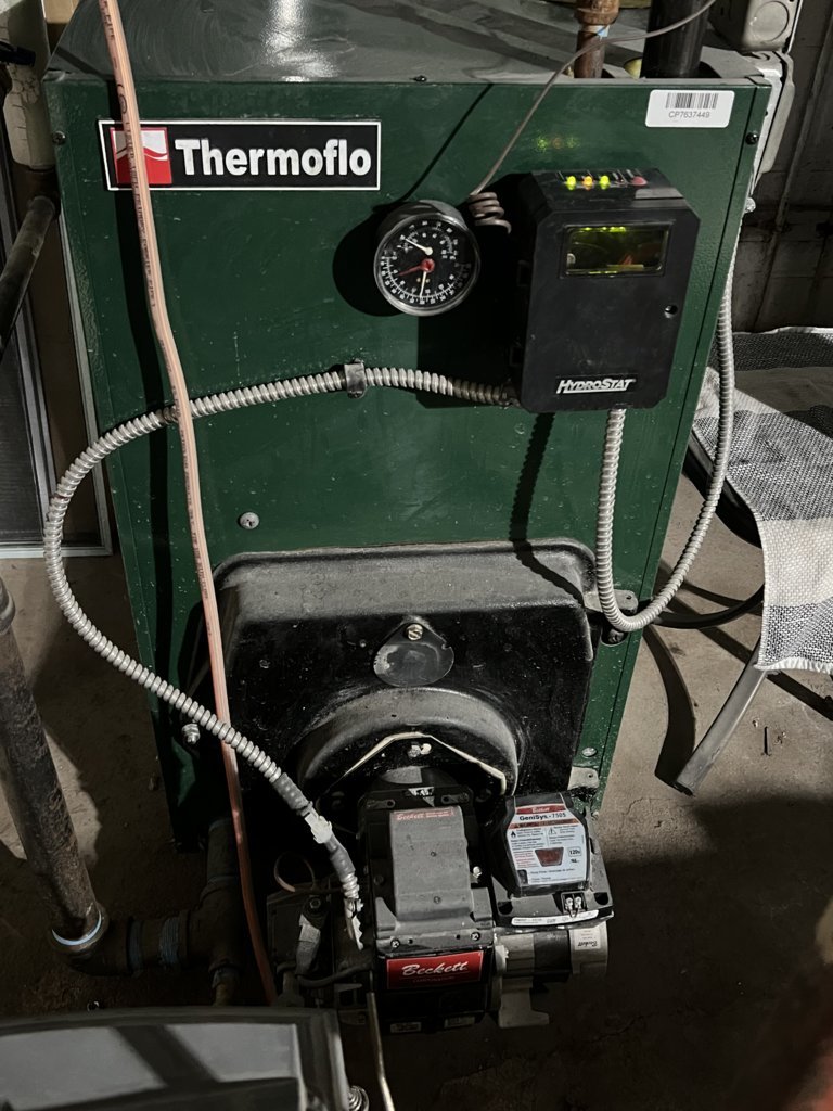

    As previously requested. I got home from our trip to Stowe and shot some photos of the “boiler room” we can call it. Let me know specifics you want/need for info.

    Nice looking equipment, newer than I expected. Is it heating better now?
    The boiler is a Williamson OWB series, manual here:
    https://www.williamson-thermoflo.co...24/08/OWB-OWT-Series-3-Boiler-Manual-0421.pdf

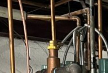

    Next, this:
    and this:
    are air catchers, there should be a little vent at the very top. They should work automatically however sometimes deposits jam them up. You should be able to remove a small cap and carefully press the core like a tire valve.
    As we discussed any air trapped in the system will reduce heat transfer/flow greatly.

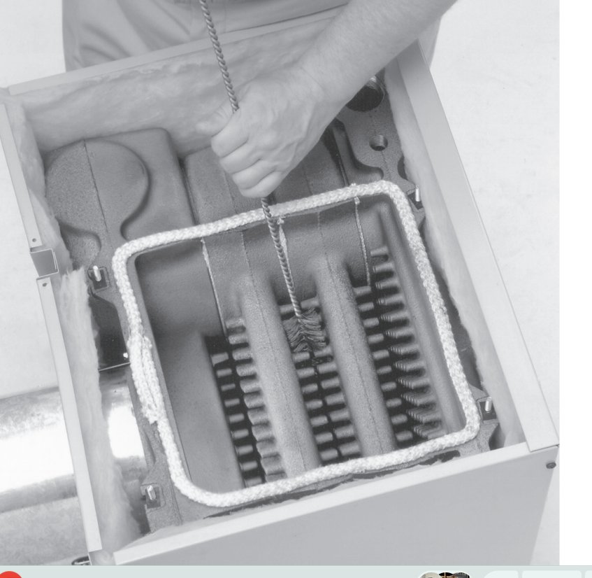

    Speaking of heat transfer, page 22 of the manual has this photo:
    Water is inside the cast iron sections and fire rises through the section where service man is shown using the cleaning brush. Those pins get soot build up in operation which slows the airflow through the boiler (bad, kind of like running your truck with a dirty air filter) and reduces heat transfer (also bad) heat transfer is what heats the water.
    This is where a good service man enters the picture, there are no short cuts cleaning an oil boiler, it is a dirty, nasty job that has to be done correctly for the unit to burn cleanly. I may have said it before, if your service man is done in a half hour you got the boiler equal of a "set the toe and go" alignment.

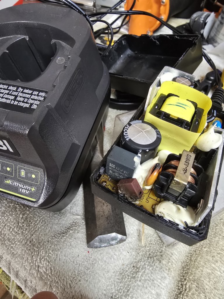

    So going back to the last hurricane in Tampa, Milton-2024, during this storm I lost a Ryobi charger, 18V. After looking it over as much as possible, considering repairing it, and found out it was the transformer that was bad not the charging base, so I finally bought a new one, and since I had that insurance of the new one then decided to open up this old busted one. So here it is, after giving it a little hammer and chisel, you can see the guts and the component that exploded. It's now in the trash, because those guts stunk!! Worse than a skunk really.
    New (charges both 40v and 18v batteries):
    Smelly guts:

    Really appreciate all the input and information. I love knowing more about the system of our house so thank you!
    It’s running much better but we are also seeing warmer weather here. When we get down to single digit weather is when the system really seems to struggle. I think the air made a huge difference that I couldn’t understand though, thanks to all who helped point out what a difference it would make. I still want to go register by register and deep clean, clear around them, good fitting caps, etc.
    I have replaced multiple things downstairs in the utility room and that small expansion tank is one of them! Just last year at the time of the boiler service we were having some issues and that tank was found to be bad. I opted to order and replace myself for 80ish bucks compared to the 600 dollars the HVAC company quoted haha. I’ll look at those vents, thank you! Smart to just replace them if they’re not working? I’ve found this water was harsh and without filters, probably had some sediment. As we “wake this system up” by living here per se, lots of small parts that are now running often have needed replacement. We’ve done two of the circulator pumps already since they’ve failed.
