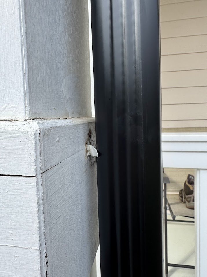

    Had my roof replaced last week, they did a good job. Roofing company has a contracted company to do the gutters. They came out today and replaced all the gutters and downspouts.
    GREAT JOB. HAHAHA
    (don't mind the rotted trim and all the color discrepancies, house is getting painted to match everything in a few months)

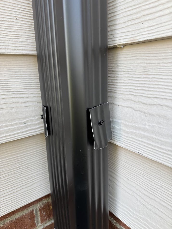

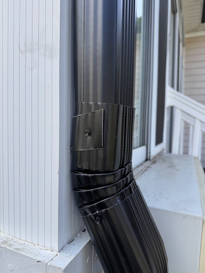

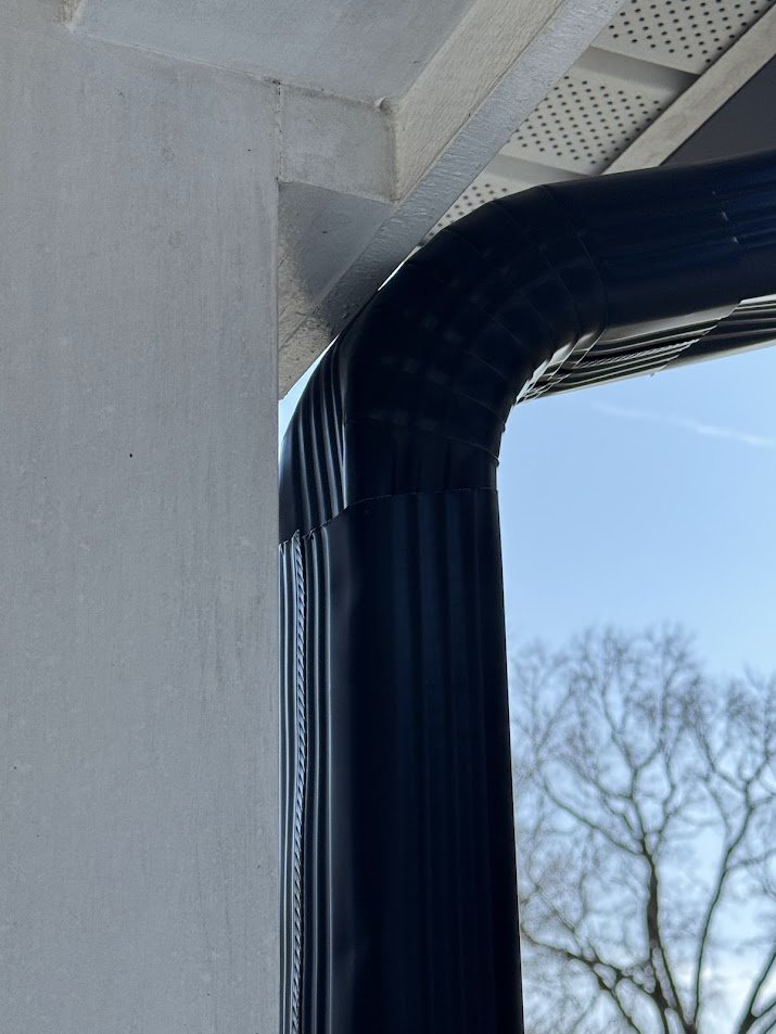

    The crew wasn’t even out of the neighborhood before I called. Lol. I could tell just by the looks of the crew I needed to inspect stuff. I don’t like inspecting any work with the contractor on site. I feel rushed. I miss things.
    My buddy runs the roofing company, I owe them a few grand still. I told them the gutter company is going to have to replace everything. If the downspouts are this terrible, I’ve found no less than 30 of these self tappers just in my driveway, every downspout is at a different height, multiple scratches on every downspout, the more I look the more shit I find. Never expected in a million years that a gutter install could be so fucked.

    Up until today I had no reason to ever ever look at a downspout or pay attention to how they were attached to a house. But I knew something was off with the crew. Took me about 3 seconds with a google search to realize they do in fact sell proper clips and straps to attach downspouts to the house with.
    The owner is coming out today so I will get to update you guys today as well with what they are going to do to rectify the situation.

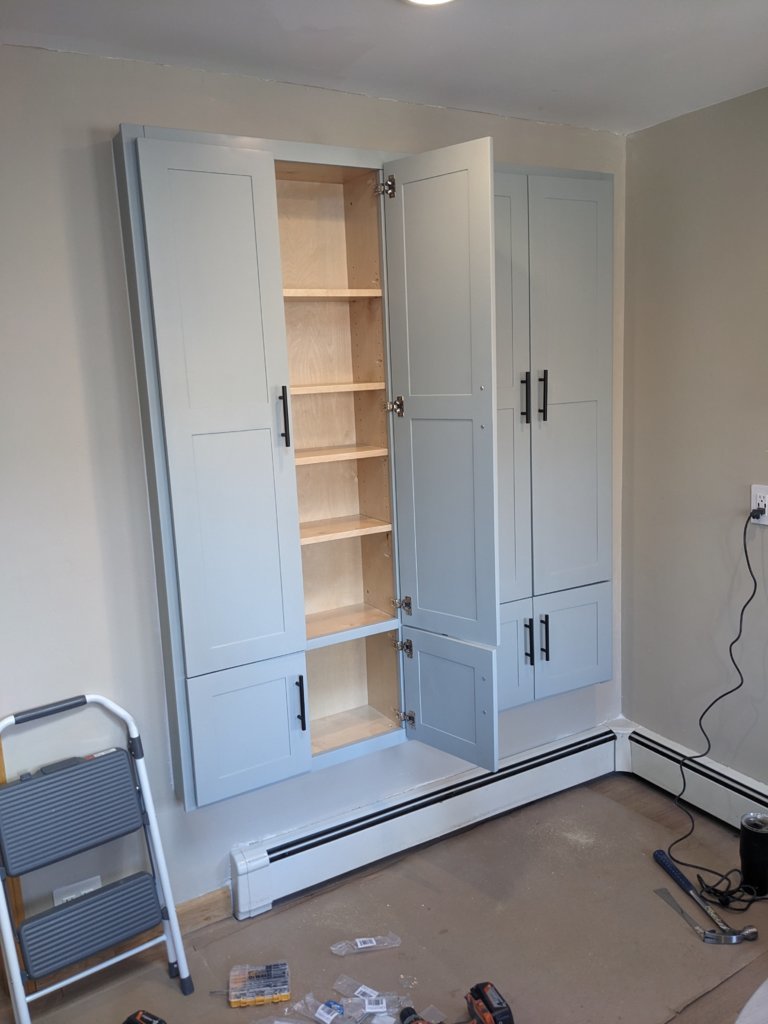

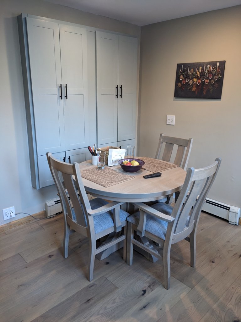

    After getting nearly all of our kitchen reno done in October...and then taking some time off for unexpected heart bypass surgery... finished the built in today. It backs up against the living room drywall.
    Did a header and removed two studs and sistered a middle one to have one shelf behind the double doors rather than two short ones

    very nice. Is it 2x4 or 2x6 framing in that wall?

    2 x 4, so shelf depth is 8"
    Did the doors so bottom of upper doors are 31" from the floor. That lets them swing open and clear 30" table

    I like the flooring too. Wood or tile?

    Wood...pecan
