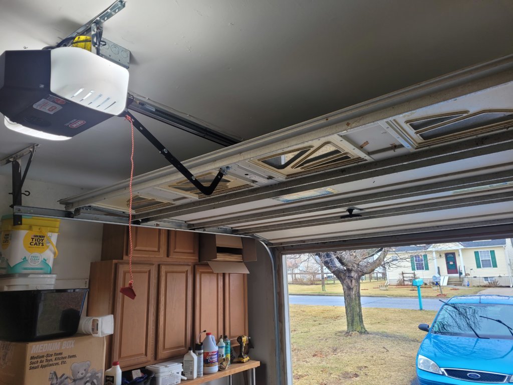

    I did my 1st garage door opener installation on Saturday. It wasn't too bad, the instructions were pretty good. (lots of diagrams instead of words) I had to reset the outside wireless keypad to get it to "sync" but outside of that, everything worked as it should. I did get a weird quirk- after testing a few up and down cycles to make sure that all of the remotes worked, it wouldn't open. I could hear a "click" but no movement or anything at all. I noticed a red LED on the power unit, a glance through the instructions had a troubleshooting chart, it said that the red LED indicated a thermal overload. After a short time the LED went green and it worked again. The trouble shooting chart was suggesting that the safety sensors could be out of alignment but offered no instructions on how to align them. I was thinking that I may have had the "close" position a wee bit too tight, so I reset the down limit and tried it a few times. It seemed to work at that time. Who knows, I will hear about it if it does it again.

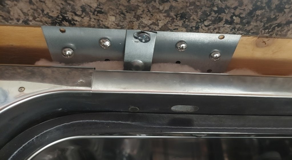

    So parents' dishwasher was tipping out do to the wood being torn up from to many removal and replacement cycles (flooring issue)
    2 mending plates and 8 #8-1/2" screws later (1 pate and 4 screws per side)
