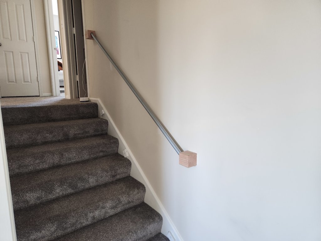

    Changed out our railing to match the rest of our house. Really wish i had a jig for angles vs freehand
