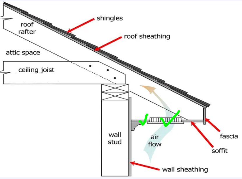

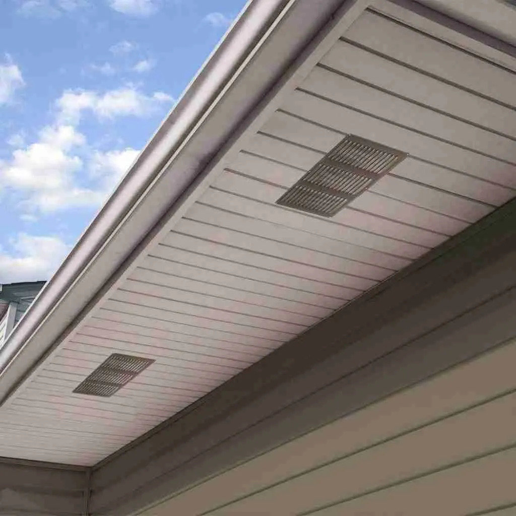

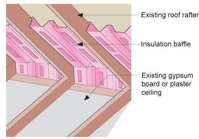

    Unfortuneately, previous owner painted the soffits and the vent holes are more than 75% covered. What a moron. What would anyone recommend, replace soffits, or, install soffit vents here and there? It's really hot in my attic and the AC runs quite a bit in the summer.

    There's a formula for determining how many intake and exhaust vents for your attic online somewhere. A roofing company would know. If it's not balanced you'll have issues.
    Soffits are installed from the inside of the attic, so unless you have a way to crawl up there...
    There's lots of companies that make solar attic fans and different types. There's lots of types of roof vents as well. Maybe contact a roofer and see what other type of intake vent they can install?

    You're thinking of the insulation baffles. Those still need a ventilated soffit to work. TE7216_BattInsulationAttic-2_BSC_09-10-2015_092115.jpg
    The soffit still needs to be ventilated for the baffles to work, but the baffles are only needed if the insulation is high enough to restrict airflow to the soffit.

    Yes, this is what is painted over on my home, and was thinking to either install vents as shown in that above pic, or replacing some sections of soffit which do have plenty of venting.

    I was thinking of a different type of soffit vent as shown below...
    This kind I believe you could pop the vents out and replace...

    Yes, mine are more like this, with punched deflections acting as venting, which are now painted over. :thumbsup:
