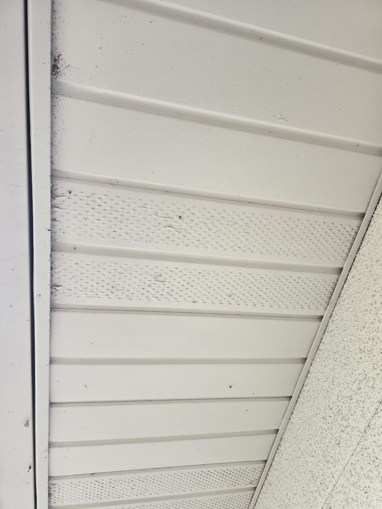

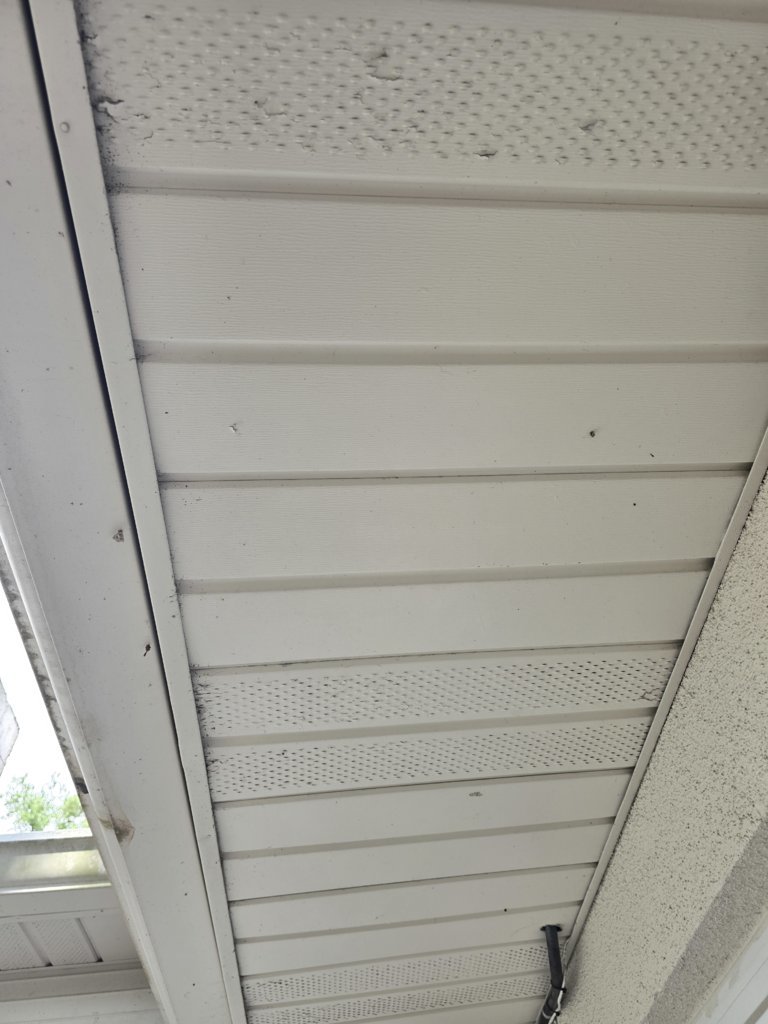

    Just like this.
    Am I screwed, or what?

    if it were me i would look at getting them replaced. at least all the ones that are plugged. or possibly take one off and soak it in a paint stripper to see if it can be saved. if it can then great. take them off as necessary and strip them then spray paint them *lightly*

    Replacement would be easiest.
    The best way to remove aluminum soffiting is to pull the aluminum facia away. But that's nailed through the soffiting.
    Normally pulling any part of it off results in wrinkling the aluminum like a pop can, so it'll never look the same once you fuss with it. It's not abnormal to redo the soffit, facia, and gutters at the same time

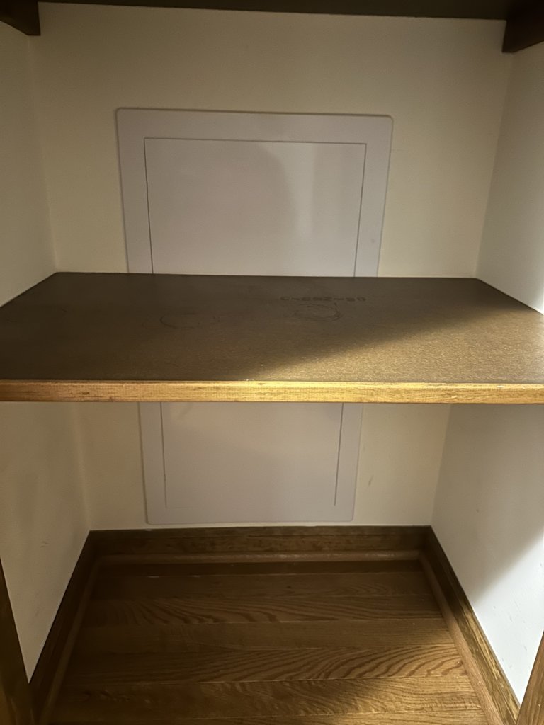

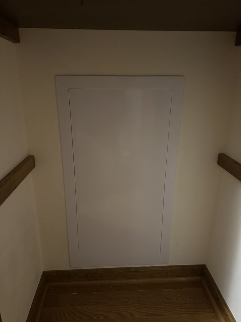

    Access panel arrived and I installed it. Height measurement was off about 1/2” so I had to cut more drywall. No biggie.
    Now it’s the wife’s turn

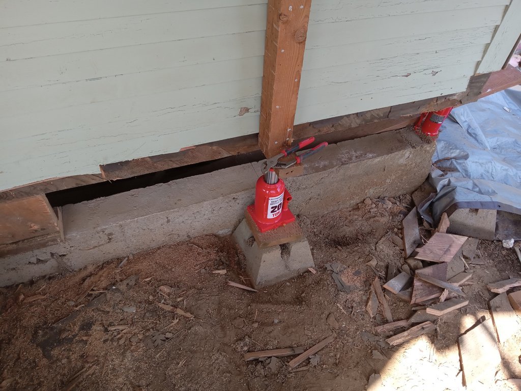

    Folks. Keep your gutters in good shape and don't let water run off your roof, onto your deck, and splash on the side of your house for years...

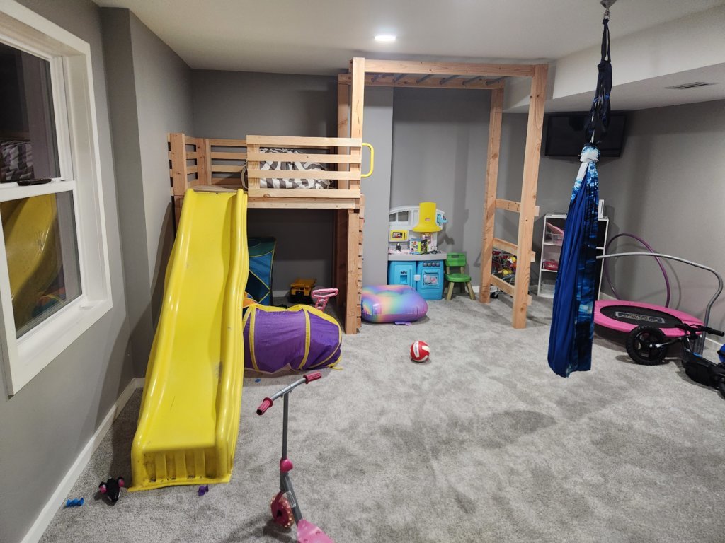

    Between staying up late figuring this out and then building it today and smoking some food i am exhausted. It was for my daughters fourth birthday
