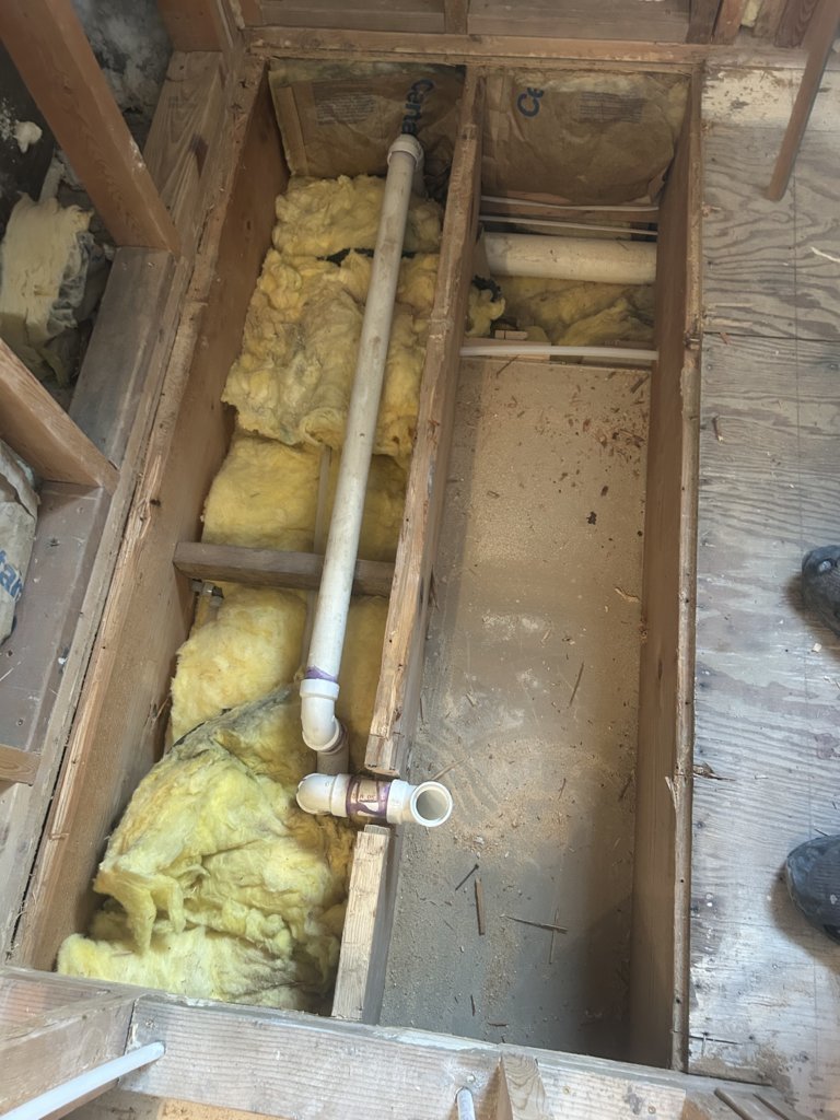

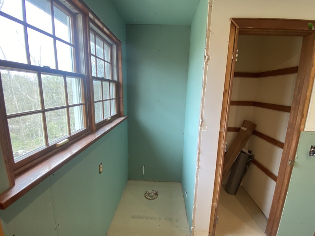

    IMG_8442.jpg IMG_8596.jpg I dismantled our master bath about 2-3 months back. I came down with some health issues and had to sub out the finish. It’s going well to this point…

    Looks like u did all the hard work (demo)! Tub or walk in ? Looks like 2 sinks ?

    It was originally 2 sinks but eliminated one
    Eliminated the one piece tub/shower and installing a shower only

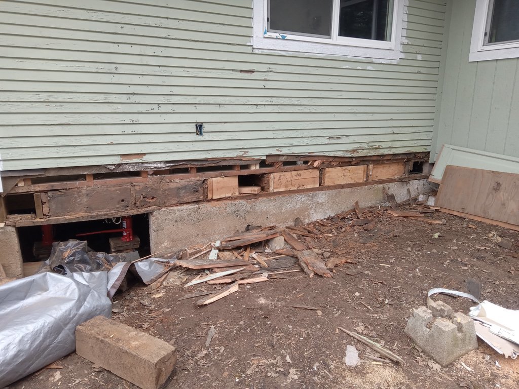

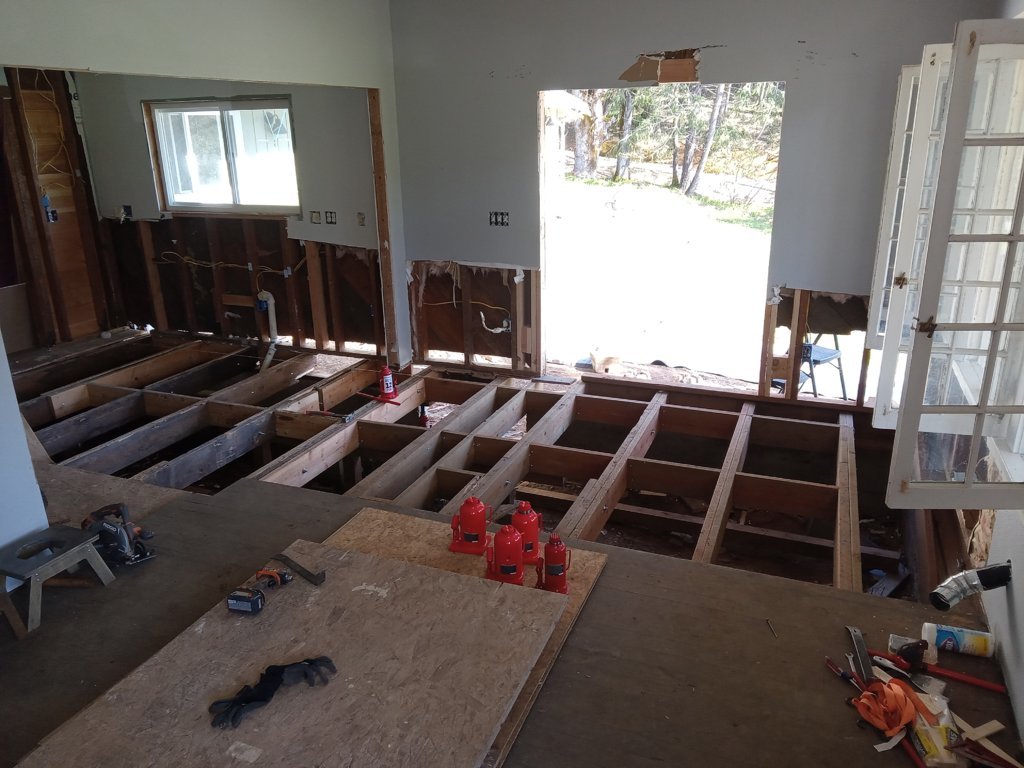

    I wish I could show as much progress as y'all do. Slowly working my way towards the back. All the untreated wood is getting replaced with treated. All the rotten sill plates and joists are getting replaced.
    Going to have to do some fancy fitting as I need to replace the bottom plates. I am not going to be able to lift the wall the 3/4" needed from the opening back, so I will have to support the studs on jacks and cut them to get the height needed. The addition was done and "repairs" made without properly repairing the problem, they added more untreated wood and continued building. PO cut out the bottom plate to add French doors, but didn't support the studs. That caused the bottom plate on the left in the inside picture to sag almost an inch below the one on the right (note, I've already replaced the one on the right).
    But, I'm at a standstill til Tuesday as I'm waiting for 10" long concrete wedge anchors to get delivered so I can bolt the sill plates (and therefore the walls) to the foundation.
    The supports for the floor are a bit scary (like 2x4s nailed together then stood on end scary), so I will be doing some digging and putting in poured in place piers.
    The front corner of the house is now level front to back and side to side to the joist at the edge of the new bottom plate.
