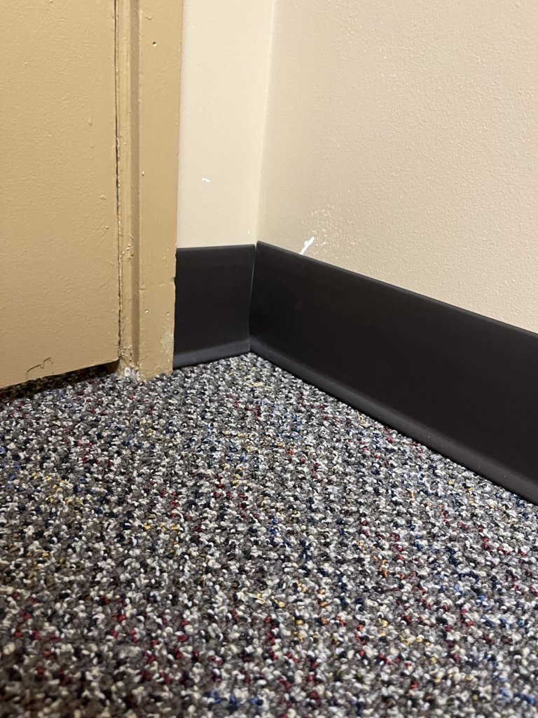

    Depends on the size of the gap between the wall and the flooring…but if you don’t want to take the time to cut/miter trim they sell a flexible rubber 1/4 round. With a little effort you could make it look okay but not great.

    Honestly, the product you have is probably the best choice with those angles. Get a fresh blade in a boxcutter and notch it as shown below. You should be able to manipulate it into place and make it look decent if your cuts are precise.

    it only looks like crap because they did a crappy install. slice it like MGMDT said and it'll look way better
    just to give you an idea that it can look good with what you have. Here is a pic from my office at work. This is still a mediocre job but looks good from far

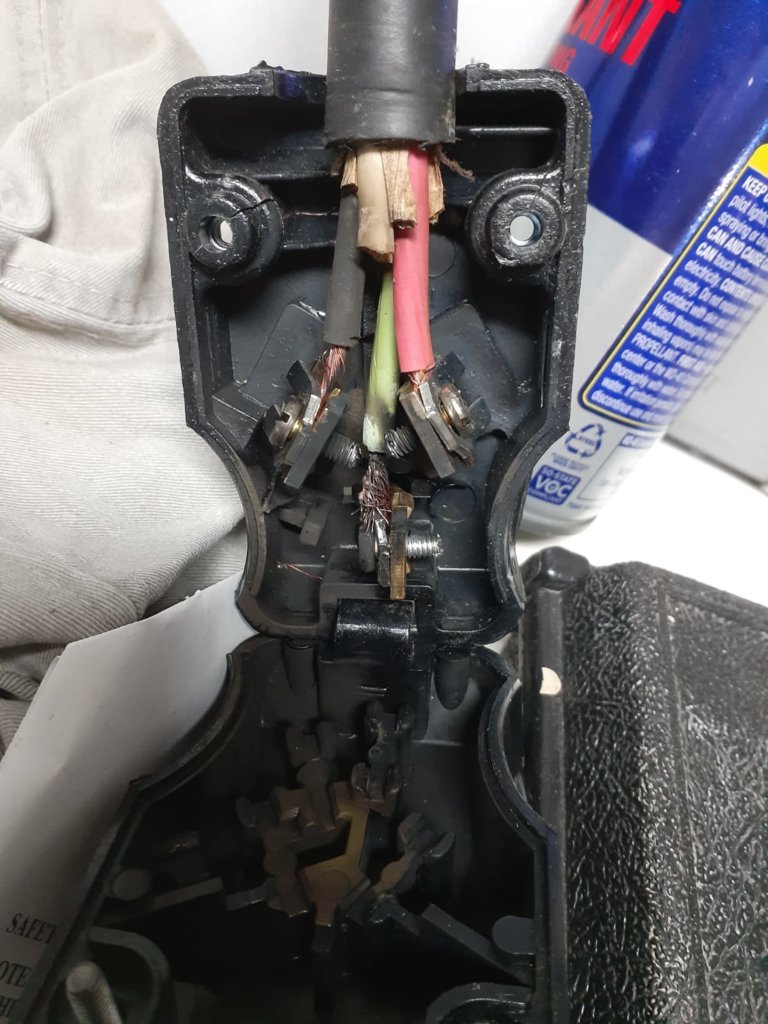

    I'll need to fix my compressor plug in the near future. Circuit breaker just tripped for some reason.
    shakerhood, Sig45, Kremtok and 3 others like this.

    That looks like a plug that is fixing itself really quickly

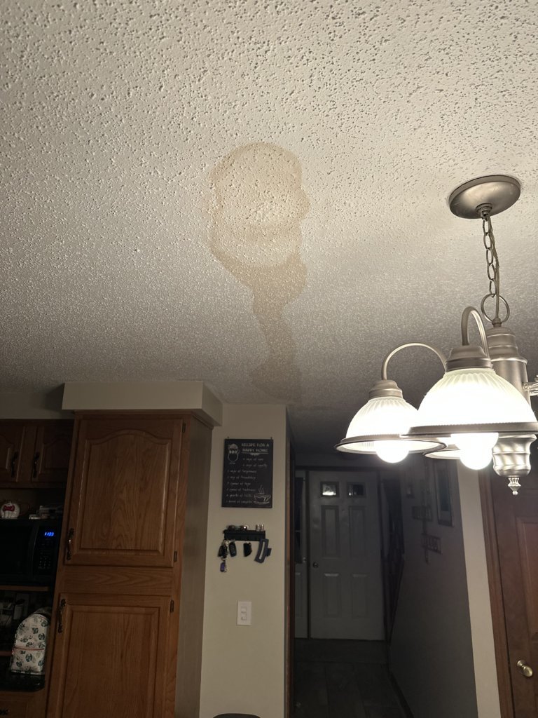

    Finally got around to painting the stain from the leak.

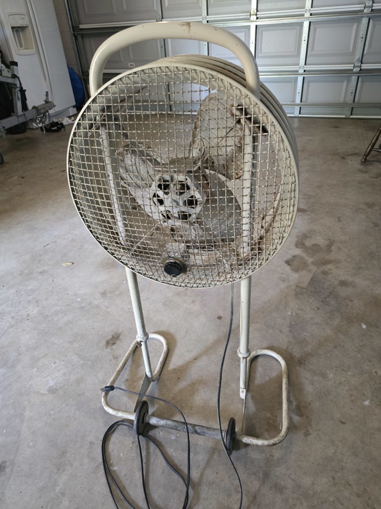

    Many fan motors have play like that, if it runs fine clean it up and leave it alone.
    If it has lube ports for the bushings use 20 grade non-detergent engine oil.
    Drainbung and thomasburk[QUOTED] like this.

    It only started making that noise, and play, within past year. It doesn't seem right, to me.
    I'll be looking into it today I'll see if I got a lube port to see if that helps.
    Drainbung and RustyGreen[QUOTED] like this.

    This looks to be a lube port, there should be another on the other end. Look behind there and see if there is a tube/passage down to the bushing housing. Usually the bushing is made of a sintered bronze "Oilite" material.
    There may be a spring washer in there that is supposed to control end play, sometimes you can match up a replacement at a well stocked Ace or True Value store.

    Thank you! Very helpful, I'll start with that when I dig into it after lunch.

    what is this fan on A/C Unit?

    Area fan.
