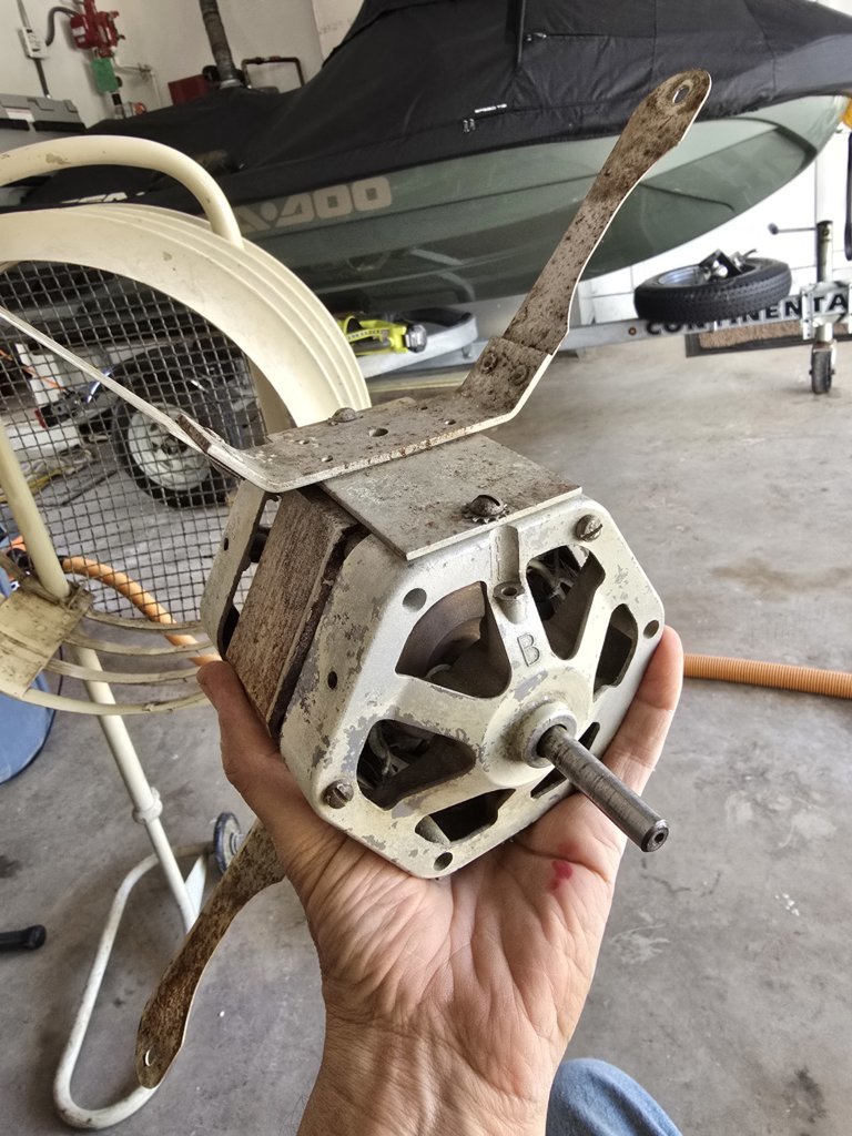

    Haha. Yeah I could use an upgrade.

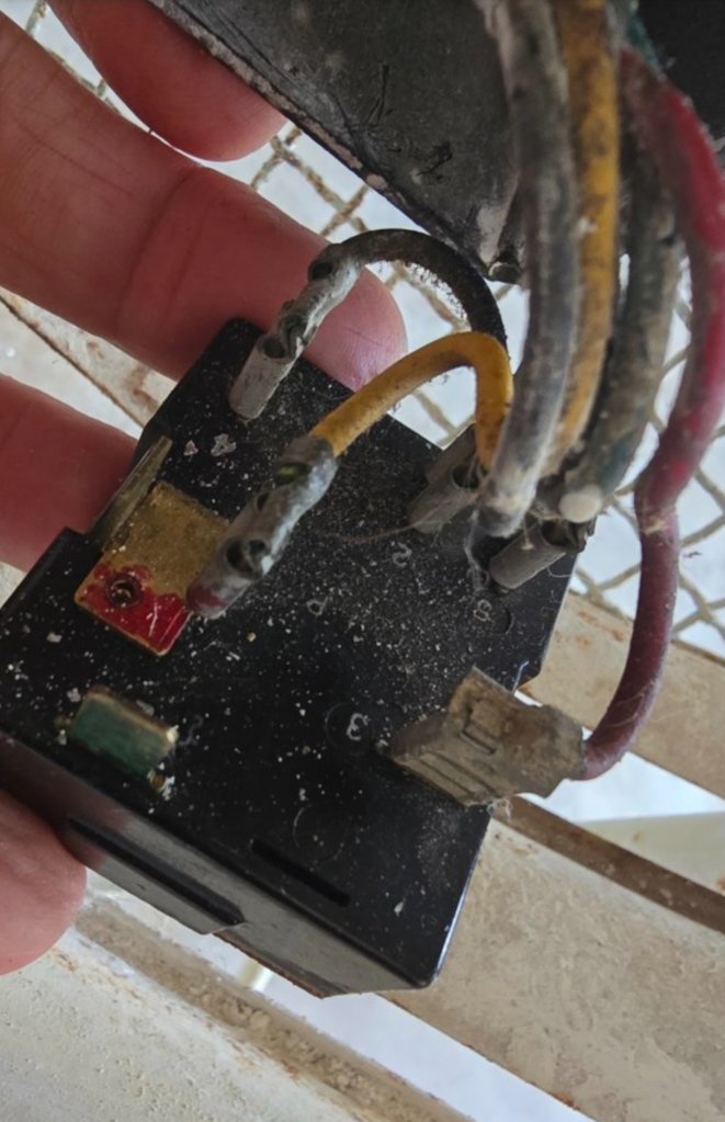

    Something about a project like this though. I feel like I owe it to the fan to get it tuned back up. I used it for removing drywall mud sanding dust from a project I had going on, and feel like I took advantage of it, against its will.
    By the way, looks like the noise was the fan hitting the motor housing, proper tightening of the Allen set screw will handle that. Thanks @RustyGreen your comments got me motivated to look into things further, otherwise I would still be looking at that thing wondering why I destroyed it. :)

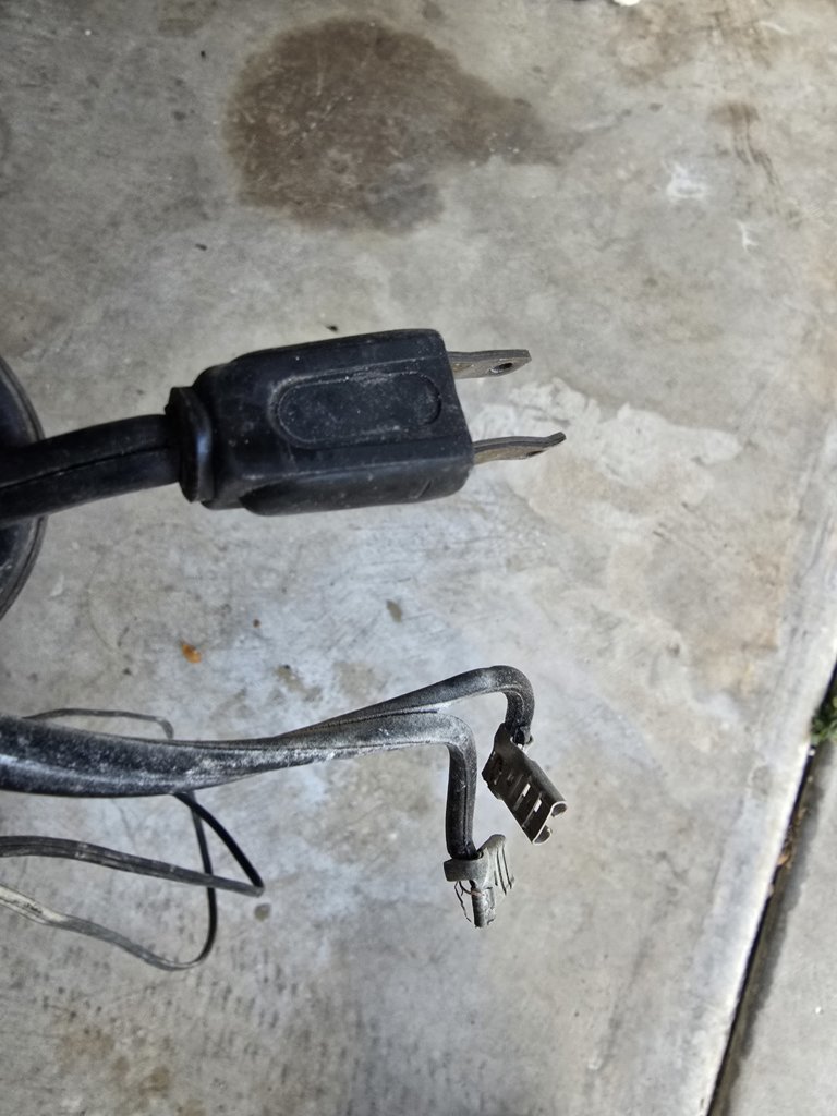

    So my question is, any suggestions on a replacement appliance electrical cord? This one got too hot at the plug during operation, I'm assuming it's a bad cord?

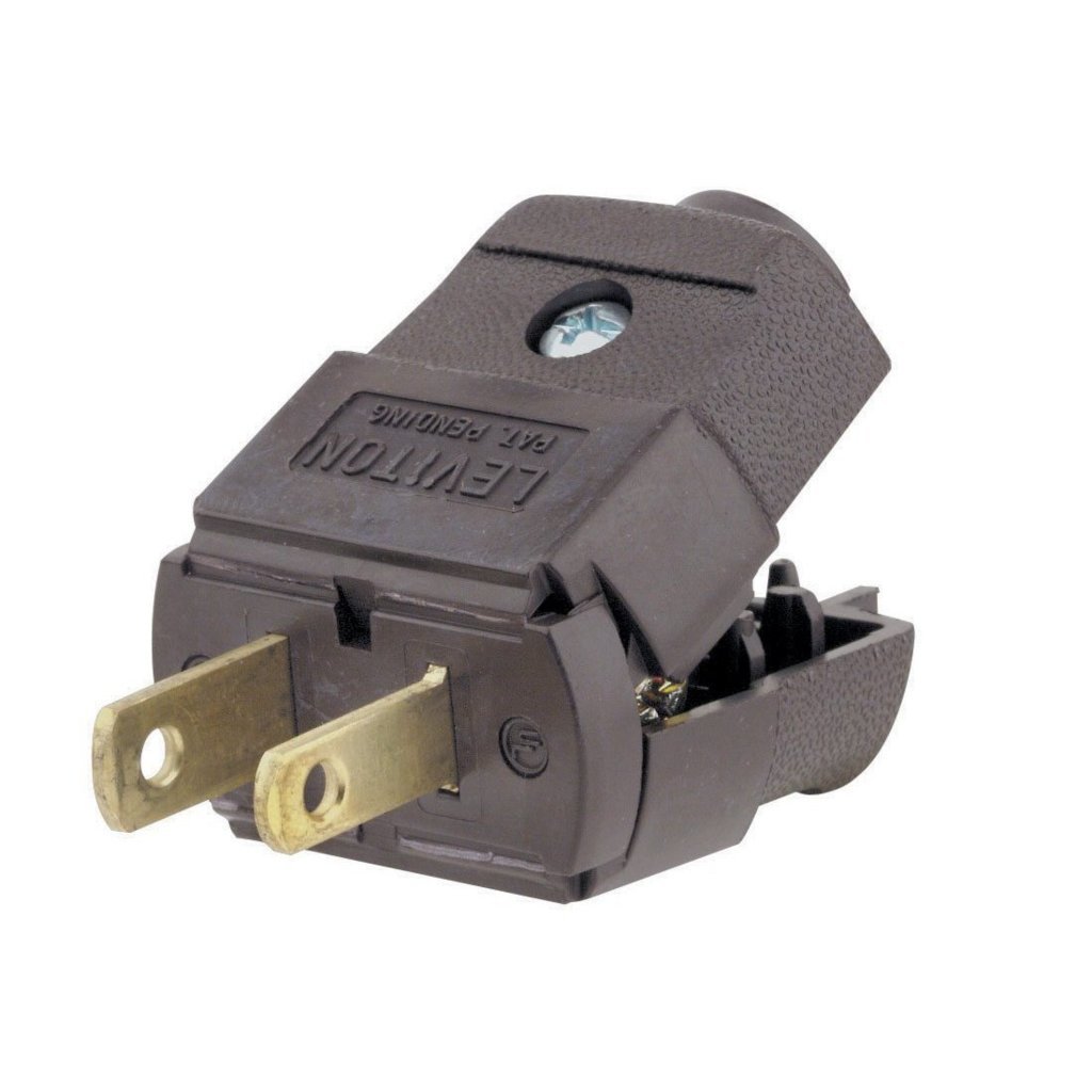

    Plugs getting too hot are usually due to a loose connection or broken wires right behind the plug.
    You can replace the cord end, make sure to observe proper polarity, the ribbed side of the cord is the neutral which goes to the silver terminal on the replacement plug, the prong will also be wider.
    Note the wider prong on the left, it is the neutral.
    You can also replace the cord entirely either using a rough service bulk cord of the proper gauge from a hardware store along with your replacement cord end or just buy an appropriate gauge extension cord and cut the female end off.

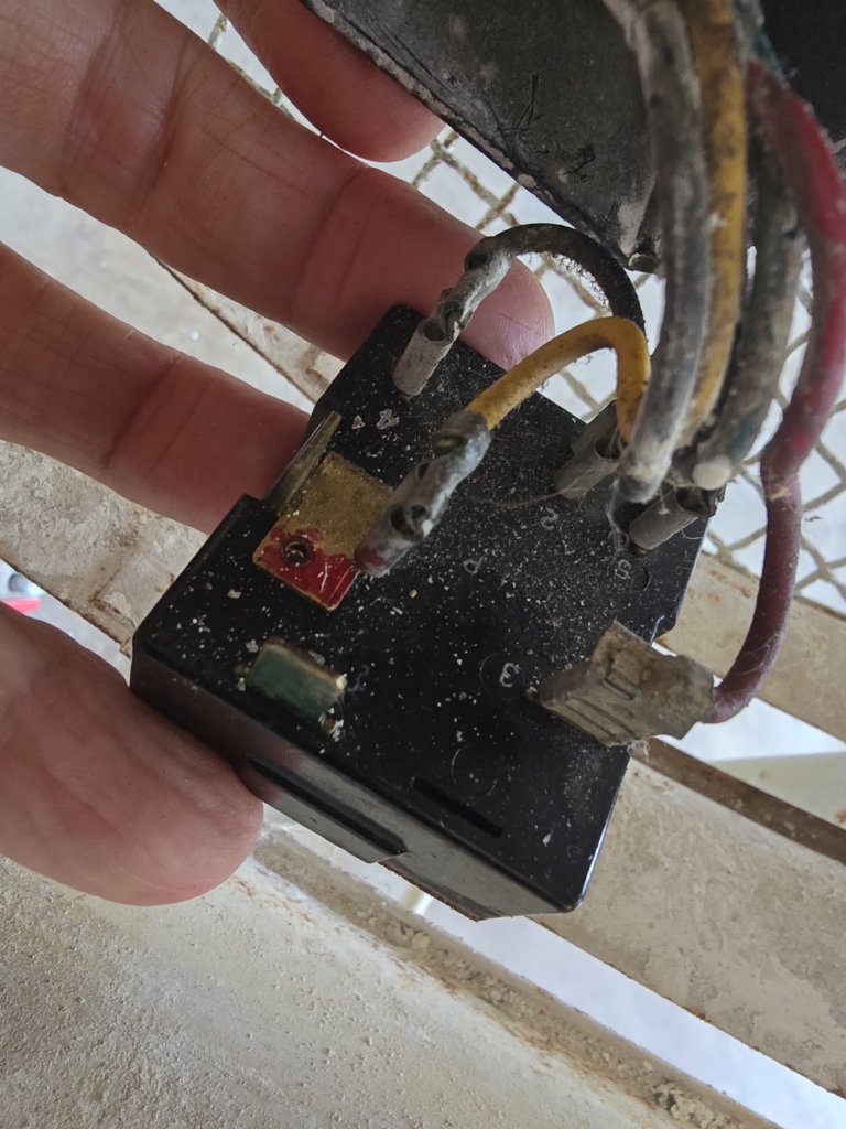

    I guess I could have just replaced the plug but decided to purchase the affixed plug and wire.
    Question becomes, is the wide blade wire supposed to connect to the red or green marked post in the pic of the speed switch? I think, wide blade to red post, you agree?
    The original plug that came off didn't have a wide blade plug.

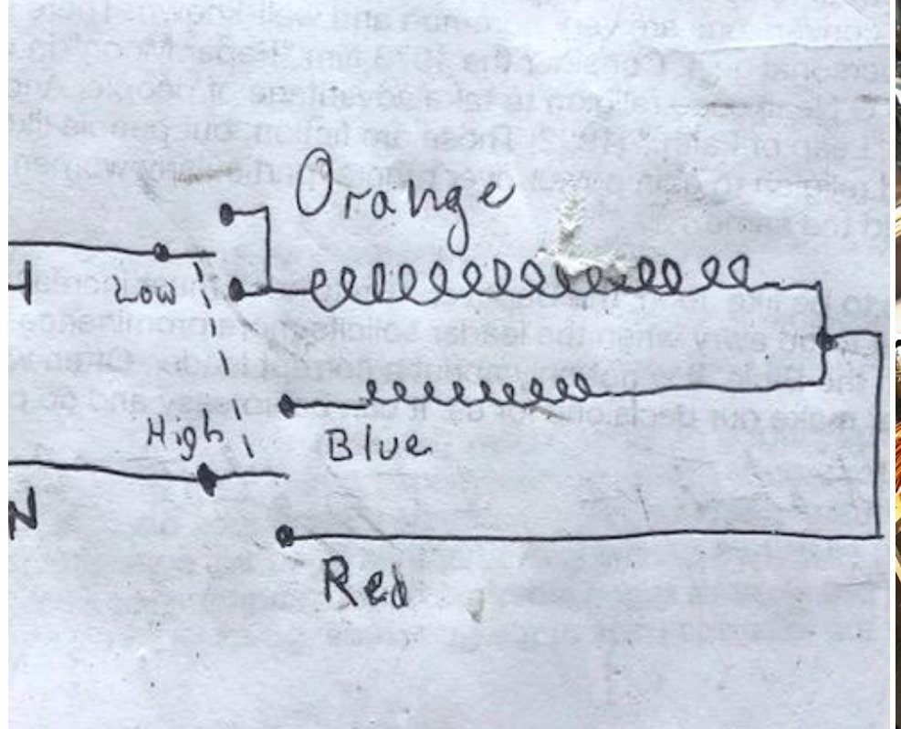

    Here is a wiring diagram for your 1954 or later Mobilair, what is labeled orange is the yellow wire.
    It looks like the hot wire would go the the red terminal.

    Wow that was an excellent find @RustyGreen ! I can see myself sitting down to rewind a fan in 15 years, or, I could send off to have it rewound. Thanks for that info, wow. Built in the 50's, and still running!

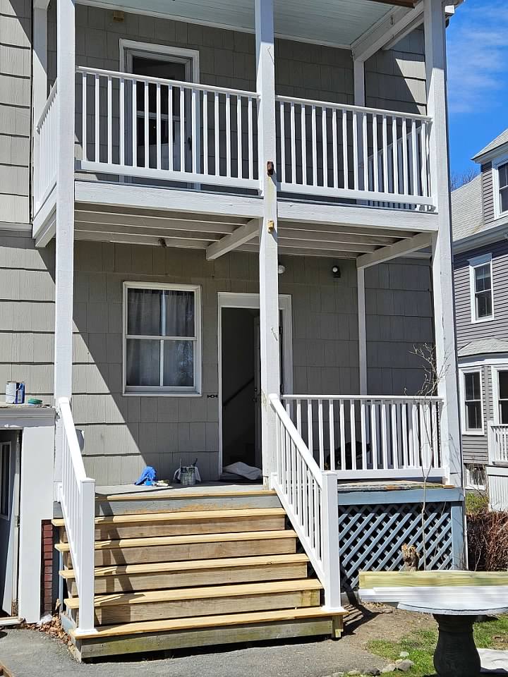

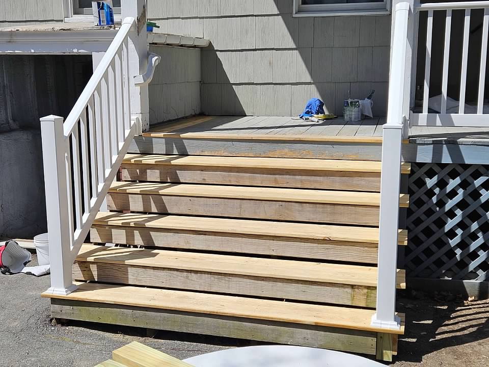

    Wrapped up my part today. New posts aligned perfectly with the 6x6 posts on the porch and the tread reveal on the outside of the stair railings is 3" on both sides. Sweet! Nice when things come together as expected/planned. My customer is thrilled. Painters were there doing the upper porch and back stairwell.

    Mission complete. Reconditioned to my liking. Power cord replaced, power washed, neoprene washers replaced, oiled, switch mount screws replaced, switch rotated 180° to correct reading of switch, primed and painted. Currently in service.
