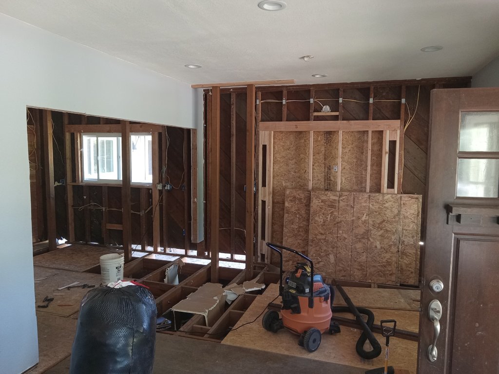

    All floor joists and sill plate in the dining and kitchen areas replaced. I was going to install the new base plate, but when I was measuring to cut the studs, I found the studs had more rot than I liked. So, I have a stack of new PT 2x4s that I will install tomorrow. I'm going to take out where the PO framed out for a French door and just put in full length studs. I'm also taking the window out to make it a solid wall. Once the layout of the kitchen and dining areas is finalized, I'll cut and frame out the wall for windows.
    4x4s are sitting on top of 20k jacks which will hold the roof up when I cut out the wall components.

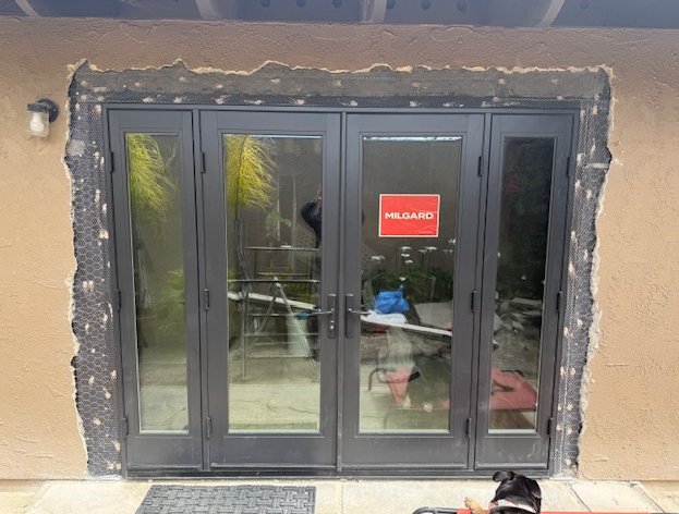

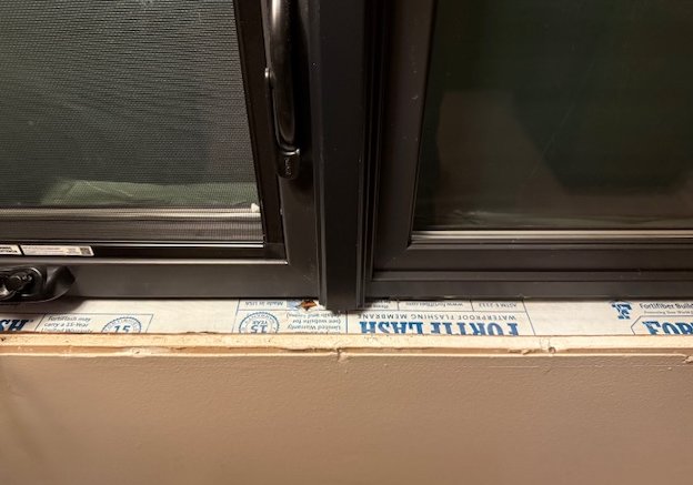

    Went with Milgard Fiberglass casement windows and so far (1 wk) we are happy with them. I'm looking to finish off the interior and was thinking to do tear-away edge bead and trimless drywall. Tear-away edge bead would work on this bottom sill except where the vertical is proud by 3/4" as part of the style apparently. Has anybody done a modern finish off of casement windows? I am thinking to just use blue tape instead of tear-away bead where the vertical abuts the sill, but suspect that will leave a bit of imperfection which stands out. Thanks if any ideas. I guess you could make a 1/2" thick sill and cutout around the vertical with a precision saw but that seems like an inefficient route. Also posted below is the 8' slider replacement, the side vents are perfect inbuilt dog doors.

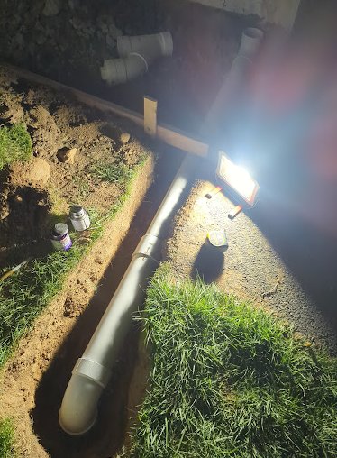

    Sorting out some odds and ends in hopes to sell down the line, so had our side and front walks redone in just poured concrete (prior owners didn't pitch it, front was deterioriating, etc.)
    There was a drain for a leader over by the garage that was clogged and deteriorating underneath so I redid it in DWV PVC 4" and installed a cleanout the night before the AM pour the next day. Garage light came in handy with this one, nothing flashy, nothing exciting, but needed to be done.

    That looks like our pipe. Silverline

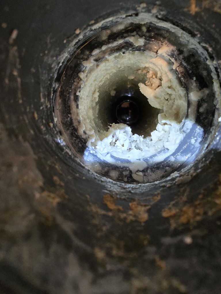

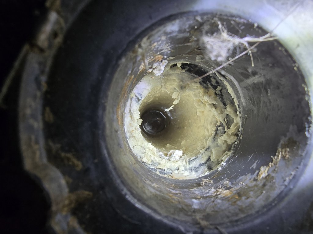

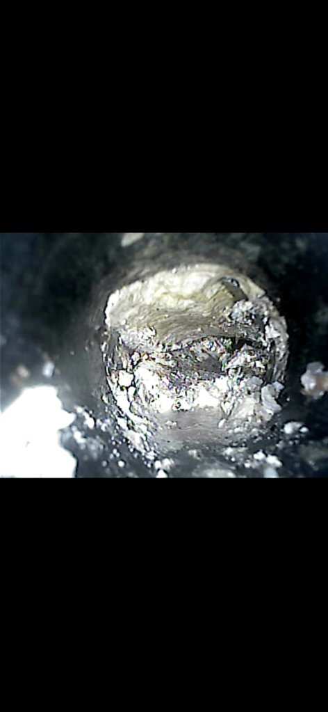

    Any plumbers can give me an idea what is this scale growing in my drain? Feels like calcium, coats the vertical drain to water level then clogs at water level. Grows pretty fast, cleaned out about 4 months ago then here again a few days ago. Seems to start from weep holes from around shower pan under tiles...
    Could be caused from calcium lime rust spray in shower? From mold mildew soap scum spray?
    Certainly not from water sediment, right? My other drains aren't looking like this.

    @ralfnjan, Haha, I was like that, the first time I noticed/cleaned out this drain. Now it's different, hehe, this stuff is friendlier than your regular, everyday, normal, waste-drain-pipe black-scum build-up.:eek:
    @Drainbung, this isn't a commode waste-line.:rofl: But looks pretty much like it I will agree.
    @MGMDesertTaco, it's getting to the point, where this is a possible next step. I have felt it, seems gritty...
    @Sig45 It might be, I will report, once known.:eek:

    Not a plumber but I'd bet you money it's Hair Conditioner.

    I don't use conditioner, no women in my shower. :facepalm:
