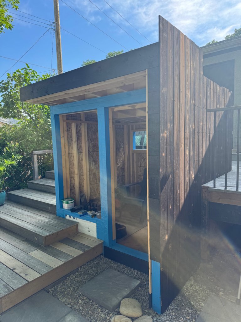

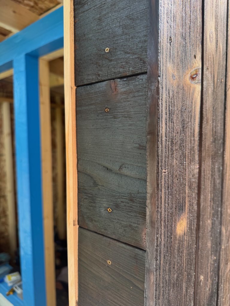

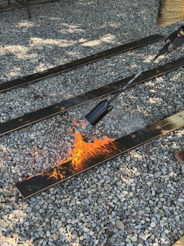

    Next up on the sauna will be closing up the exterior. Choosing to do the traditional Japanese method of Shou Sugi Ban to protect the wood without stain. Just burn the shit out of it!!
    Cedar ship lap + torch = fun and smells great!

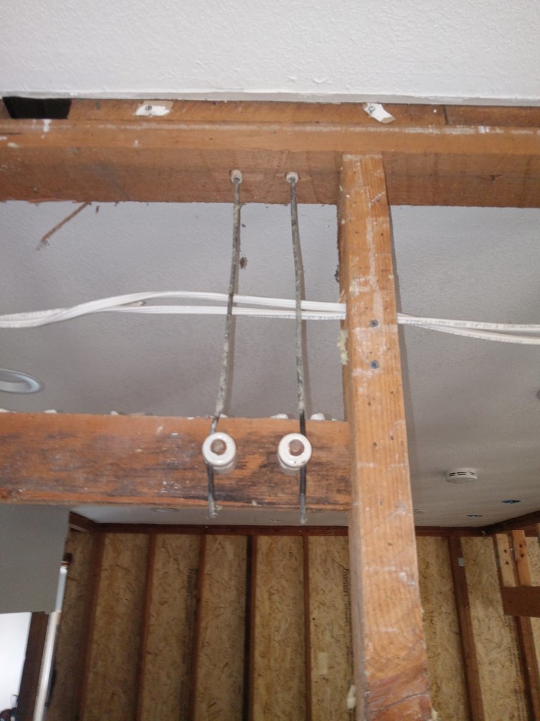

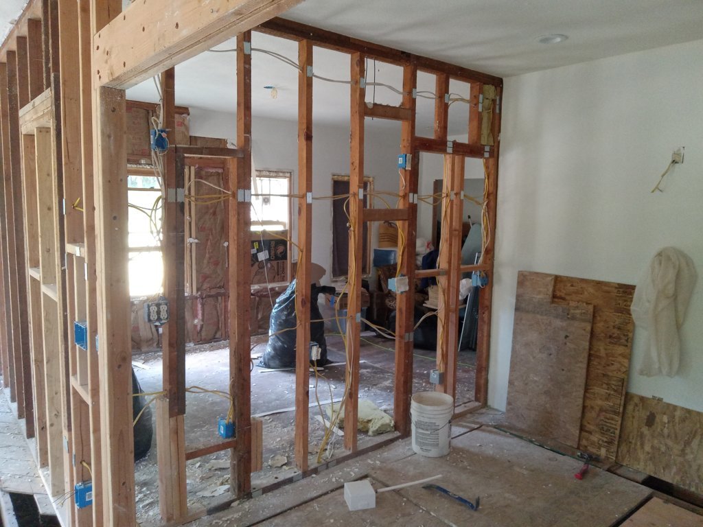

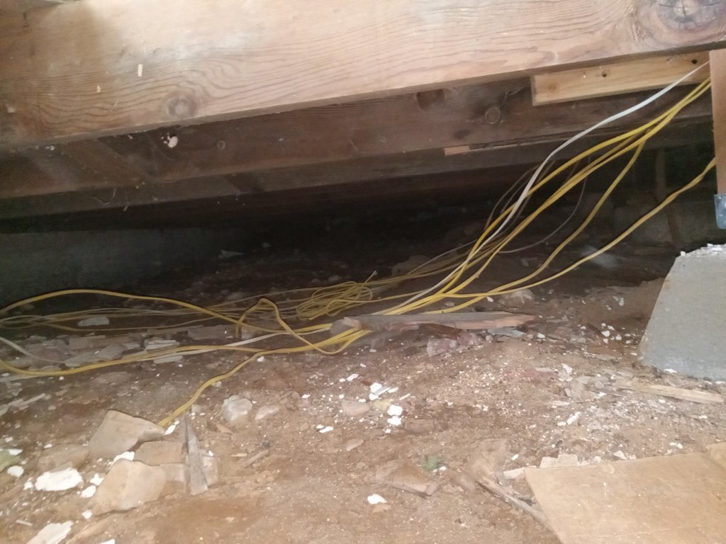

    Pulling walls apart and removing wiring.
    Yes, it was live.

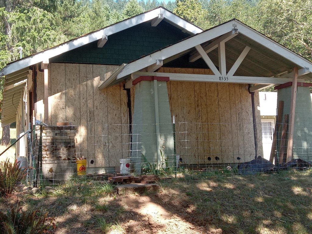

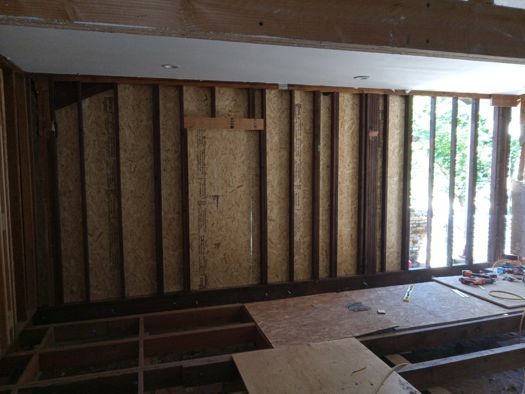

    Wall 2 got rebuilt yesterday. Took out the 2 big windows and shifted the door opening over to a better suited place that will give more room in the living room area instead of being centered on the wall.
    There is a total of eight 6x6s extending through the wall to support the roof and porch roof. NONE of them were properly installed. The 3 that go into the wall of the living room had limited support with one only being held up by the wall sheathing and one horizontal 2x4 with 2 nails and one having been cut down to only 1x6 in the wall... This explains why they were all sagging, with the left corner having 7" of sag. They are now heavily supported on the tail and will be getting corbels.
    The three that are above the ceiling will be getting replaced entirely as they only extend about a foot in and need to have 8ft in with 2ft out. But, I'll do that when I rebuild the roof which currently has 7/16" sheathing and does have any connections between the rafters and ceiling joists. Probably going to build trusses (most rafters have rot and cracks), and sheath it with 3/4".
    Today, I'm doing some concrete work and starting on wall 3. With the fireplace/chimney falling off, it opened up the option to put a 5ft glass door where the fireplace was to allow more light and a better view. Now, the main view for the living and dining areas will be the yard and woods instead of the driveways.

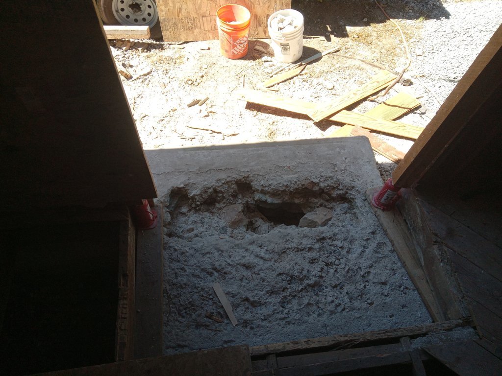

    This was under the fireplace, it was loose enough to clear out by hand. Going to smooth the top then fill the hole before doing th sill plate for this 16ft section of the wall.

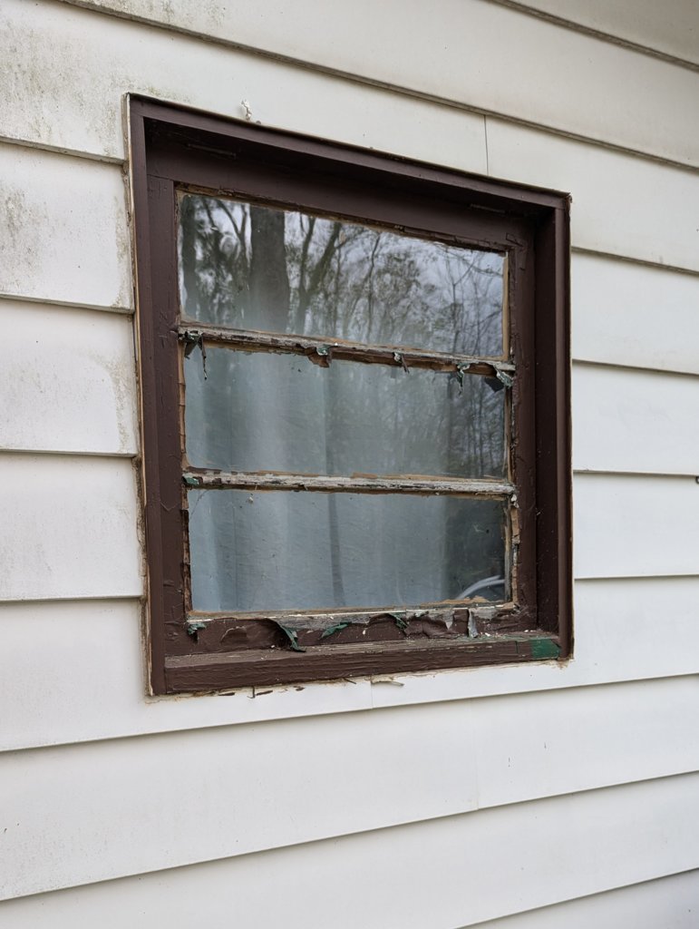

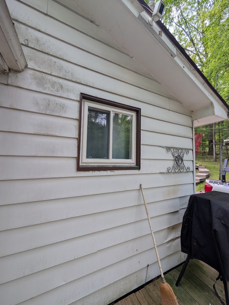

    At camp recently - replaced 7 of 10 total windows so far. Old ones are all single pane, wood frames that my dad got (probably for free) back in the early 60's. New replacement ones are double pane vinyl sliders - except the 3 large picture windows that don't open (still need installed). Did several of the smaller ones myself. Neighbor helped on 4 so far.
