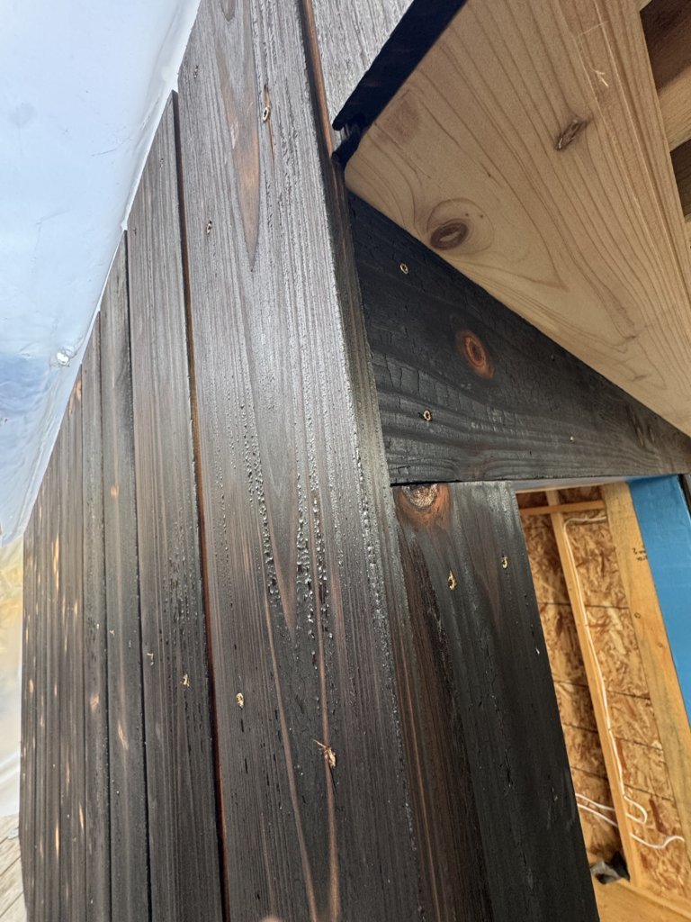

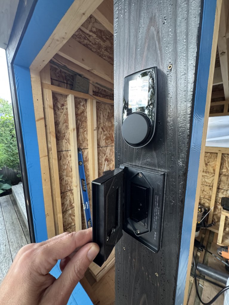

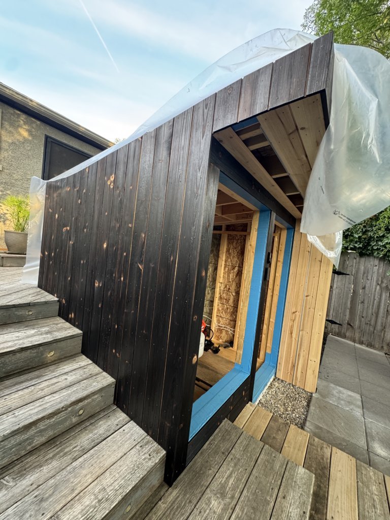

    Progress on the sauna. Exterior burning going well! Control module in, and dimmer for COB lighting. You can’t have a light switch inside sauna and I’ve never seen an outdoor dimmer setup… this was my only idea… thoughts? IMG_5978.jpg IMG_5979.jpg IMG_5980.jpg

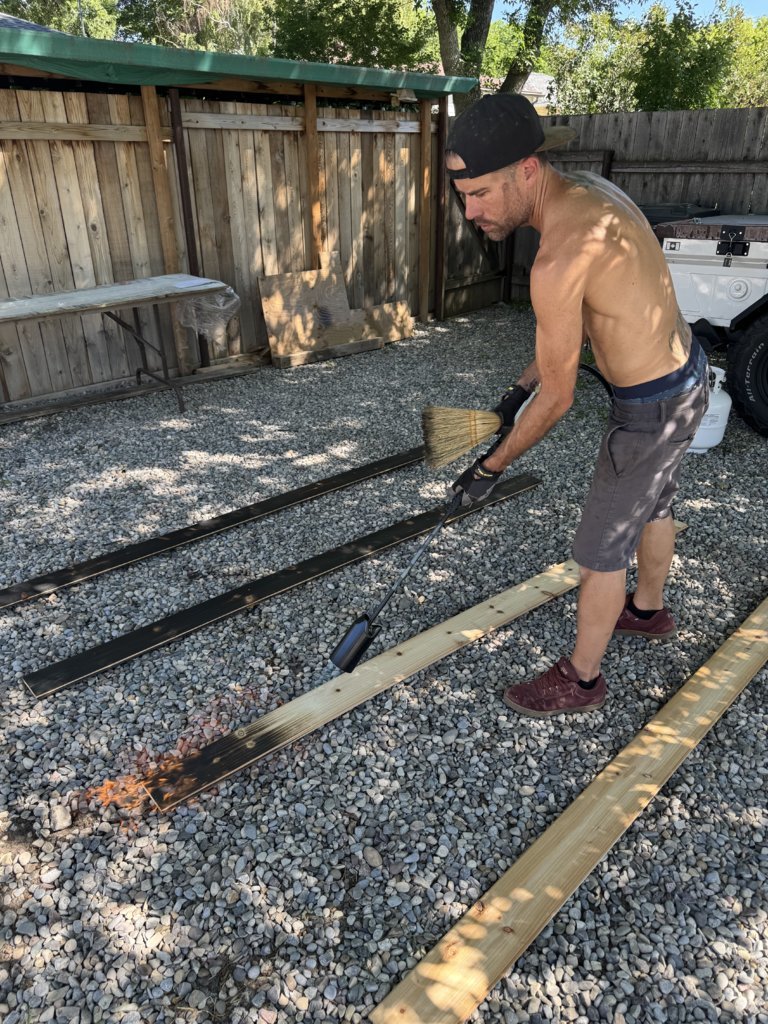

    Wow nice even burning. How did you do that?
    I'm okay with the switch there.

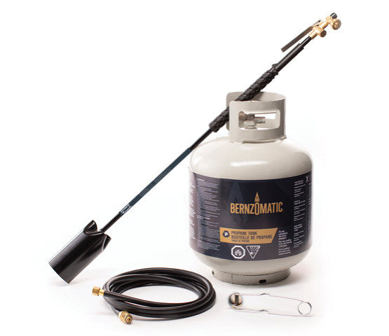

    When you say you're ok with the switch location and method, you're reassuring me cause you're an electrician?? Please say yes.. LOL
    I do have help electric wise from my electrician cousin and friend, they have yet to approve this... lol

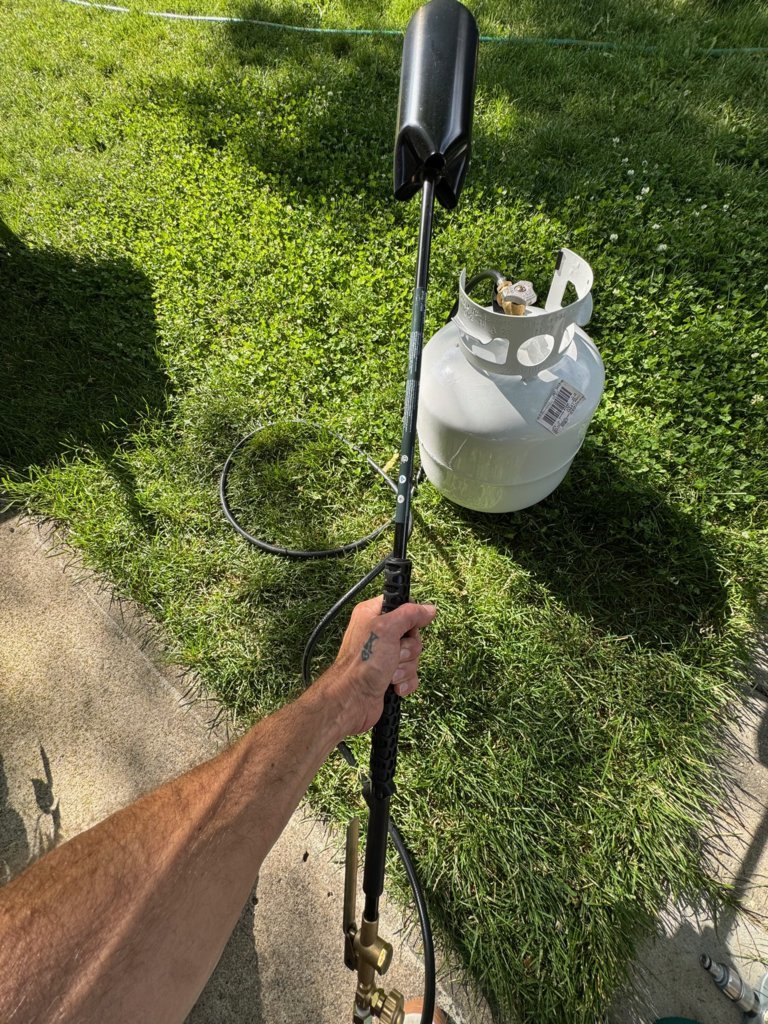

    One of these, SO FUN!

    Very nice effect and looks great.
    I'm not an electrician, and I'm unfamiliar with codes, sorry for any misrepresentation. It just seems logical to put in that location, slightly open door, reach around, reset temp/light... sit back down for another 20 minutes of heated steamy bliss.

    HAHA much appreciated, it's fun, fast and non-toxic.. My cousin just approved, and yes, only logical location..

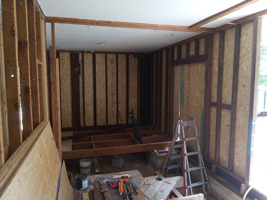

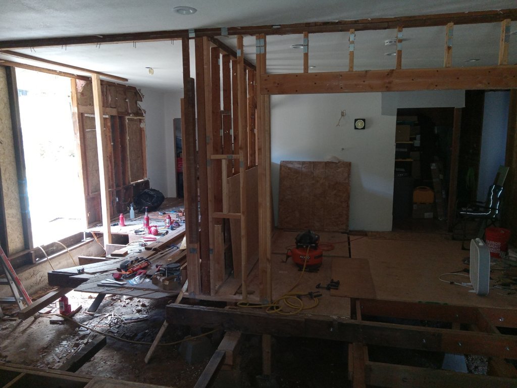

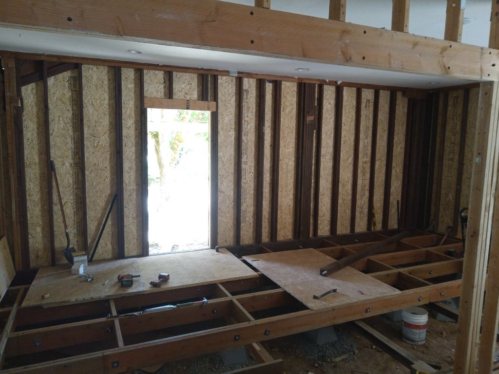

    Building a new house, one board at a time.
    Decided that the floor joists were just too far gone to leave, so ripped out everything and did all new. Tomorrow, taking out the kitchen/bedroom wall and floor to access to old joists for replacement and moving the wall to make the bedroom shorter but fatter.
    The stud stacks are to hold up the porch roof and the house roof. Previously, it had so little support, it was heavily sagging. With the stacks, it provides support and enough meat to put in corbels. I actually lifted the roof line 3 inches in the right corner in the picture, that's how rotten an unsupported it was.
    Edit: French doors will be going where the fireplace is to be and the new H.E. wood burning stove will be going against the wall between where the kitchen will be and the living room.

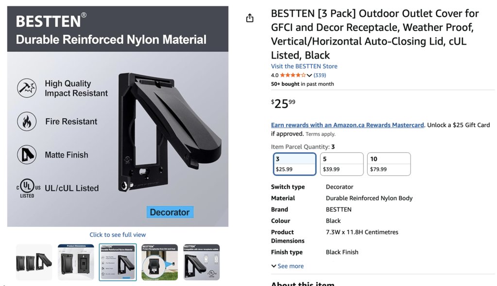

    The sideways cover is not compliant. It needs to be a vertically opening cover so that the top and sides are sealed(not the bottom, so any water that does enter has an escape path). also needs to be gfi protected.
    if you're planning on this being a rental, i would also avoid the direct dimmer setup. more things for people to fuss with, and at lower lighting levels, increased fall/trip liabilities for you as the landlord. far better to have an on/off switch go to the led driver, and then add an inline low voltage dimmer by the driver to dial in the level of lighting you want people to have.
    i would suggest either of these. the decora style is newer, so i'm not entirely familiar with it's outdoor survivabillity, but it does look a lot nicer.
    https://www.homedepot.com/p/Commerc...hoppingads&locale=en-US&gStoreCode=1937&gQT=1
    i've used thousands of these. the big advantage is that it's entirely pvc components, so there's nothing to corrode or rot on the outside of it. dis advantage is that the screw placement is very specific to outdoor-rated pvc or metal boxes.
    https://www.amazon.com/Hubbell-Bell-PTC100GY-Weatherproof-Vertical-Nonmetallic/dp/B002MYF1GA
    these are my least-favorite outside switch. it's all metal, so it corrodes. it's also a really big pain to set up with the switch spacing to get the right amount of movement.
    https://www.amazon.com/Hubbell-Bell-5121-5-Gang-Switch-Cover/dp/B00004WZ2R

    Thanks for the input. Ive already explored all the ugly, NON dimming options... And no, not a rental anytime soon. I'll explore the vertical opening lid but didn't see an option anywhere. Also, the inline driver with dimmer for the COB light setup was a no because I don't want a remote in the sauna to control lights... The lighting I have purchased is 120V system without the need for a driver, hardwired direct to the switch. I live in a desert and the switch is well covered by the big overhang. Guess we will see..... Thank you!!
    Ordering up one of these tanks.

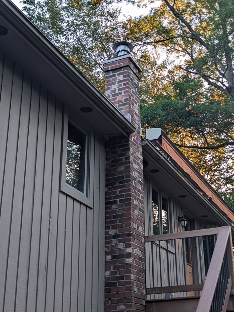

    Don't know much about masonry so only wrote the check.....
    Full demo and rebuild with clay liner and double wall stainless steel liner.
    $11.5K...other estimate was $19.5K
    I'm in Connecticut as a cost reference
