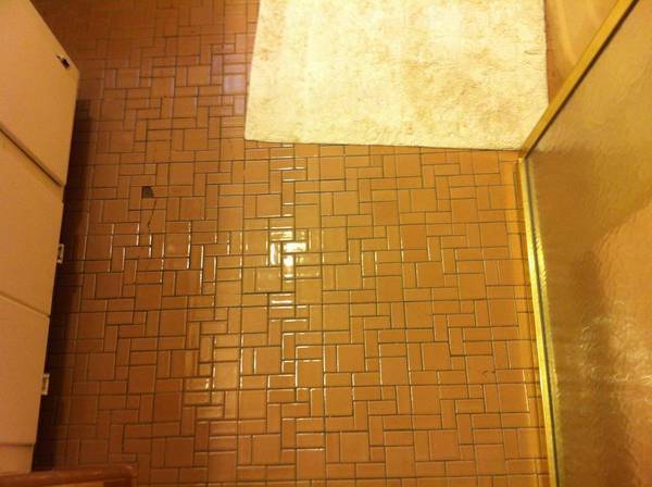

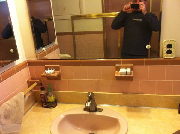

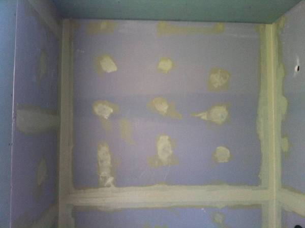

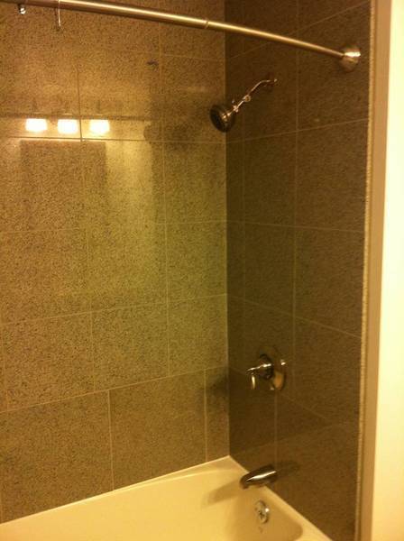

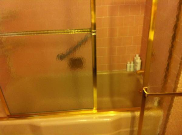

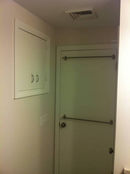

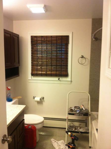

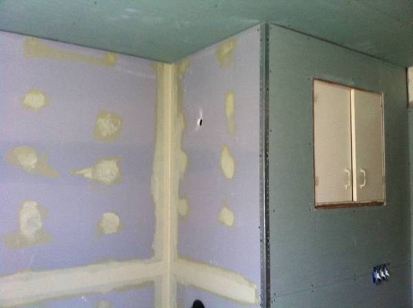

    Ok, here are some before and after pics of the bathroom I just remodeled. As you can see it started as a lovely 50's shade of pink and yellow.
    I gutted everything, and I mean everything. New insulation, sheet rock, ceiling, tub, vanity, subfloor, plumbing. The only thing that didn't change is the toilet, luckily the previous owners installed a Toto.
    It took a couple months, but I had took some vacation and I occasionally have to travel for work. I am very please the way everything turned out. The only thing I didnt do was the tub and mixing valve which I had a plumber install, and the installation of the tile. My dad, who is a stone mason installed the tile while I made all the cuts and I grouted it in the next day.
    Vanity before
    Shower before
    Floor before

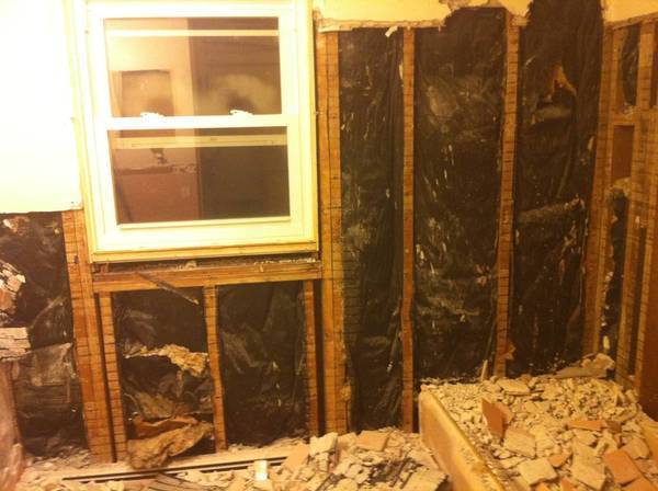

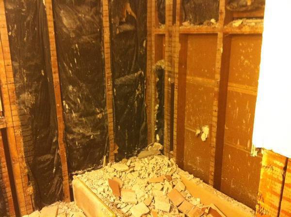

    Shower during demo, which if you can tell the old tile wall was a mud job and a MF’er to remove!

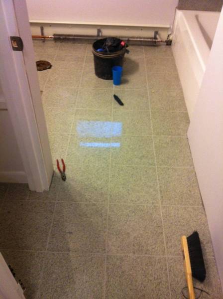

    Floor after
    Shower After

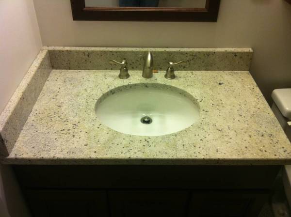

    Granite counter during polishing
    Granite counter installed.
    I installed some nice baseboard molding, which you cant see in any of the pictures.
    I still have a couple items on the punch list to clean up, but its 99.9% of the way there

    What a great transformation - i like the granite/tile work in the shower and floor!

    Thanks, I couldn't be happier with it!
    It helps having a stone mason in the family, I got all the granite in the bathroom(counter, walls & floor) for free. It definitely save me a ton of money with DIY

    your dad's work looks great! just curious, does he do mud/lathe or does he use backerboard? i'm all ears for recommendations (i did denshield and hardibacker) in my bathroom remodel, ..but my walls are not square/straight)..

    On the floor, I added plywood to get it to the right height then a layer of 1/4 hardibacker and tile/thin set right over that.
    For the shower walls, I put in 1/2 densshield up and used hydraban with mesh on the screw holes and joints. Then used a very high quality thinset right over that.

    i did mine almost exactly the same, ..floor and shower surround..:cool:
    i didn't use hyraban though, hopefully it stands the test of time...
