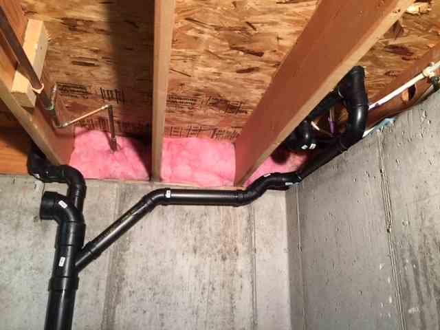

    Continuing the laundry room remodel. Had to put in all new plumbing for the washing machine. (the new toilet is what's going into the unfinished side.)

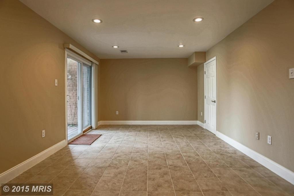

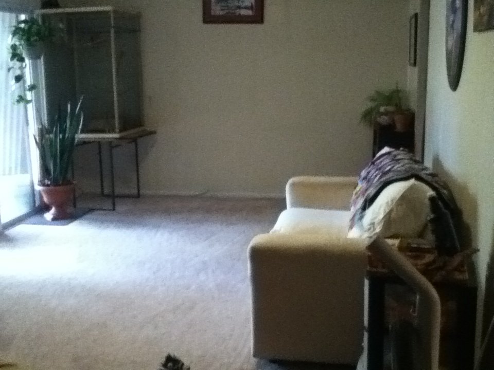

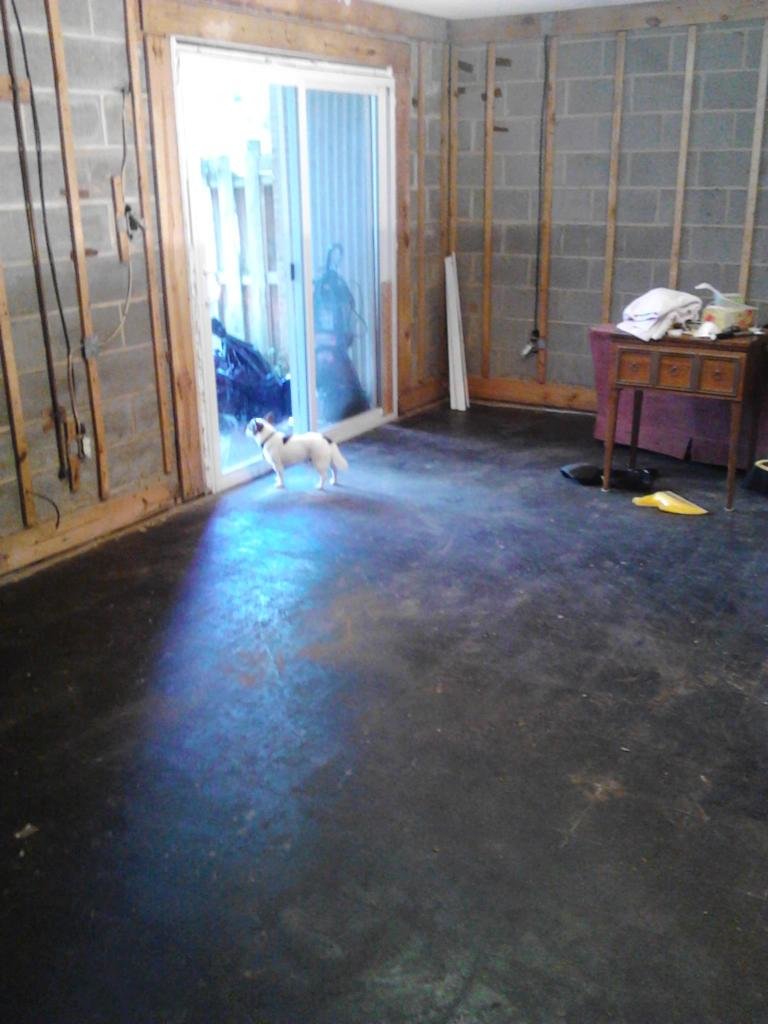

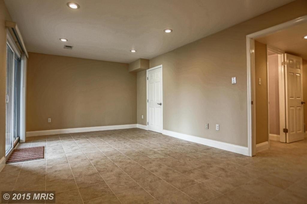

    Just discovered this thread. Here I thought TW couldn't get any better!
    Not things I just did today but I just recently finished renovating my [now] wife's townhouse.
    Basement:
    Before:
    After:

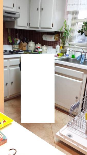

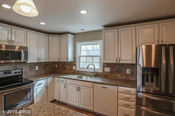

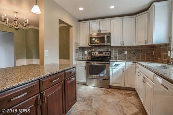

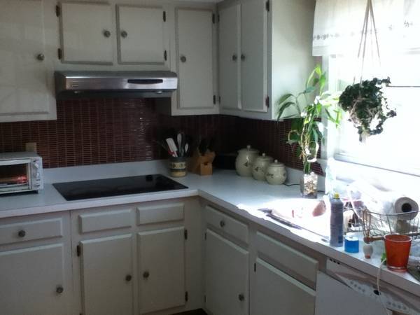

    I also did the kitchen.
    Before:
    After:
