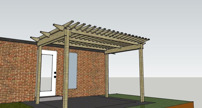

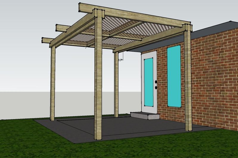

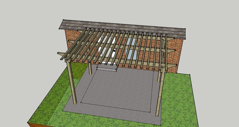

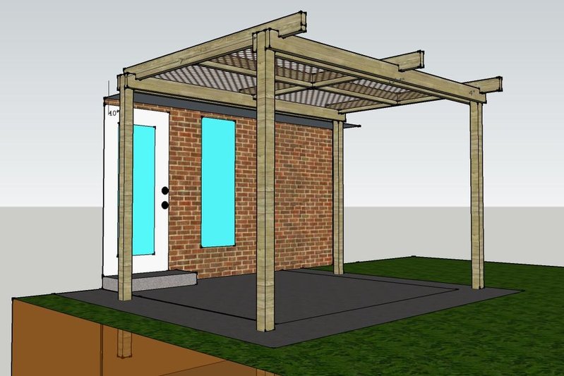

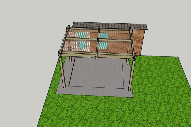

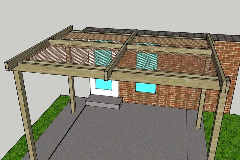

    I want to do a pergola in the backyard, so here's an idea I sketched up in Google Sketchup. Just one of a few I'm working on. Once I get the rest ready, I'll post them as well. the original slab is 10x10 and will be extended once everything is done. the posts will be 4x4's, beams 2x6's, and this one is using lattice. not sure if i'm sticking with the lattice yet, working on one without it right now.

    Do you get snow ?

    Does your city require a permit for pergolas? My city requires a permit for any attachment to a structure including awnings and pergolas.

    not much, which is why I am trying out a different idea right now. add 2 crossbeams in there and thinking 2x4's notched into the crossbeams approx 12in apart (longways). this way, if we do get a crazy storm, it will fall through. I will add the bracing we talked about before.
    yes they do, even though this will be detached (trying everything in power to avoid voiding the builders warranty on the house at least for a few years)

    different without the cheapo looking lattice. 90% of the wood I am able to get from the builder finishing out the last few houses in the community here.

    That looks great

    I like the look better, and it will cost me less to build.

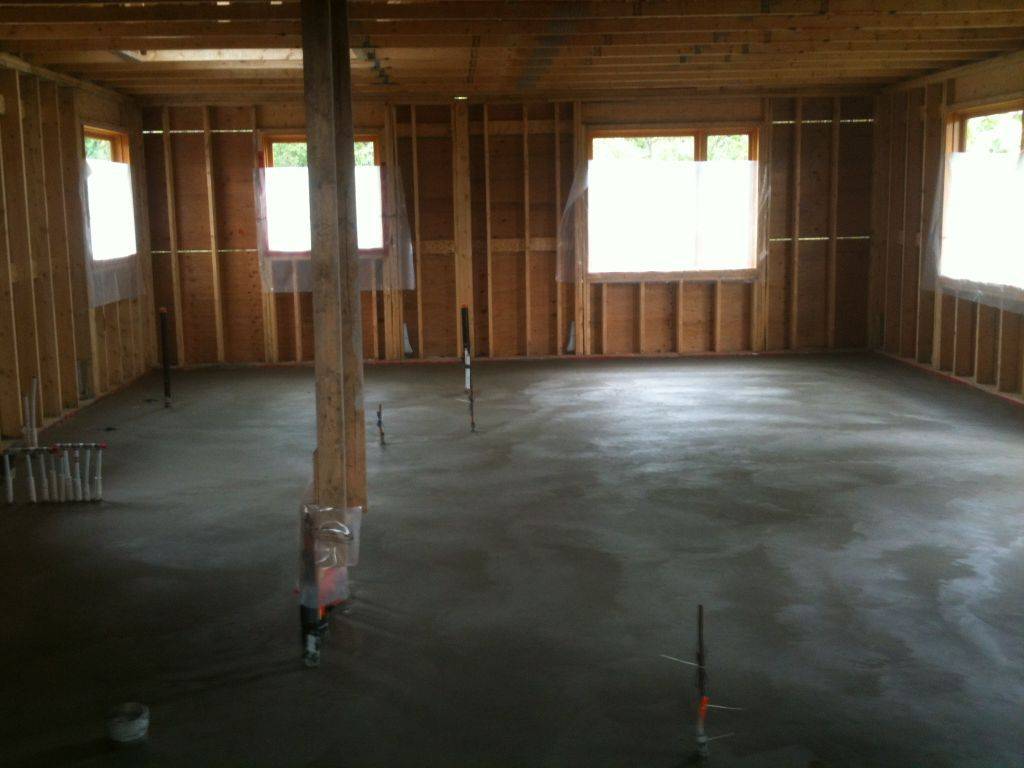

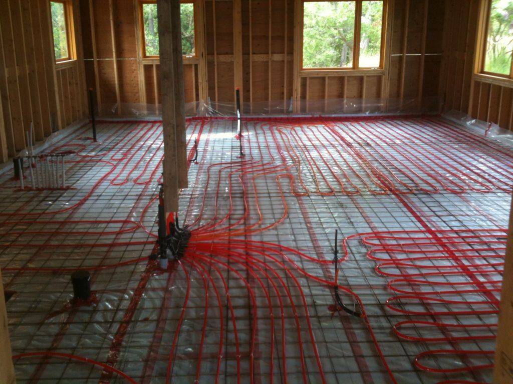

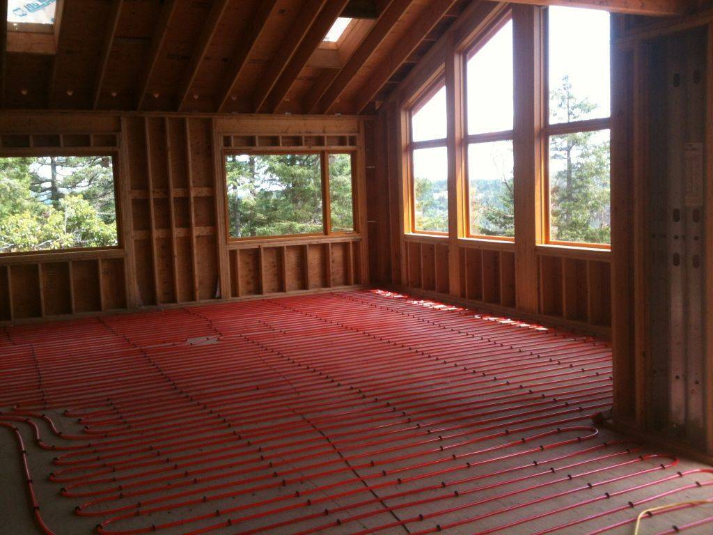

    Slab prep done , tubing down and pressurized , ready for concrete

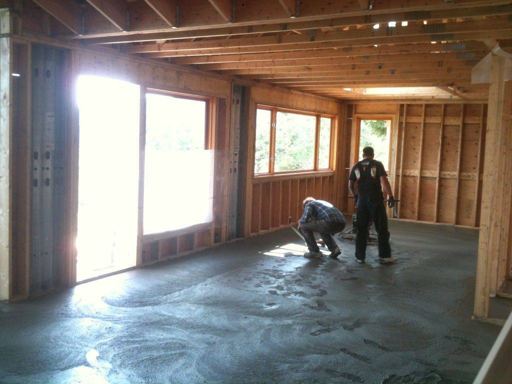

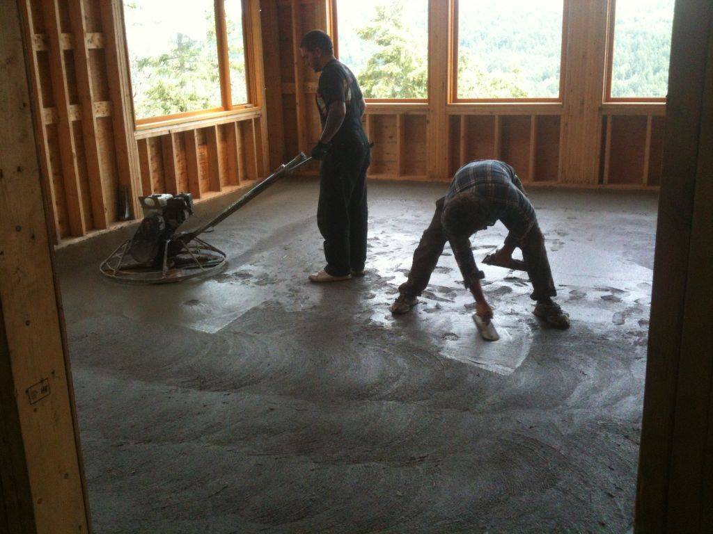

    Poured and finished the thick slab portion today , thin slab over framing gets poured tomorrow

    Over framing poured yesterday
