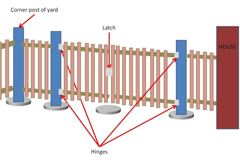

    Arkansas
    Stock TRD Sport 4x4
    I recently purchased a boat and it will not fit through my current single gate (wood fence).
    The before and after pics I drew up here are trying to depict the current setup.
    Looking at the before pic, I think if I cut the 6x6 post at the ground I could use that concrete pad as a stake holder on the back side of the gate.
    Then get a new 6x6 post, as seen in the after pic, measure out the new gates dimensions, cut the fence there, then install new post and new hinges on the created gate...correct?
    The length is roughly 10-12' feet from the house to the corner post, so there is enough room to make it happen.
    I hope this makes sense. I have the ability and the tools to accomplish this, just not sure what the process is.
    Thanks!

  20. Apr 9, 2015 at 3:03 PM
    #4420
    theredofshaw
    theredofshaw Well-Known Member
    Aug 10, 2010
    #41484
    7,038
    John
    Somewhere on the East coast
    not a taco (guess that means I can be a MOD now)
    (totaled) 2011 Tacoma DC
    my neighbor did this to his fence. didn't have the turnbuckle supports until after a month or so when it started sagging. added the turnbuckles and now it works great.
