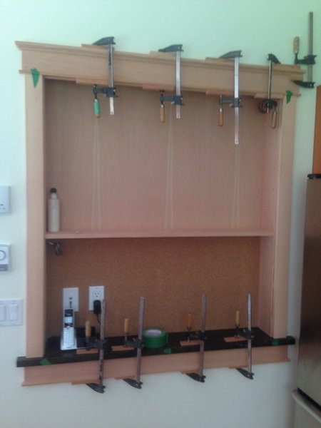

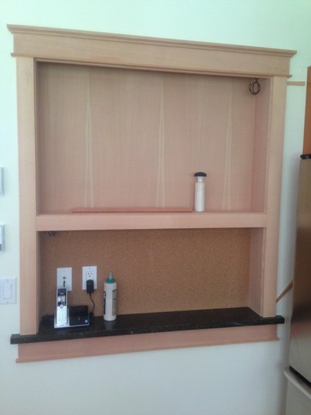

    It's actually 1/4" MDF core VG Fir veneered sheet stock . I liked that grain feature , that's why I picked that sheet

    It's not coated yet but will just get a couple coats of Varathane semi gloss oil

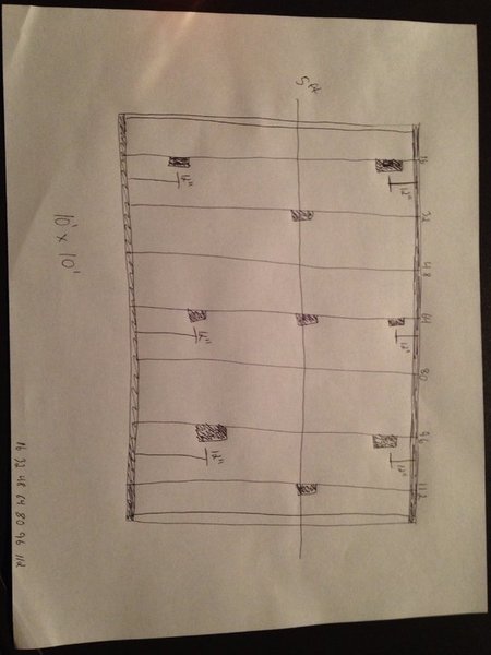

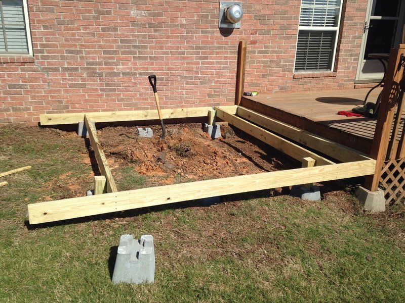

    I know the drawing sucks! Sorry!
    Alright guys, I need help and I need it quick. Gotta get this tackled before a b-day party next in a week.
    10'x10' deck addition. It will be ground level/floating deck. The ground is not level and does slope and I have 4x4 posts to accommodate on top of pier blocks.
    I am starting by locating the placement of my pier blocks. I can not for the life of me figure out how to determine exact locations and place them.
    I think attaching the ledger board to the existing deck may be a good place to start but not sure.
    The pier block locations are depicted by the drawn in squares.
    12" in from deck edge @ 16, 64, and 96
    5' in at 32, 64, and 112.
    The 112" edge is the end that attaches to the existing deck.
    HELP!!

    I'm old school , I run strings between batter boards and use a plumb bob

    That's the way I was trying. It was 1030 at night and I was tired.
    I think the best way will be to hang my ledger board on the existing deck, then measure and stake strings.

    Day 1
