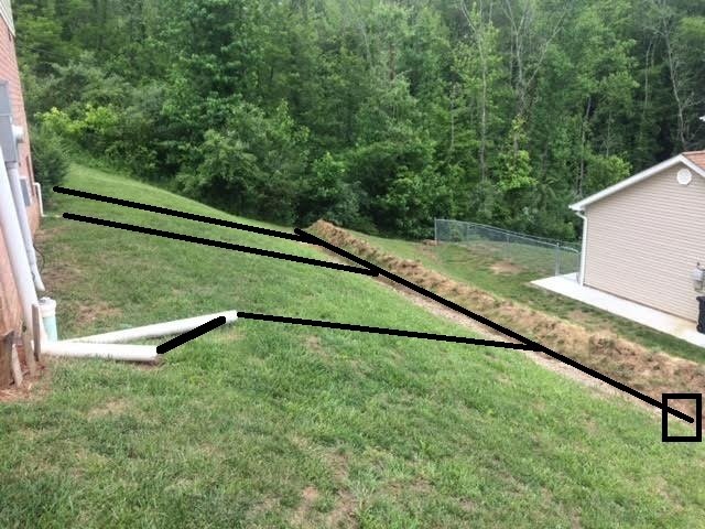

    Starting a drainage project and need a question answered...
    Short way about it is: Can you tie downspout drains into a french drain if it is below grade of the downspouts?

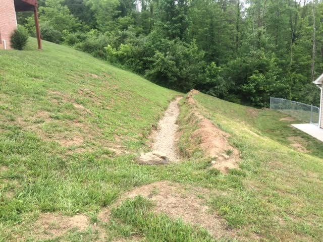

    Long way: My neighbor and I dug out a temporary trench to help alleviate some of the water runoff he was getting in his garage from my downspouts and from the natural drainage of water downhill. It solved the problem, but now I want to add a french drain in the trench and cover it up for asthetic reasons. I was hoping to bury my downspout drains underground via 4" corrugated piping, and my sump pump discharge piping into the corrugated perforated piping and run it all out back where it will drain out and away like it has been. I will be lining the trench with a soil separator first, and will be using a catch basin at the beginning of it for a vent in the system. If I tie my downspout and sump pump discharge piping into the main drain, will I be defeating the purpose of the perf piping and just adding water back into the trench soil? I assume since most of the runoff is from the downspouts, it shouldn't hurt, but I don't want to do this and create a bigger problem. Please see my pics and if you need anymore info, let me know.

    Depends on the volume of water , I would keep the downspouts in a seperate solid pipe myself , you could tie the perforated french drain into the solid line beyond your drain bed as long as the 4" pipe could handle the volume but I wouldn't dump the downspouts into your french drain perf

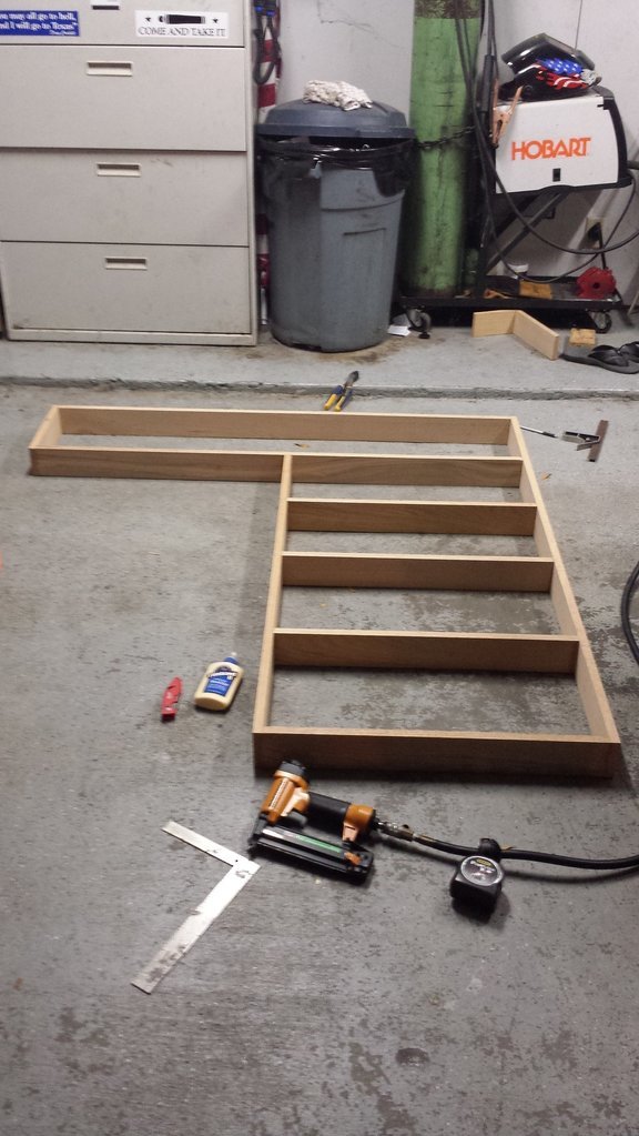

    Having had enough of all that, last night I started a small project that I can actually take ownership of and enjoy doing. With the new furniture in my sons room we found ourselves with no place for his books. I think that I came up with a boarder line genius idea to fix it and started building this shelf out of 1 x 4 red oak. It might look a little odd right now and the idea behind it would be difficult for me to explain so I will let the finished pictures do the talking. Here is what I have so far, still have some more work to do tonight as it got late on me yesterday and I try not to run power tools after 10 pm for my neighbors sake but hopefully I will get it finished and stained tonight, hung on the wall tomorrow.

    The majority of the volume of water is from the downspouts. I kinda figured the French drain would run off any excess water from the slope of the land. Would you suggest just running each line parallel to each other in the trench and having them drain off together? Or run another individual trench for the solid line?
    Just in between my yard and the neighbors is a creek maybe 30 yards into the woods. It all slopes back towards it so most of the runoff is running right into a creek. The houses at the very top of the hill drain their downspouts straight back into the woods as well big it's pretty far back in there.

    You can do a single trench , line with geo fabric bottom and sides , install perforated drain at bottom with drain holes down , lay in some clean drain rock to cover the pipe , put your downspout solid line on top , fill up the trench with more drain rock

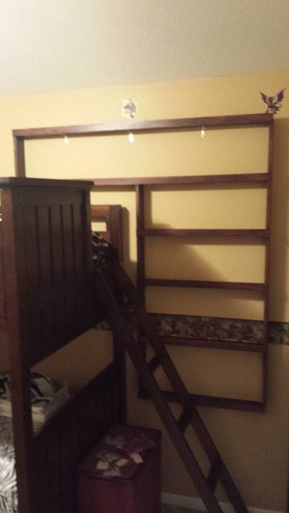

    Is that going to be mounted on the wall?

    Yes sir. Still not completely finished but it's getting close.

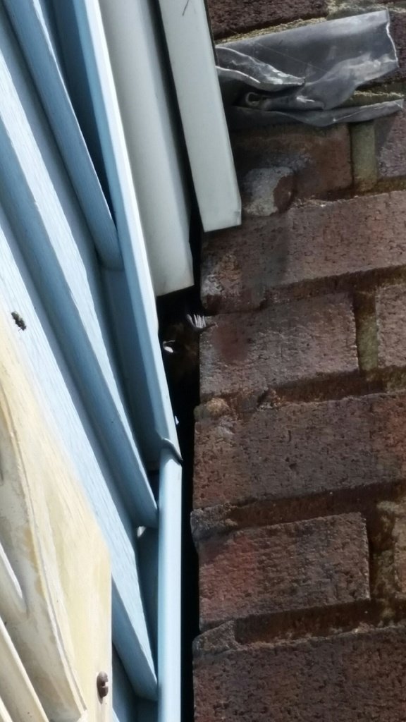

    Check out one of my roomates living in my attic:
    I am currently building a batbox that I will attack the chimney near this opening. That being the case, i want to close off this opening around dusk when they should all be outside. What would be the best method of doing so? It is a little too big to use caulk, so I was thinking some of that "great stuff" expanding foam, shave it flush after it sets, then caulk over it to make sure it stays sealed.

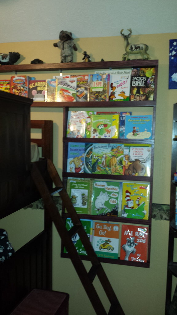

    Here is the finished picture of the book shelf I built. I think it came out OK, the staining process was the worst part.

    ^^^ I like the bookcase/rack.

    :thumbsup: looks good

    What's going on there ? Is there a space between your brick chimney and your wall sheathing ?
