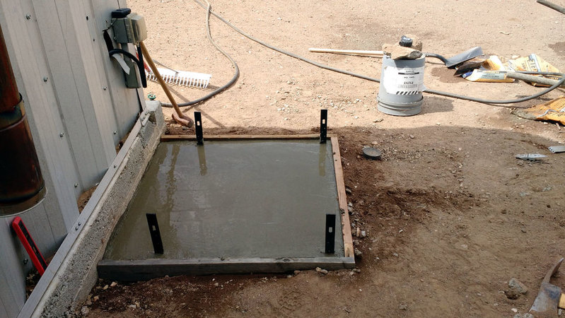

    Poured the pad for my air compressor shed/lean-to/closet. 96°F with 46% humidity.

    Thanks. It'll probably be unnecessary, but I'm going to put some acoustic foam on the shop side of the shed and I'll rig up a fan/cooling system that turns on with the compressor. Basic 2X4 framing covered in T-111 will be coming eventually. The shed will also hide the drain line coming from the future shop sink running to the RV septic cap you can see just to the right of the form.

    Are your hold downs actually quick strip forming ties ?

    Yes. Couldn't find a product to anchor 2X4's to the concrete that didn't involve drilling the concrete or trying to precisely set bolts in concrete. Figured the forming stakes would help to reinforce the pad being driven into the ground and would hold a fair amount of load with 1-5/8" wood screws going through the stake and into the wood. 3 or 4 screws each.

    Oh yeah , I'm sure it will be more than fine for what you are doing , I was just curious
