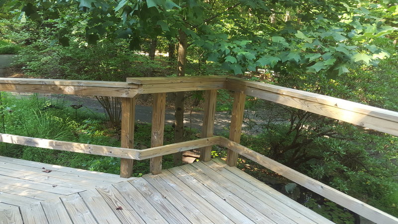

    The simple railing we did. And the deck is 2x6 select pt and not holding up well at all. I am starting to worry more and more about any pt lumber we've used since they made the big change.

    The lumber seems to be OK in my experience , it's what ACQ does to the fasteners and hardware that is scary

    Yes, and it was hard for a while (several years ago) to find the correct sort of stainless fasteners or Zmax Simpson brackets/fasteners down this way, but that seems to have improved. Not cheap, but at least available.

    ZMax don't cut it up here , building inspection here wants to see stainless on decks that are re-wetted ( skip decking )
