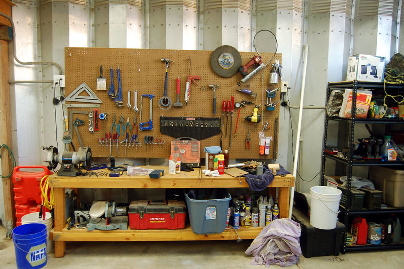

    My old bench, integrated to a storage lofty thing in my old sheet metal kit garage, was 2x6s laid flat with masonite screwed to the top. On top of 2x4 cross pieces bolted to 4x4 legs. Can thrash it and re-skin as needed, although I never needed to. Loved it. These are the only pics I have handy, but I think you can get peeks of all the key details.
