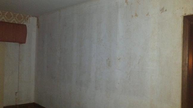

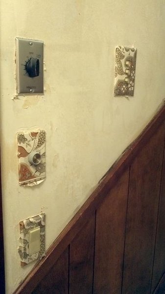

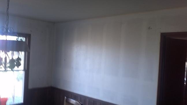

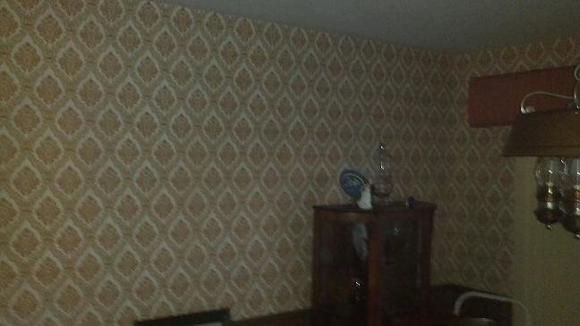

    So, this weekend was wallpaper removal weekend. As you all know, my new house has wallpaper EVERYWHERE. The lady who did it was very good at it, it's just some of the patterns were horrible. Plus, she wallpapered everything including switchplates and the electrical box. Fortunately, it looks like it is all just one layer of paper on the walls. We started in the dining room, went to the kitchen and then the stairwell.
    Here's a sample of the papered switchplates.
    For the electrical box, I pulled as much as I could get off by hand. I then used the DIF solution (below) and applied it to the paper that was still on the box. I applied it by spraying the solution on a rag and then wetting the paper backing and let it soak in. I didn't spray directly on the box as electricity and water are never a good mix.
    We used two methods to get it off. First we tried the Wagner 915 On-Demand steamer in the dining room. It works well but it's slow going. Plus, I wanted a different method for getting the stuff off the kitchen ceiling and the stairwell. The stairwell in particular is too high to be trying to manipulate a steamer while standing on a ladder.
    I found this video series on YouTube. Though his videos are a little long, his method works well:
    http://www.youtube.com/watch?v=ma0-X8mo9tQ&feature=plcp
    It's a chemical removal using DIF (NOT THE GEL) that's available from Home Depot. I bought the little concentrated bottle. Two capfuls to 1 gallon of water.
    We still use the steamer to clean up small spots of glue or difficult to access spots. The DIF solution is messy, especially if you have to spray it directly on the pattern so make sure you use drop cloths. For the kitchen we bought some thin plastic sheeting and covered everything that wasn't wallpapered.
    For removing the glue residue after the paper is off, we used the DIF solution to get the glue to a consistency so it could be washed off. Then we scrubbed it with a drywall sponge (course on one side). You can also use the steamer as it works well on the walls without using a bunch of chemicals or making a huge mess. It's more difficult for the ceiling areas though. We didn't care too much about getting the chemical on the floors as we're going to eventually replace them.

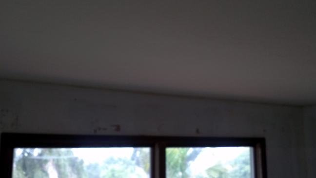

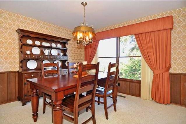

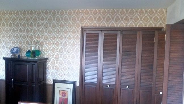

    Dining Room before:
    Dining Room After:

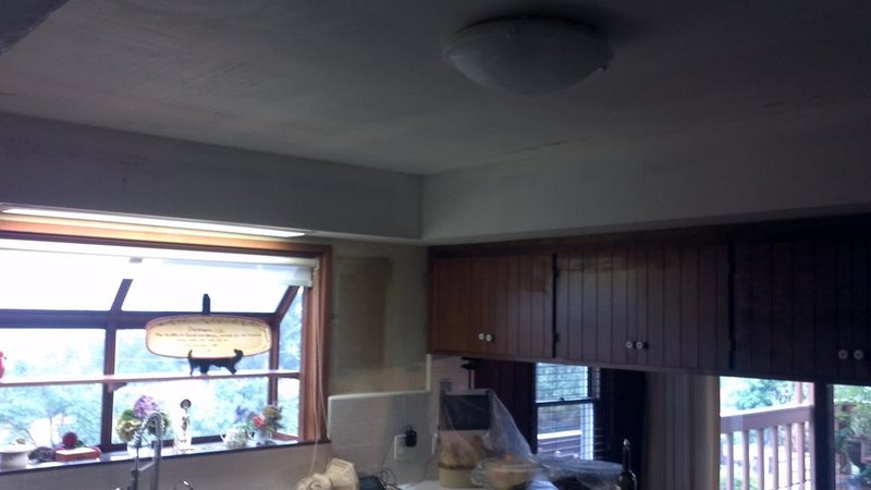

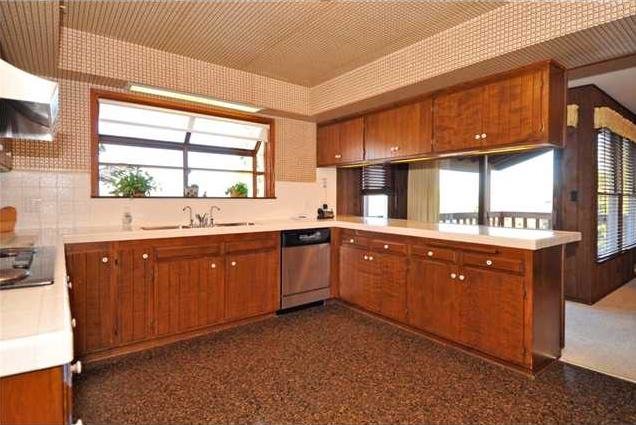

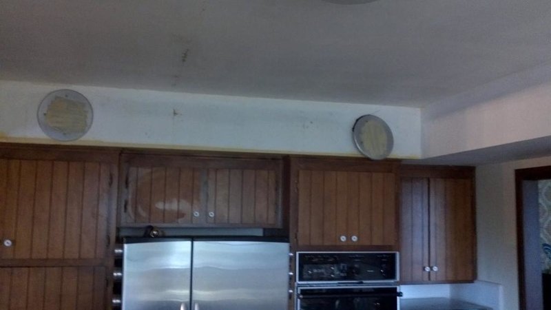

    Kitchen Before:
    Kitchen After:

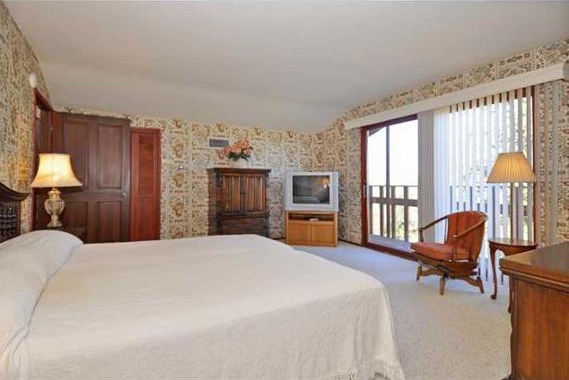

    The upstairs master bedroom and the stairwell leading up to it have the same paper. The stairwell is pretty tall at it's highest point (about 15 feet from a stair to the high point of the ceiling). Whoever papered it went all the way to the ceiling.
    Master Bedroom/stairwell before:
    For the stairwell, I was able to get the paper face off in large sheets without using the DIF solution. It left the paper backing on the wall. I then sprayed that with the DIF solution and let it soak in a bit. It came off pretty easy, much easier as it soaks directly into the paper and doesn't have to go through the shinier face paper. You'll want to soak it in and look for any dry spots. Dry spots will not come off with the sheet. Also if it drys while you're pulling it off, you can just spray a little more of the solution to wet it and it will come right off. A paint scraper works well for getting it started or for coaxing small dry spots.

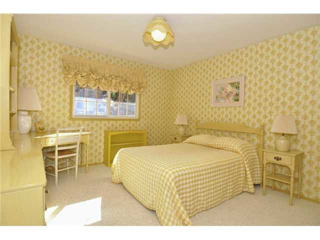

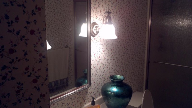

    Yep. It was built in the 70s. I still have 2 1/2 bathrooms, the yellow bedroom, both master bedrooms, the living room and the hallways to do. The bathrooms are hideous as well, but the living room, the downstairs master and the hallways aren't too bad (neutral design). Plus the paper is really thick so it should pull off easily.

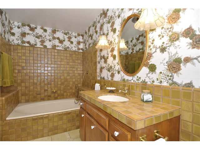

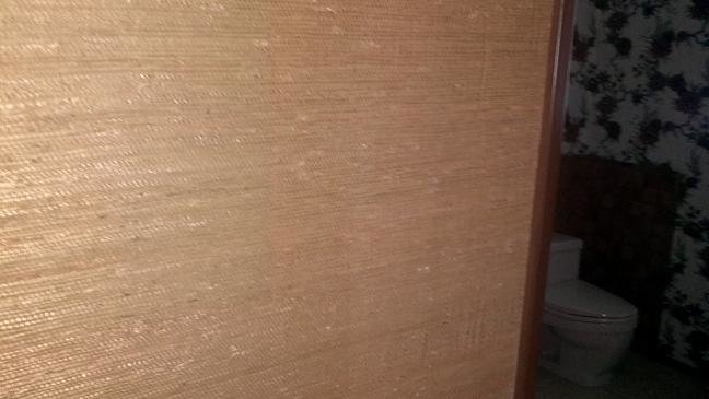

    The upstairs bathroom has the same paper as the upstairs master. Here's the downstairs master bathroom and the yellow room:

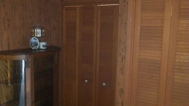

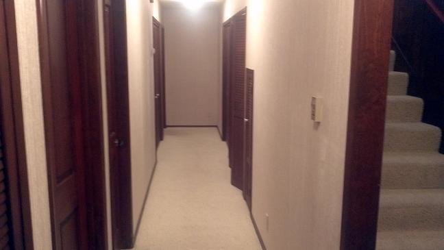

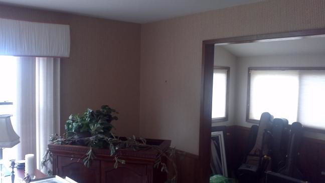

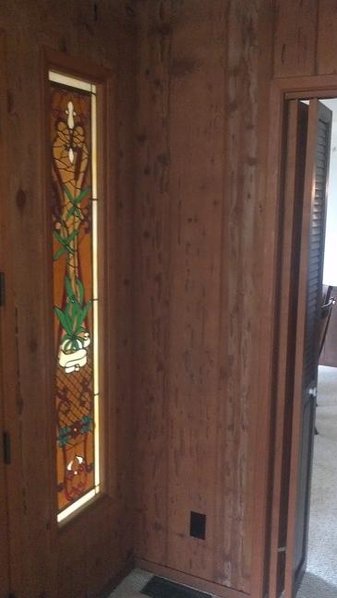

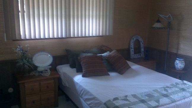

    Here are pictures of the other rooms:
    Hallway:

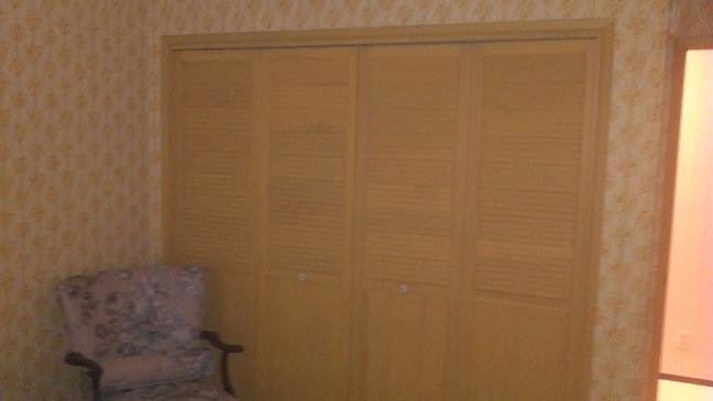

    Downstairs Master:

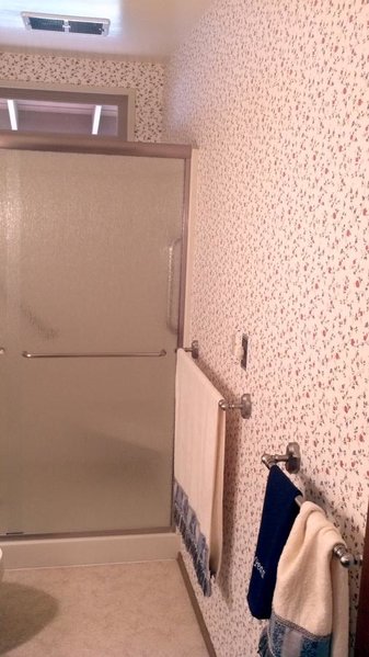

    Downstairs main bathroom:

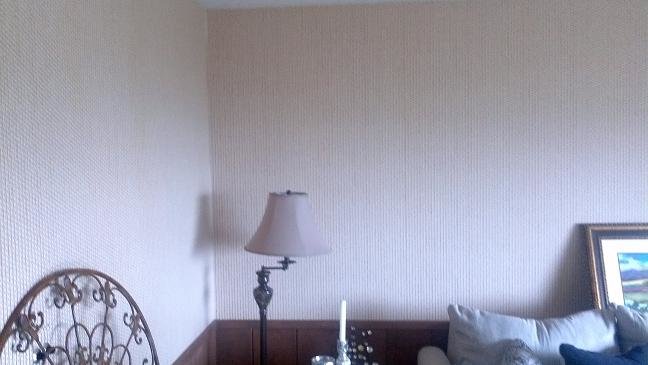

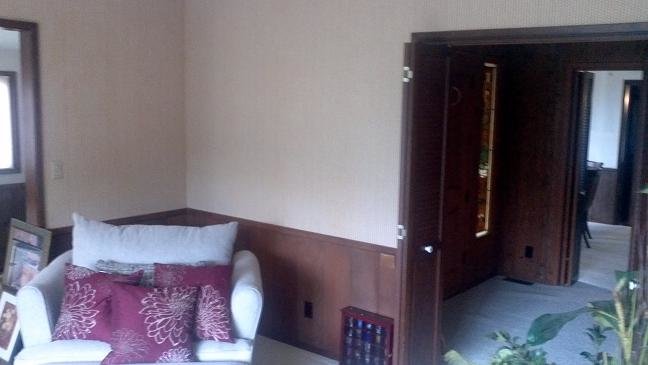

    Living Room:

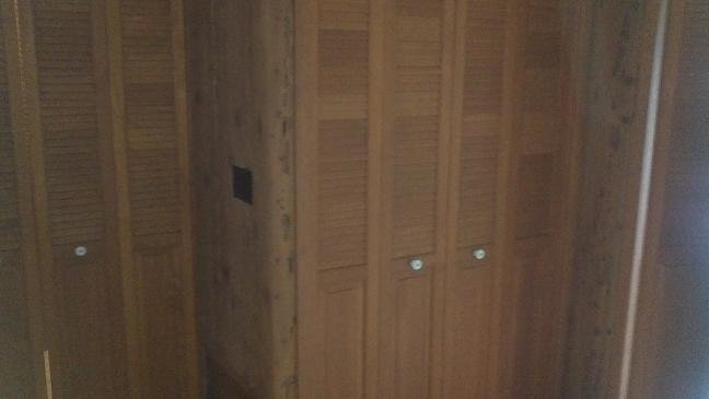

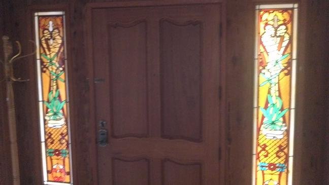

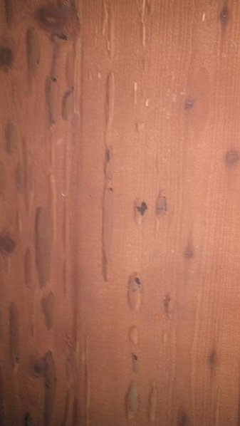

    Entry way. This is more like a tongue and groove paneling. The wife doesn't care for it (it's deeply cratered). I don't mind it but I don't care if it's removed either:

    Good God, that yellow room. I don't envy you dealing with that. Beautiful house though! Great view!

    Yeah, it's pretty bad. When we first saw it we were like, "OH....MY....GOD!!!!"

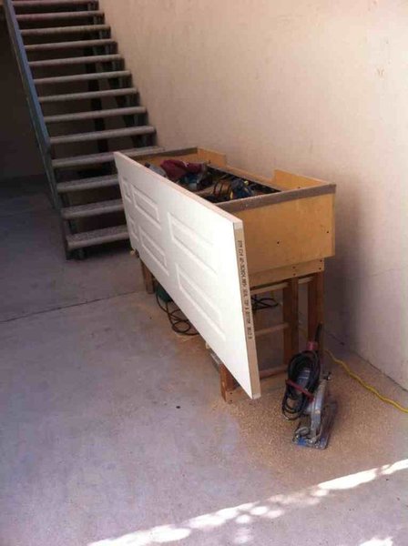

    Here ya to Oz.
    Another day or hanging doors
    Door bench is the only way to go
