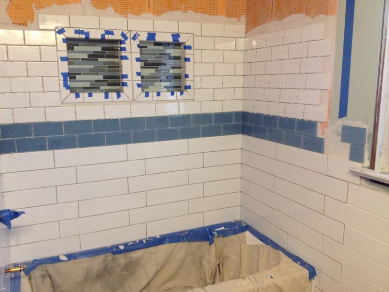

    how come? they worked great in my situation. 2 - 12"x12"'s and 1 - 6"x12"
    oh i see the problem... not measured in canadian...
    :p

    I laid mine out so that the full rows of tile would run through with the niche trims landing on unaltered grout line elevations
    Not knocking the Schluter pre made niches , just didn't work for what I wanted

    i see. kinda like how my tiles didnt line up properly with the niches. 1/2'' lower and they would've been perfect.

    I use wood alot to figure out layouts and space things out. Also to create a bed so glass accents are flush with the other tile. Also this tile was the hardest tile I have ever had to drill. I burnt more bits on the ada grabbers then I normally use in several installs.
