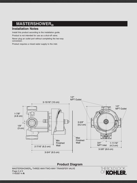

    I've got a question for you guys. I'm working on my bathroom and have the plumbing roughed in (my contractor did that part). I'm using a Kohler pressure balance valve and a diverter valve. I have 3 shower devices roughed in that are fed by that diverter: a hand wand, rain shower head and a wall mounted shower head. I'm fairly tall and like a high shower head (why is the standard to mount those things so damn low?!) so the wall mount will be about 7' off the finished shower floor. This was done in the summer.
    Skip forward to now and I've been involved with someone who will likely be moving in sometime later this year. The issue is she is petite - about 5'1" - and the 7' shower head isn't going to work for her. Rather than move it down, which I really don't want to do as I hate having shower heads at forehead height, I'm thinking I could add another shower head at a lower height using the port for the tub filler fixture, which I currently have capped off (no tub).
    I'm having difficulties interpreting the language in the instructions as to whether this will work or not. If not, why? The tub filler is downstream of the mixing valve so the only thing I can think of is a possible pressure issue? I've inclued a diagram and some valve schematics below. It's the wording of the Installation Notes that I'm looking at.
    Any thoughts would be appreciated!

    It's a hair thing. Sometimes it's neeing a shower without getting the hair wet. Water falling from above makes it hard to avoid that. She uses the shower wand in the guest shower now but it's not ideal. We can get by, but since the walls are open and material would only be about $50 I figured why the heck not? Score some points with Ms. Petite and get more shower nookie! Anyway, I think there is an issue using the tub filler as a shower head with the way the valve works, just don't get what it is.

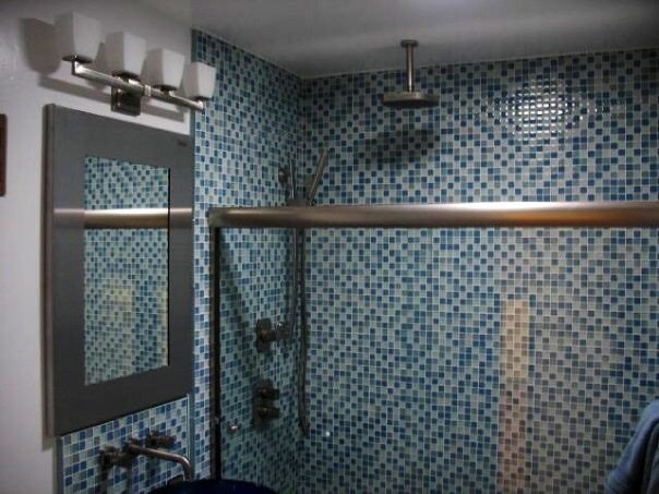

    The wand I have plummed for is mounted on a sliding bar so it can be adjusted up and down, but it's just a fixed spray, doesn't put out a lot of water or a comfortable pattern. It will work but an adjustable shower head mounted low, although not necessary, would be nicer. This is my guest bath with the sliding bar, rain head and tub filler. No wall mounted head in this one.

    This is the master shower;

    Yes. In both showers. You can see the schematics in post #6747, Mastershower Three way/Two way Transfer valve. It's awesome - can have any 1 of 3 heads run on its own or some combo of two of them at the same time.
