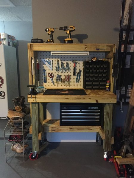

    Here's the finished product!

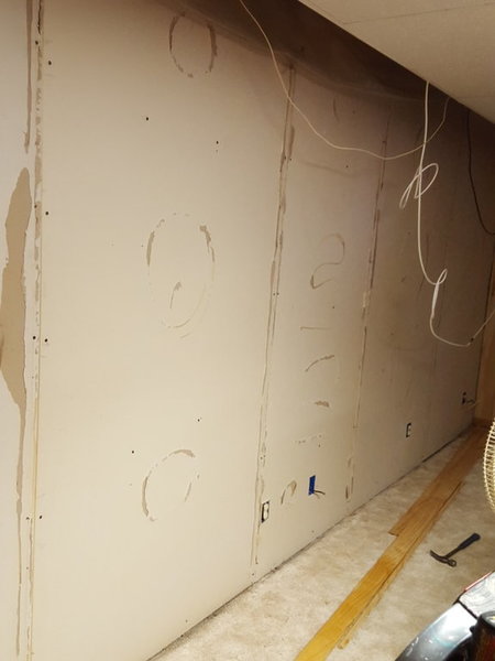

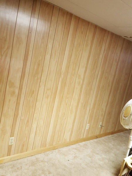

    Demo in my basement today good by ugly wall paneling Hello who the fuck drywalled this. There is a 38" peice in the center of the wall. It would be 23 sheets if I want to replace it so I'm not sure which way I want to go on this.

    If the electric is good I would mud and paint and move on.

    Nice little workstation

    Board over and install box extensions on the recepticles and switches

    Thank you!

    I would but I'm going to build in some storage into the walls so I have to reframe sections anyway. The only part they got right was which side of the panel faced out

    Oh , then yank it all off so you can see what you've got in there , make it easy to move electrical and re frame and as an added bonus you can use your Festool drywall sander

    Nopeople and a vapor barrier too wow. Framing is all kinds of wrong though.

    There's a vapour barrier as well as the paper faced batts ?

    Yes plastic on the block side. I'm surprised to see it. House was built early 80so and this drywall was nailed and glued.

    Well thats on the wrong side of the insulation anyway , a plastic vapour barrier should be on the warm side
