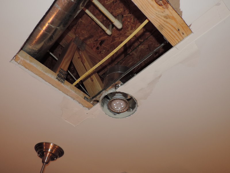

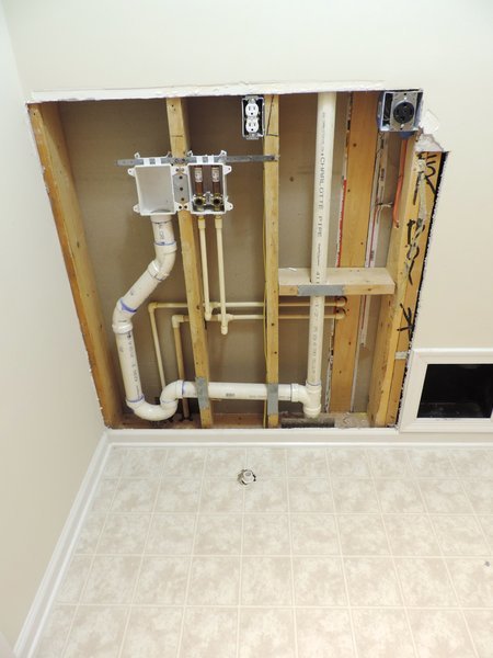

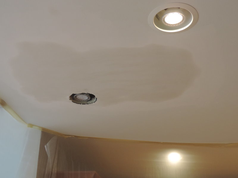

    I had a small leak from a washer hose that went unnoticed until the spot showed up on the kitchen ceiling I cut out all the drywall and redid it all.
    The drywall was only wet under the valve box and too the floor level then had water stains on the ceiling in the kitchen along the tape joint.I may have gone a little over board with the removal of drywall but I don't play when water is involved...
    I wanted to make sure it was dry as a bone and no mold anywhere treated it with anti bacterial stuff sealed it up and moved on...
