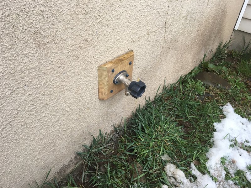

    Gotta replace the pipe headed the outside spigot in the back yard. Those "never freeze" spigots do indeed freeze. Last time I decide to risk is and leave it open for the winter.
    May just cut the copper after the shutoff and replace it with those shark bite valves and pex pipe to a new spigot. I do not want to be sweating copper and such right now. My father has one of the pex fitting crimper tools so I can borrow that.

    They freeze if you leave a hose attached

    Lots of people make that mistake , its the common cause for freezing in a frost free hose bib . How the frost free bibs work is that the shut off for the water is actually at the very inner end of the stem which puts the liquid water as far back into the insulated wall as possible , but that relies on the rest of the spigot being able to drain when you shut it off so that there is no water in the exterior portion of the hose bib , that can't happen with a hose attached

    you think cutting the copper after the shutoff then using pex to the new spigot is a decent way of going about it? Or would it be better to just replace the cracked copper with new copper?

    Either pipe is fine , I would likely replace the hose bib at the same time

    N make sure that sumbitch is running downhill lol

    The longer the frost-free valve is, the better of a chance you'll have for it not to freeze. If you use Pex, you'll still have to solder on the appropriate fittings on each side to accept the Pex.
    I have the fittings and the 1/2", 3/4" crimper if you need to use them if you go with Pex. I'd just go with copper anyway since you still have to solder.

    Thanks for the input! I cut the pipe right after the shutoff and ran a new copper line (had a little left over from a bathroom remodel) and installed a new spigot/hose bib. So far all is well....
