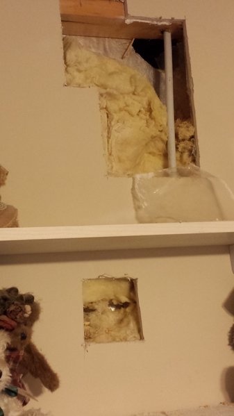

    Help!!! @OZ-T if the paper is gone from the back of the drywall, will it matter?? :anonymous: just in spots

    paper is what gives it its strength

    :rant: that's what I figured..... could I use some tape to fix it?

    pictures speak a thousand words
    also what room is it in?
    personally, there are certain ones i will just say meh to. but, drywall work is cheap & not that time consuming, so depending on the location and size i'd consider just replacing the sheet.

    it's for the holes in my bed room wall.... bought too thick drywall and wanted to thin the edges down and just use it... one piece is 18 x 30 and the other is 8 x 9"

    i'd just purchase the proper thickness sheet, around here it'd be less than 10 bucks for more than enough

    1st buy the right thickness Drywall. You need to make your holes as square as possible as well and make the cuts run from stud to stud. Generally 16 inches by whatever. The hole but where you can see the trim will be a pain. You'll have to pull the trim for sure to finish it right. When you repaint make sure to get two good cuts of paint or the spot will look otchy compared to the rest of the wall. Hope this helps.

    I took the cutout with me, and put it next to the new piece and it seemed to match. The other one seemed too thin :notsure: Corners are square and the top holes are now one. pic supposed to be headed to live....
