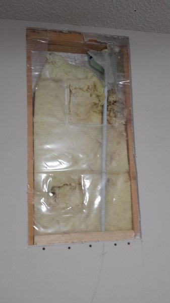

    Front or back

    I took the cutout with me, and put it next to the new piece and it seemed to match. The other one seemed too thin :notsure: Corners are square and the top holes are now one

    back

    If the paper is gone from the back you should cut the patch back farther to where there is paper . Is it all of the patches or just the one by the baseboard

    Its possible there is a mud build up making the drywall seem thicker in some areas than others , for instance where there are seam tapes or butt joints

    drywall is too thick... need to trim the edges to fit... but going to get thinner stuff tomorrow

    Nope, too thick all around

    The stuff you bought is too thick or the existing is thicker than what you bought ?

    stuff I bought was too thick, but it matched the sample I took on the edge :notsure:

    Huh , and I assume you bought standard 1/2" drywall ?
    They uses to use 3/8" gypsum board but that was usually in older houses

    bought 5/8 thick drywall, but need 1/2" drywall.

    Oh , well there you go .

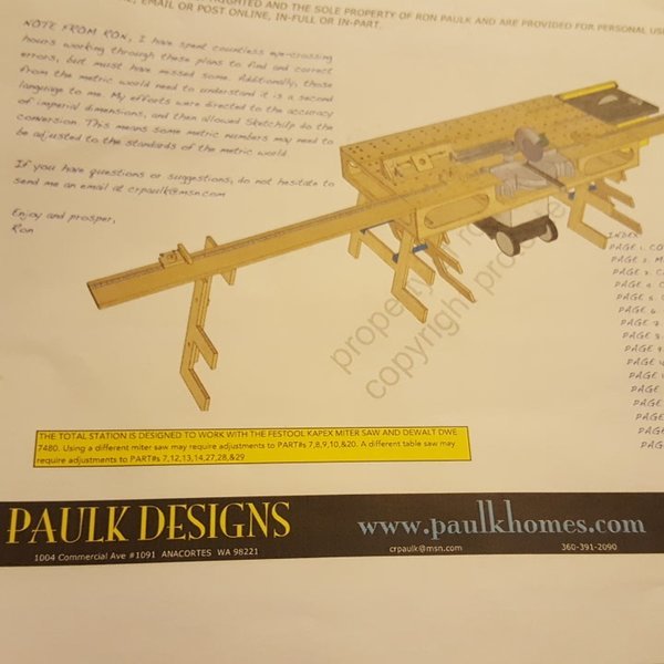

    @OZ-T the horses for this are 3/4

    Did you get all the plans or just the mitre saw stand ?

    The total work station
