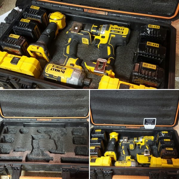

    I've been going a little crazy organizing my tools too.
    rob1208 and Maticuno like this.

    I picked up the set of rigid boxes all my cordless is in them.

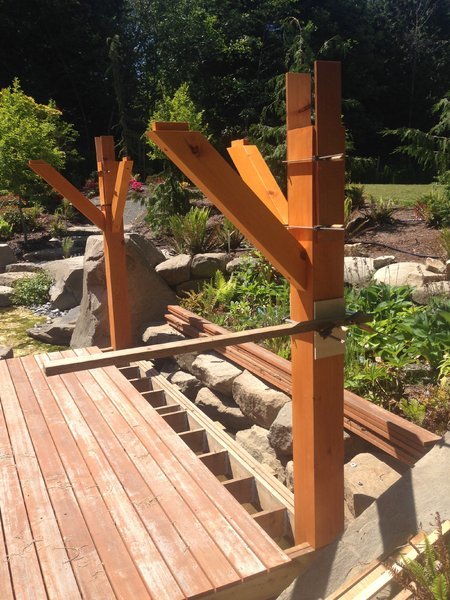

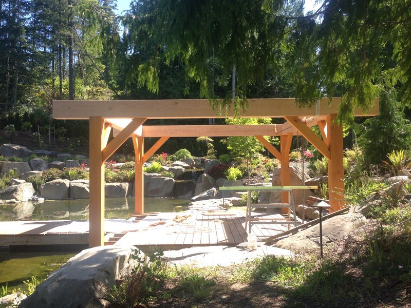

    So ....

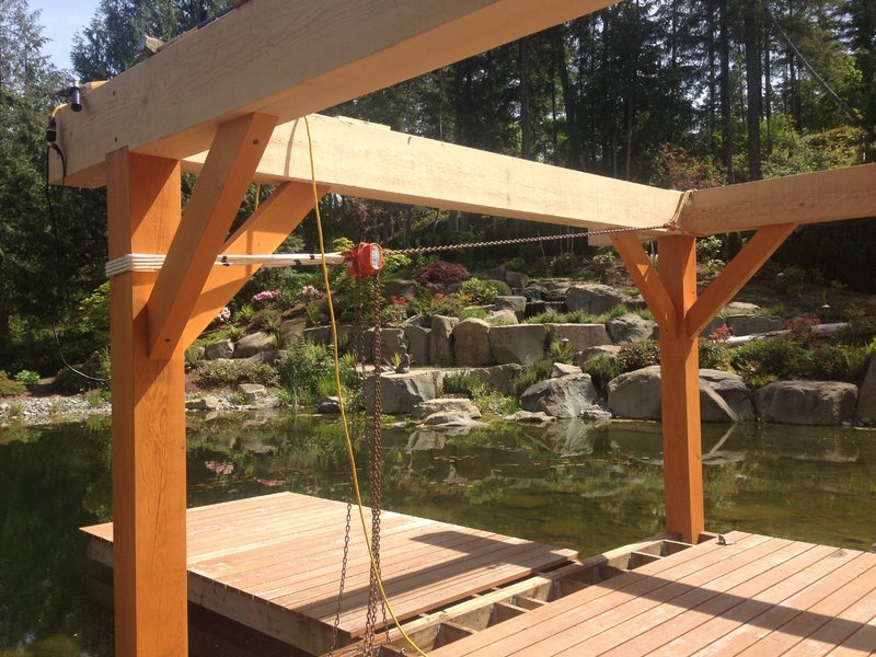

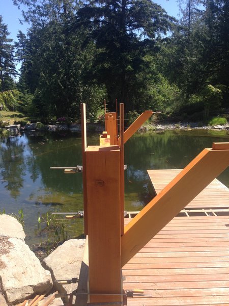

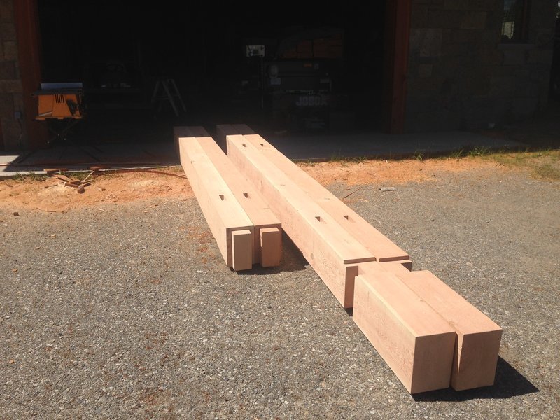

    Rolled the timbers out of the shop for the last time so we could pick them up and load them on the truck to run them out to the pond
    I discovered earlier in the day one of my posts had a pretty significant twist in it , you can see by sighting through the temporary stops that the post tops and braces definitely don't line up .
    Not sure if that post was that bad before or spun a bit in the sun yesterday
    I was thinking it was gonna be Big Trouble in Little China to get that beam situated so my solution was to slack the bottom bolts that connect the post to the deck framing and rig up a lever so I could twist the post into alignment ( hopefully ) once we had the weight of the beam perched on top
    Took about 1 1/2 hours but we got them all landed with the help of a chain hoist to persuade the timbers to move into place
    I'm still fighting a bit of a twist in one main timber but I'm going to deal with that tomorrow , run the rest of the GRK RSS connectors in all the pieces and get a coat of stain on the beams

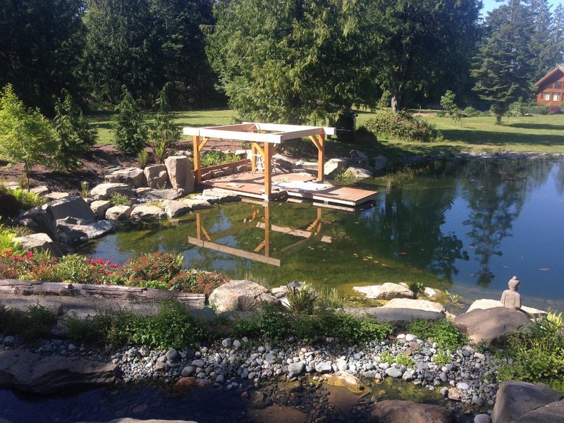

    Dying to see what the roof is like. Broad eaves, low pitch?
  10. May 12, 2016 at 8:37 PM
    #6750
    OZ-T
    OZ-T I hate my neighbour
    Dec 15, 2009
    #27584
    50,587
    Peter North
    British Columbia
    Concrete slate tile , 2' flat soffits on the eaves and 2' gable overhang , 7/12 pitch , fishscale cedar shingles on the gables , it just basically mimics the other buildings there

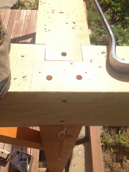

    Didn't get quite as much done today as I had hoped , no staining but got all the connections done .
    Wrestling the twist out of some of the posts and timbers proved to be a bit more time consuming than I thought , I used a combination of the chain hoist and some big bar clamps but in the end I'm pretty happy with all the joints
    These are the 16" GRK RSS screws used to connect the timbers and posts , the braces got 8" GRK RSS screws
    I used a 3/4" forstner bit for a clean hole that snugly housed the head of the RSS screws and allows me the ability to use a 3/4" plug on the exposed connections if I decide to later
    Post to beam is 3 screws and main timber to crossing timbers is 2
    I think I'll come back in the morning to stain the beams rather than let them crack out in the sun all weekend
