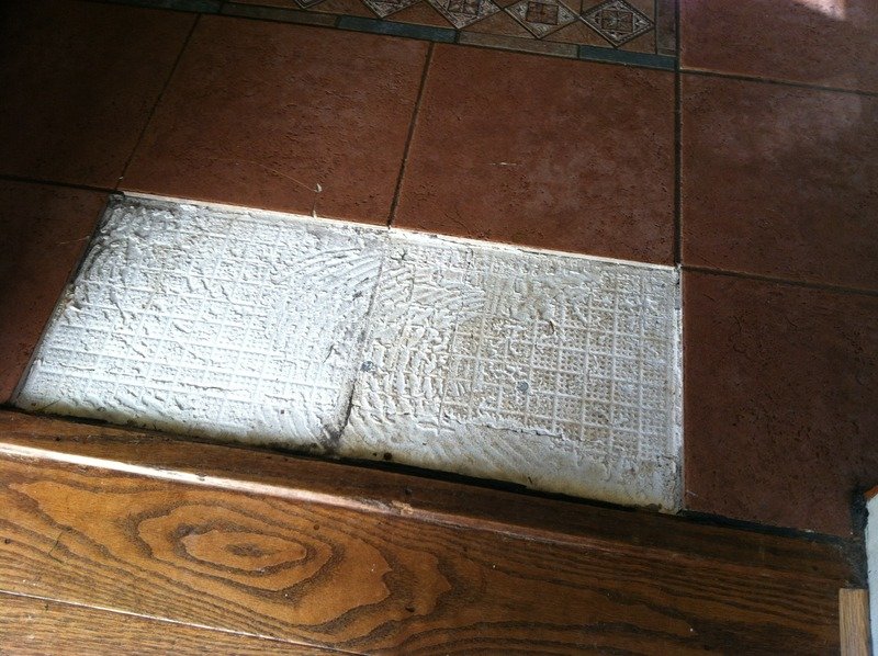

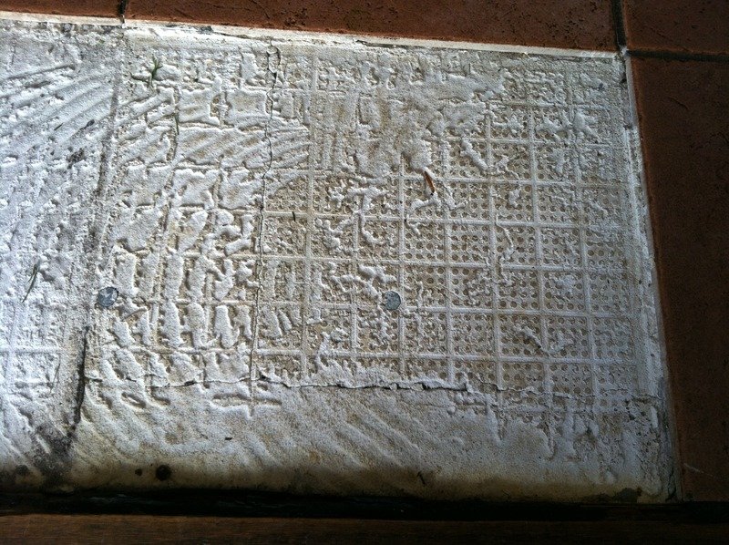

    scrap up the white thinset, and check the main concrete flooring for cracks... after all, the house is old.

    didnt catch that, I just figured the dry wall was still useable. was trying to avoid tearing out the drywall.

    He's on a framed sub floor

    For a temporary fix until you get to correct the root of the problem you could use construction adhesive. @OZ-T has already stated a way to begin investigation into the root cause/fix of strengthening/immobilizing from below.

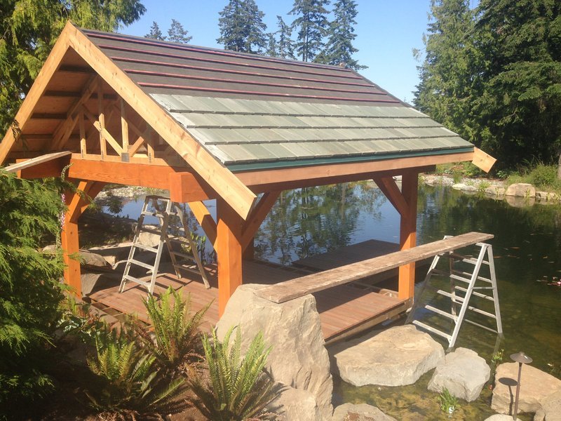

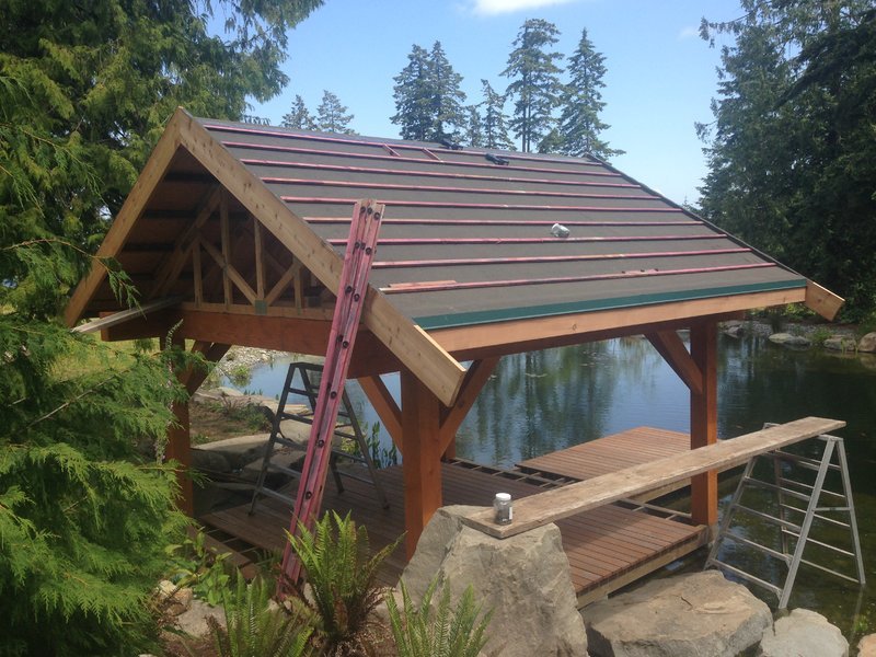

    Got the facias done , eaves ramped and flashed , elevated battens installed and got the tile about 1/2 way up one side

    Concrete tiles?

    How's that hold up? Our next place has that for roofing.

    Its great but heavy as shit , you have to beef up all the roof framing and lateral restraint solutions

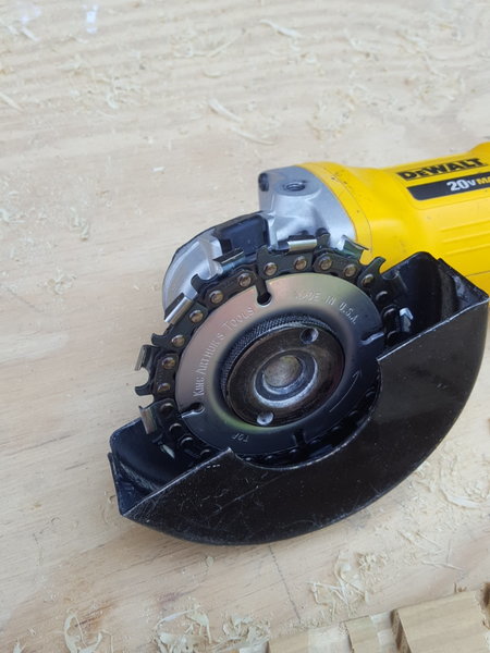

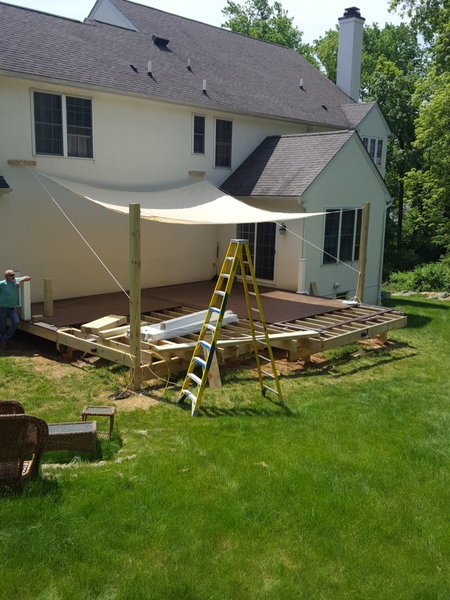

    Deck sail temporarily set up. And had some grooves to cut in the 6x6 for wiring

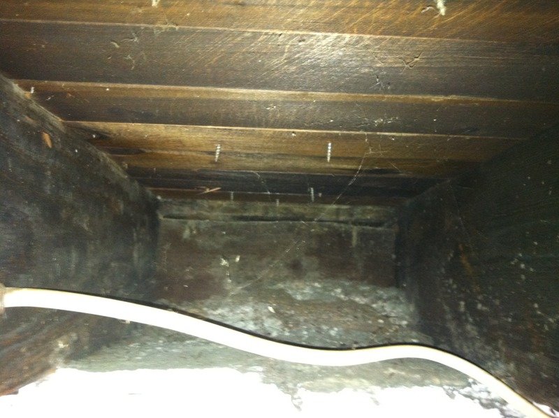

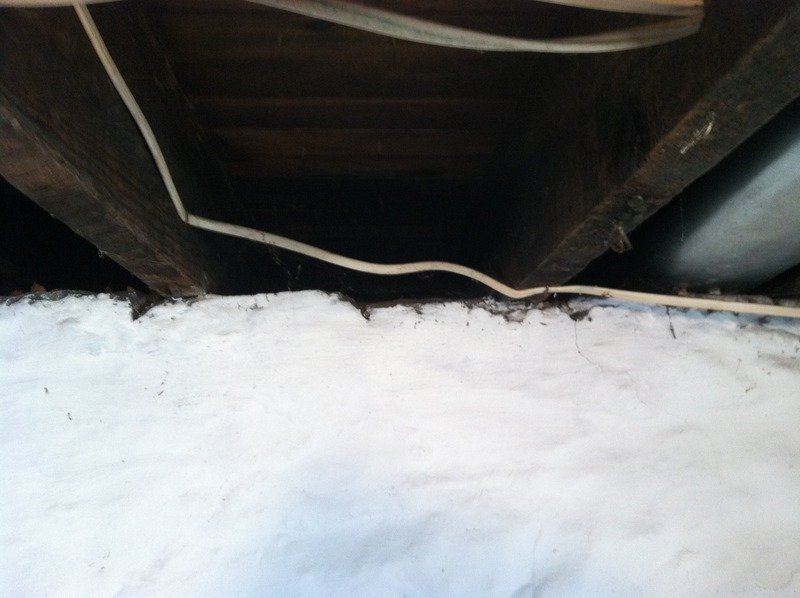

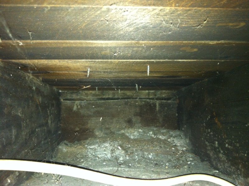

    i snapped some pics last night. i need to clean up the cobwebs for sure.
    this is the top of the foundation wall that separates one side of the basement from the other. the previous owner coated it heavily with that drylock stuff
    0AA21763-9947-4E2D-99E7-1A6AFFFC3D50_zps_315205f2e58ef8336cb2aab520e082692da0aae9.jpg
    looking up and over
    F9FE1813-0FD8-46FF-B226-05E529AA6508_zps_3682bccc10629798a0bd031d97691f1351994e52.jpg
    this is the area right below the trouble spot.
    D7B56DDE-6537-45E5-995E-5CE113653DE0_zps_ff6f57f826d444deddba8266c218a390a7799593.jpg
    the floor joists legit 2x8's, about 16.5" O.C. give or take a quarter inch.
    i pushed the old floor, there was no give to it. i'm starting to think its a subfloor issue?

    Are there screws like that anywhere else underneath? Seems for whatever reason he may have just had to replace those tiles and the backerboard, and did a piss poor job. :notsure:

    just in the area of the kitchen. i'm assuming from the subfloor.

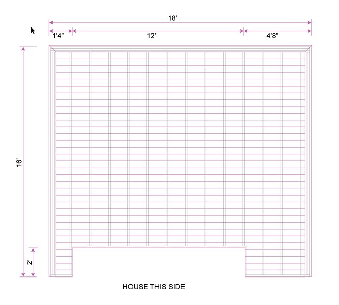

    So im going to be building a deck shortly off the back of my house. My question is, with the following layout, how many footings will i need. Do i just need 3 on the top side of the deck or will i need some in the middle as well? We plan to build a screened in porch on top of it next year.

    You going to need to give them more info like the size floor joists you're using.

    You are right, forgot about that. They will most likely be 2x8's unless i can get away with 2x10's

    You need supports at centre span

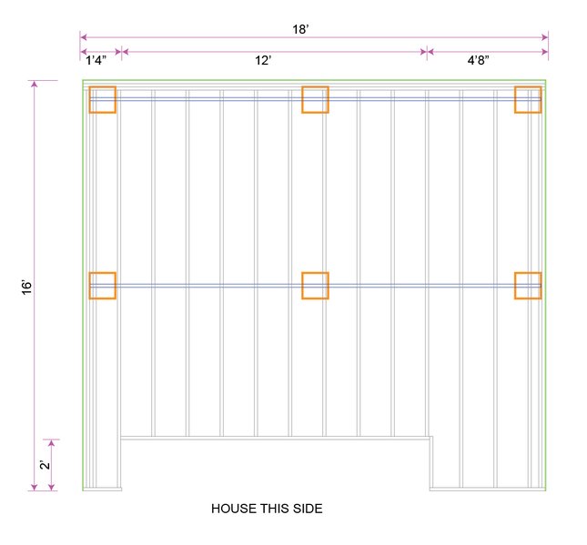

    so its looking like i will need 6 in total then?
  20. May 26, 2016 at 2:01 PM
    #6920
    daggs81
    daggs81 Well-Known Member
    Dec 11, 2012
    #92858
    150
    CT Shoreline
    2017 TRD Sport
    This is what i would think i would need then for the footings for those spans?
