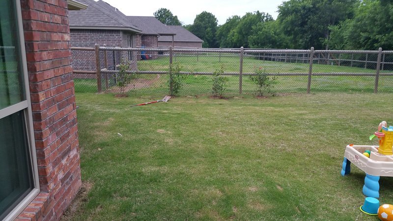

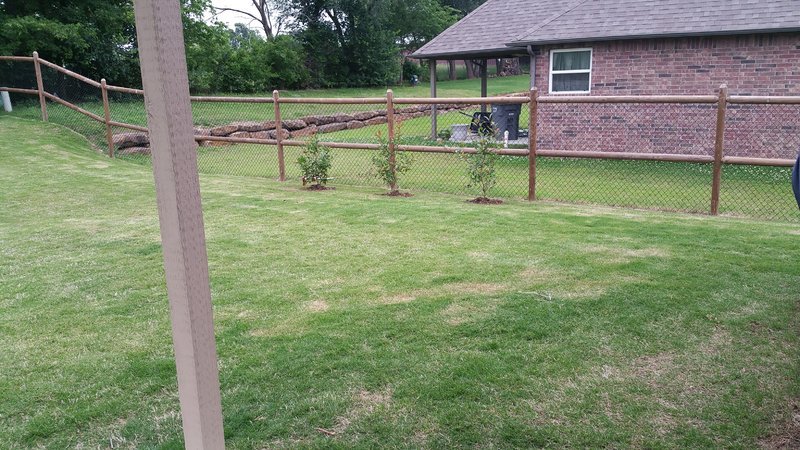

    Finally was able to move and replant my red tips. Super glad @Maticuno caught my mistake because now I'll be covered on both sides.

    That wooden posts with chain link on them? Never seen that before.

    Yup, 5ft round post and rail fence with black vinyl chain link attached. HOA only allowed this, rod iron, or 6 ft privacy fence. Neighbors already had the post n rail so we went cheap route and matched it.
    It is all over Oklahoma

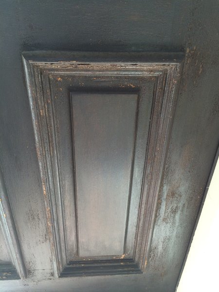

    What is something good to remove paint and stain from a front door? Any good how to/steps

    Here is another photo

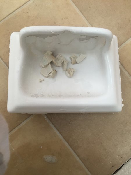

    clean up the loose thinset/material in there, and i'd think you could use a polyurethane construction adhesive to set the soap dish back in there (spread the adhesive across the entire back of the soap dish), ...once that cures, apply your white silicone caulk around the soap dish (maybe leaving a small weep/void in the caulk on the bottom as a failsafe, as you would on the shower valve handle escutcheon?)

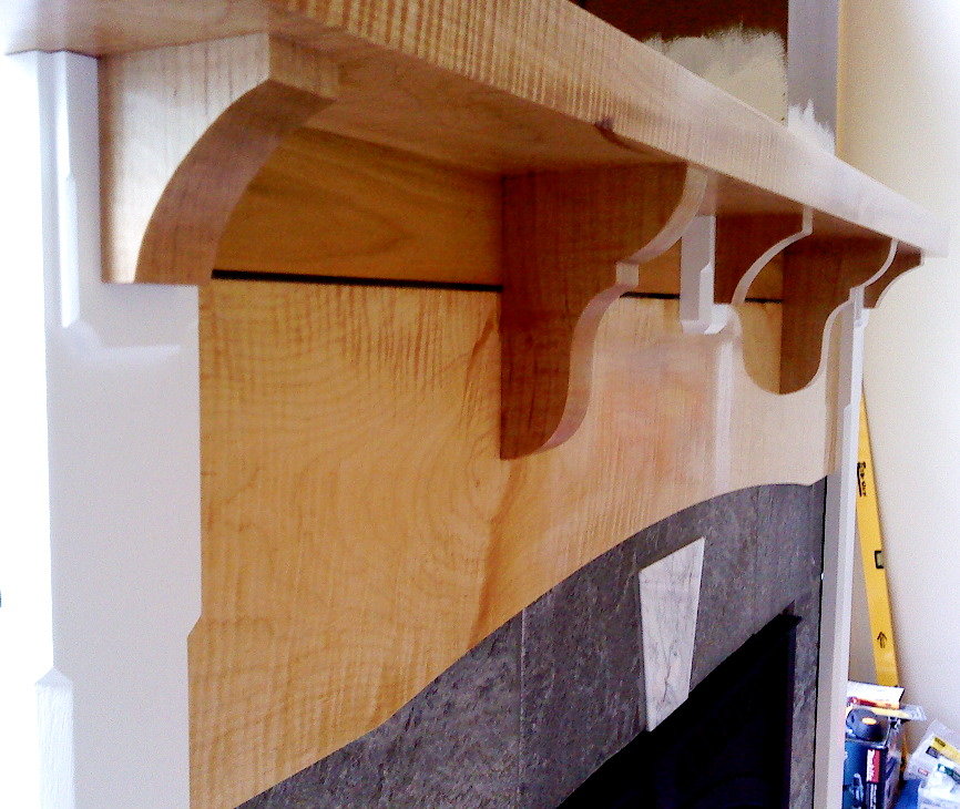

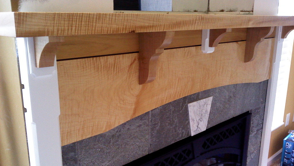

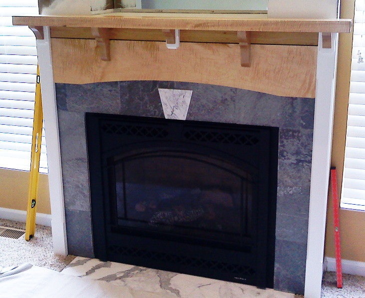

    ...ok, finally got around to posting the pics since finish/paint, finally we have a mantel!
    BTW, a few pics showing how it goes together is here: https://www.tacomaworld.com/threads/any-woodworkers.271012/page-17#post-12548990
    ...stage 1 complete!
    ...stage 2 is next (apply a moulding to cover the exposed poplar back board and the horizontal gap between it and the fascia board)
    ...stage 3 (making and installing the wood paneling on either side of the mantel, and around the columnar features that rise 8ft above the mantel)

    Depends on what your end goal is. Painting it or staining?
    If paint remove loose stuff by scraping then sand and apply an adhesive atleast primer.
    If restaining. Use a striper to remove most of it and light sanding for the rest, easiest way would be to remove the door and work on it while it's flat.

    very nicely done!, i wish i had a fireplace....

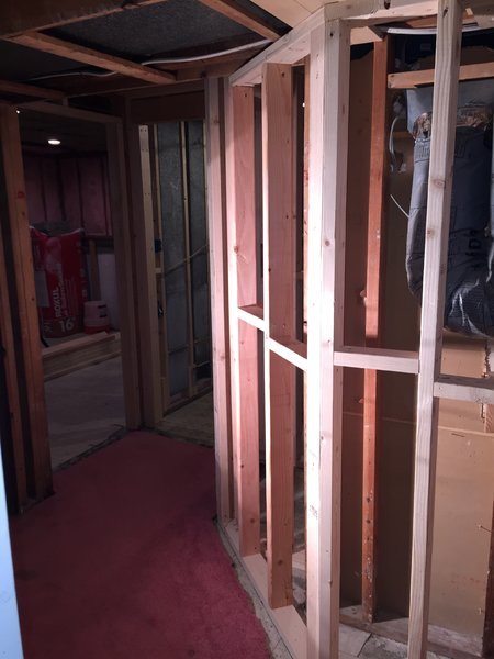

    Well, it's been a slow process but i thought i'd give an update on the basement room renovation. Looking to get it sheet rocked by the end of this week...Doesn't look like much but it's a hell of a lot of work!

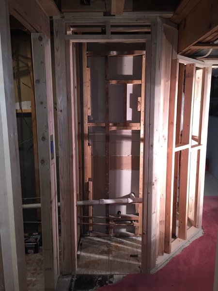

    IMG_3604.jpg this is the closet/hallway right outside the room which i completely rebuilt.....
    IMG_3605.jpg took a while because of the angle, easily done just took a lot more measurements and cutting but it came out nice and solid as a rock!

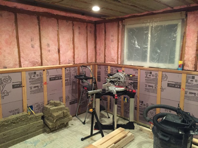

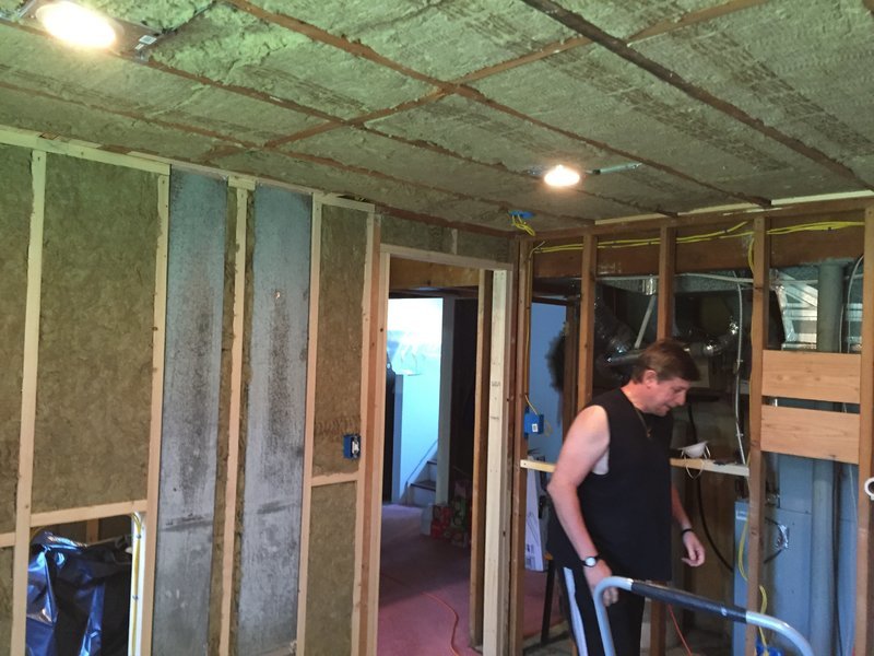

    IMG_3623.jpg looking in from the door....finished putting the rigid insulation on the bottom half wall...Each panel had to be individually cut, what a pita but there all tight.IMG_3636.jpg this is looking out the door. That's sound/fire insulation in the wall and ceiling, which i still have to complete. This room is 1, under my room and 2 next to the laundry room as well as the furnace room so noise suppression is a factor. Don't mind my brother/helper..

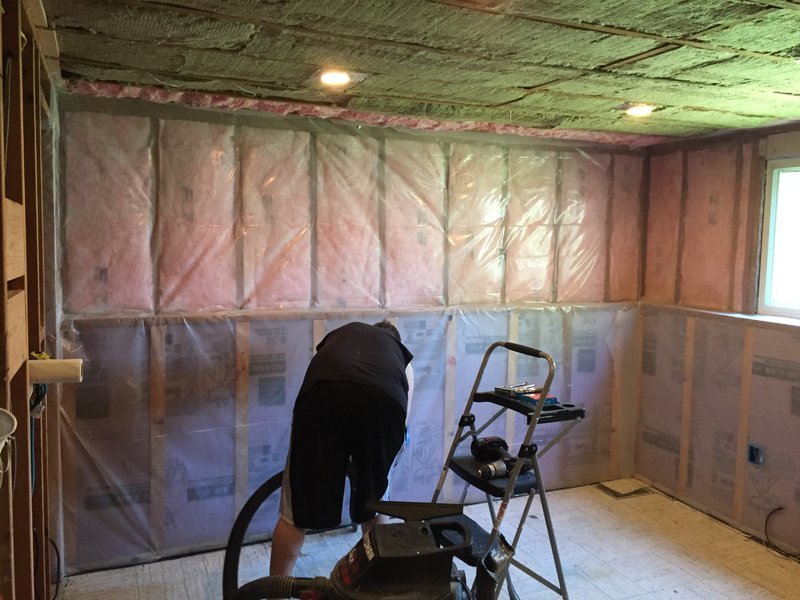

    IMG_3633.jpg this is after installing a 6 mil vapor barrier.... Still a lot to do but getting there!....

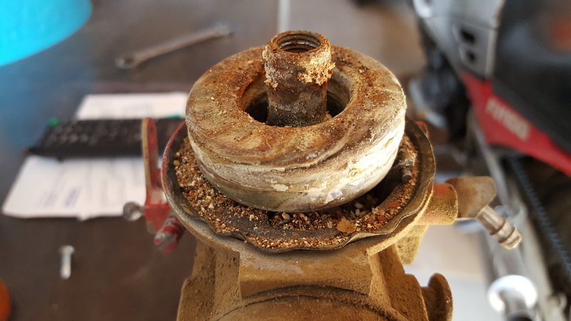

    Does repairing home improvement equipment count in this thread? My dad told me the family owned branch chipper wouldn't start and was leaking fuel. This is what I found when I took the carb apart...

    hmmm...
    I wonder why it wouldn't start?!?:facepalm:

    wow...looks like it got water in there and corroded it..

    Maybe some E-10 that absorbed some water or phase converted and sat in the carb.

    My guess is rain water intrusion. It rusted a hole in the bowl.
