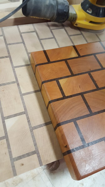

    Looks like black walnut

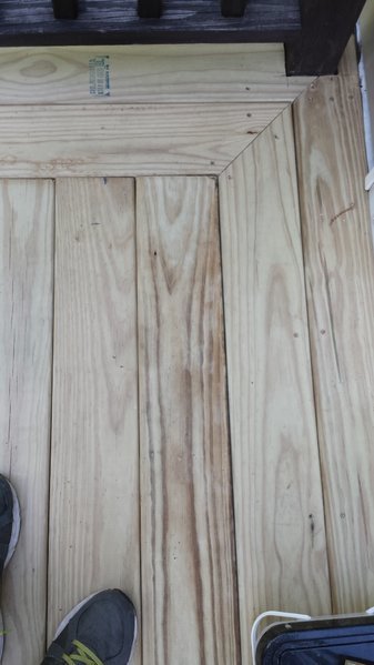

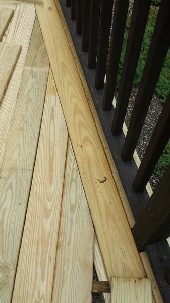

    Refacing my deck. Decided to do a picture frame around the edge. It was a bitch to do because it was not previously framed for that. After a day or 2 of framing figuring I started the decking yesterday. Should be done tomorrow. Then onto stairs and railings. One thing of note I bought GRK deck screws and I have to say they are amazing. I couldn't make a piece of wood split with them. They go in effortlessly. I highly recommend them

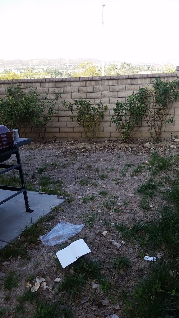

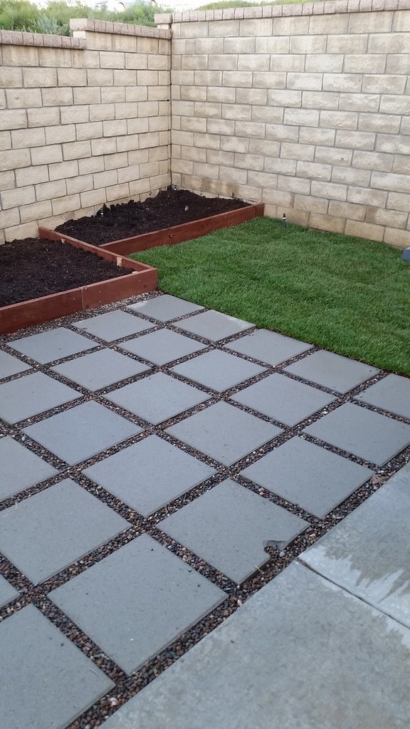

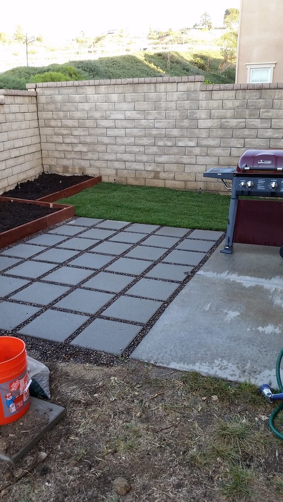

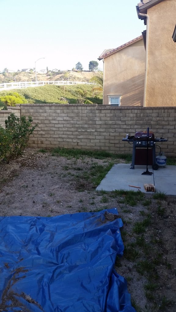

    did some work in the yard a couple weeks ago. I wanted more patio space (all we have is a 8x10 slab) for entertaining, but I didn't want to break the bank. This was my first true "project" I've ever done, and I'm pretty happy with how it turned out. Put in some pavers, garden beds, and fresh sod. Next phase is to extend a gravel patio and fire pit next to it (opposite the new sod, where the home depot bucket is lol). EDIT: The chipped paver was to make way for a sprinkler head, as I didn't want to change the irrigation. I'll be replacing it with a paver properly cut, or remove that head altogether.
    BEFORE
    DURING (putting in the paver base)
    RESULTS
    total expenses were around $500, including buying some tools that I needed anyway (shovels, pickax, wheelbarrow, etc)

    Cherry is the lighter, the size of the board would have been pretty heavy out of maple, plus I didn't have any in the shop 8/4 thick at the time. And oz was correct with black Walnut.

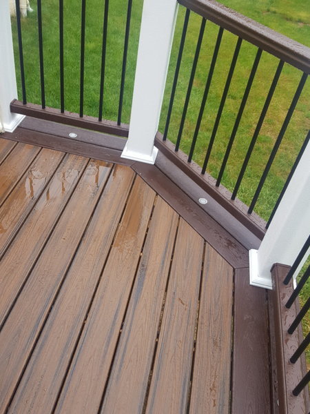

    Trex decking is finished stairs and out the grill island/bar still to be built.

    I have to say I will never use a y other specialty screws. They are amazing. Yes I said it, a screw is amazing. It's night and day from anything I have every tried.
    I just got some 5 1/2 structural lags. Same torx bit, using for railing posts and I'll add some to reinforce the deck to the sill plate. They go in like drywall screws. It's insane.

    Is there any spacing between your boards?
  15. Jun 3, 2016 at 6:27 PM
    #6975
    pudge151
    pudge151 Well-Known Member
    Apr 4, 2010
    #34558
    4,066
    Sean
    Connecticut
    2015 Tundra Platinum
    No I butted them tight. It's wet pressure treated. It should shrink up about a 1/4 gap
