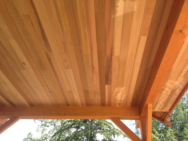

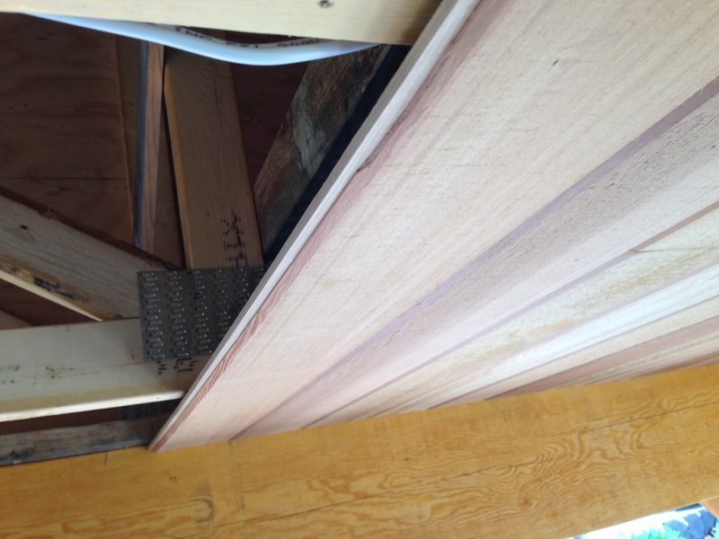

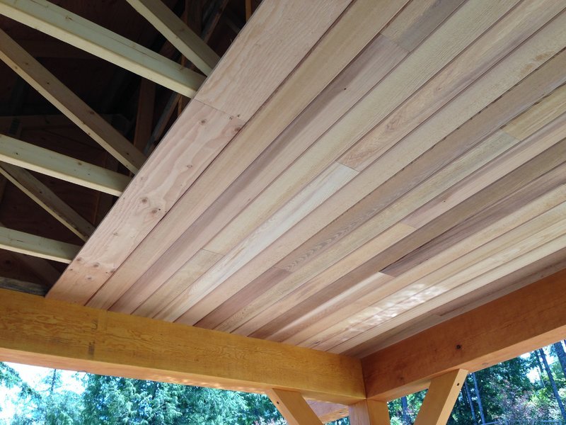

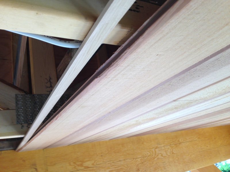

    So just finishing up the flat soffits
    I started in the middle of the span to make sure the rows would be equal on both sides so when we install the retro potlights they align on board centres and are equal in all 4 corners
    To stay on track I found centre and chalked a line for my first board , installing a plywood cleat to keep the boards from migrating as I seated the rest of the rows
    Having done all the boards on one side I removed the plywood fence and installed a spline to change direction of the tongue and carried on the other way
    All done , just need to hit it with a coat of the Sunfast
