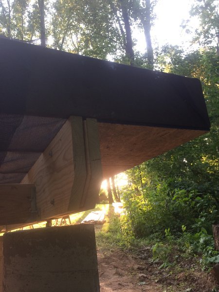

    I installed 1/2" OSB to underside of joists, all square and from Tague.

    You have OSB on the underside of the joists and plywood on top ?

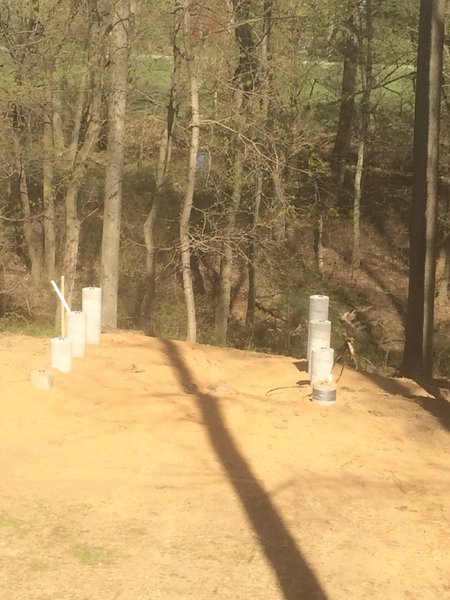

    Yes, the shed is on sono tube columns. My yard slopes away from front to back. I installed the OSB to hold and protect the R-30 insullation.

    Here are some pix

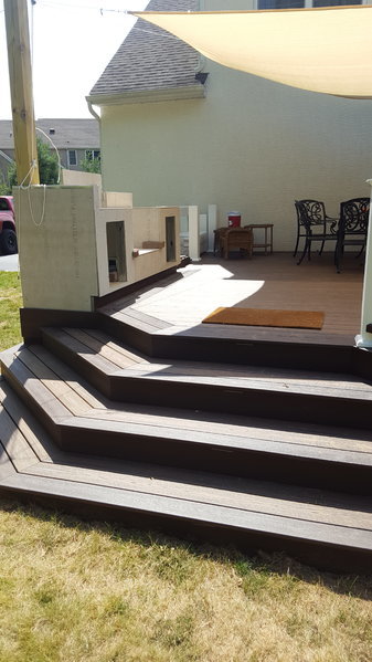

    Not much visable progress today. Set up to wiring inside for the switches for the lighting. We moved them from the back splash to inside the cabinet for a cleaner look.

    Looks great, how do you like that hidden fastener system for the Trex? I installed that same system about 6 years back and have not used the gun since.

    No gun just clips and a screw at 45°. It's ok if the wasn't trying to keep two sections in line it would be great but as the trex size was not consistent they were actually a pain in the ass as one side pulled tight was 1/2" different I had to take one side up and adjust the spacing. My fault for not checking and my guys keep the brackets spaced just like trex's instructions said.

    I have a gun which holds a magazine of screws, like a nail gun. The hidden fastener fits on the business end of the gun, set the gun magazine on the joist and against the groove of the Trex and bang, the screw is shot in like a nail. Extremely time consuming.
