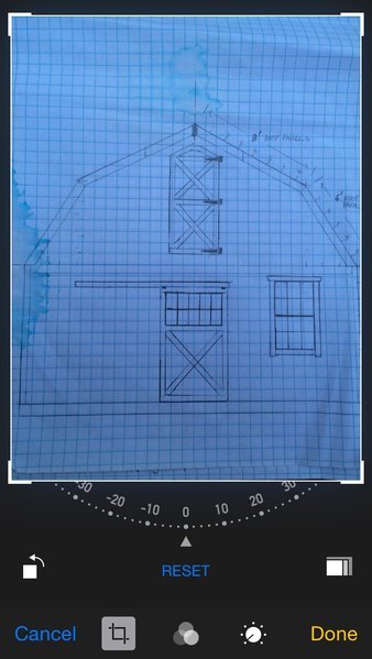

    Here is a sketch I drew up

    I was just wondering because of the 20' span of the 2x8's

    Yes, a legitimate concern. I installed strong backs 4' in on each side running the entire length gable to gable

    In a picture on the prior page you can see the strong backs .

    FWIW , I have a 16' wide shed and I store lumber in it's attic , ceiling joists are 2x10 & 16" OC and the joists have sagged about 1 1/4" at mid span over the last couple years

    I am guessing you will be addressing that at some point?
    I am thinking now, maybe I should add a row of solid bridging down the center as well.

    Nah , its just an open shed , I don't really care , mine has solid blocking down the centre too
