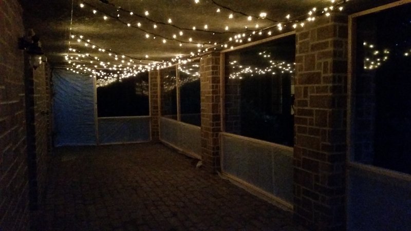

    We are having a party for my wife and I turning 40 within a month. We are expecting 35 guests and the forecast is calling for an inch of rain on saturday.
    So I improvised this.
    Nothing complicated except that I could not drill holes in the masonry, so everything is pressed in place. Wife loves it!

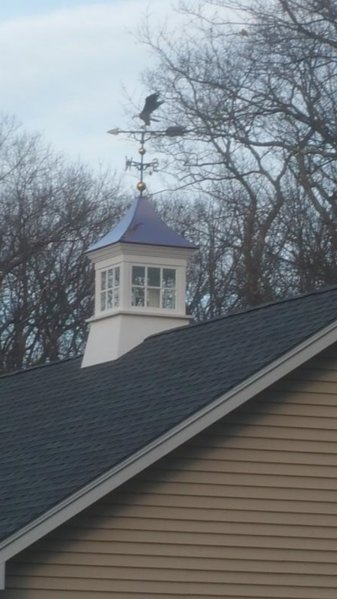

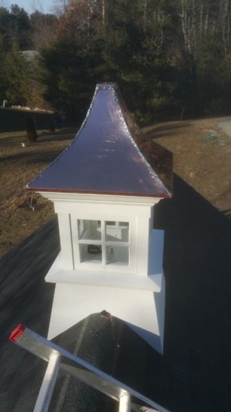

    I got the sheet at a supplier in our area, Harvey Building Supply. The seams are bent over the sides with solder covering the lap and the opposite side to look even.
    I was going to do a standing seam hip, but I didn't have access to a concave seam shrink tool at the time.

    Did you use an iron to solder with or a torch? Torches and whatnot I have oodles of, buying an iron for one project seems a bit excessive. Did you use felt or Grace under it? Would be worried about burning it using a torch, even a low flame.

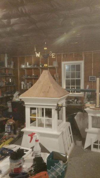

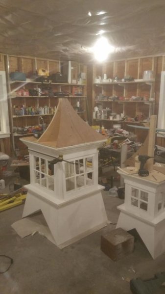

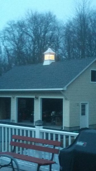

    Gotta use a torch, with flux. I used bar solder because you'll go through miles of spooled solder. I didn't use blueskin or anything under the copper. Luan sheet with the grain going horizontal helps with the pagoda roof bend.
    Some of the cupolas I've made for friends....

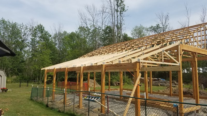

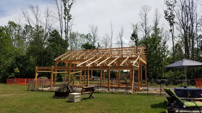

    Holy chit, I've done a lot already!!
    Not today, started on June 4th. Not necessarily a home improvement, but we need a "external" garage to get the home improvements done.

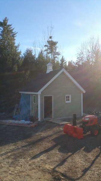

    More after install... All have LED lighting set up on timers.
