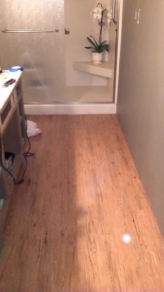

    Looks great

    What kind of floor is it ? Hard 2 tell by the pic. Thanks.

    It's a vinyl plank (Allure) from Home Depot. It's a self sticking floating floor. I believe the color is Country Oak. It was an in-stock color. They have another we liked (Iron Wood), but you had to special order it.

    Thanks. I just put in a floating floor - Pergo. It isn't self sticking. How does a self sticking floor float ? I had to leave a gap around the outside edges for it to expand - did you ? How does it float under a toilet ? I'm thinking of doing the bathroom but don't know how to treat the toilet situation. Thanks.

    Make a paper template of floor, lay the floating floor on top of the paper template, then make the marks and measurements for the cuts. Pull floor back apart and do a final install. Time consuming but if you do it right the first time you will pat yourself o the back later.

    It sticks to itself so it becomes one big tile. There's a portion of the tile that is adhesive (about 1" border around the tile plank). One side the adhesive points up and the other it points down.

    Thanks. Mine just snaps together - no adhesive. Did you run it under or around the toilet ?

    Under. I've removed the older toilet and am going to replace it with a newer low-flow unit. I did leave a small gap around the wall but it's thin enough that it could actually slip under the drywall. I'll cover the gap with floor moulding. I've never done laminate but if you can, I'd pull the toilet and tire around the smaller opening. You'll need a new wax ring and you'll want to plug the pipe with a rag while you work around it to keep the sewer gas down. Since the toilet will cover it, you don't need the hole to be perfect.
