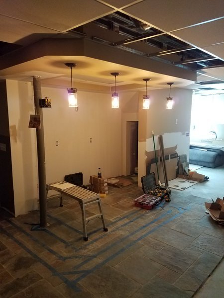

    Basement mancave for a customer
    That's where the bar is going. Reclaimed bar wood (had to buy a metal detector) with walnut tops starting this week. Maybe.

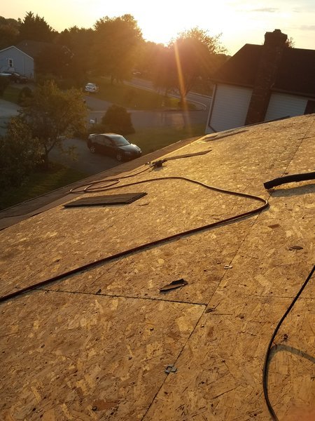

    Started ripping my roof of Thursday. Toyota calls me Friday morning to tell me my frame is in and can I bring my truck in monday.... I have to take the lift off the truck and flat bed it to the dealership. They know this and I expected a little more heads up.

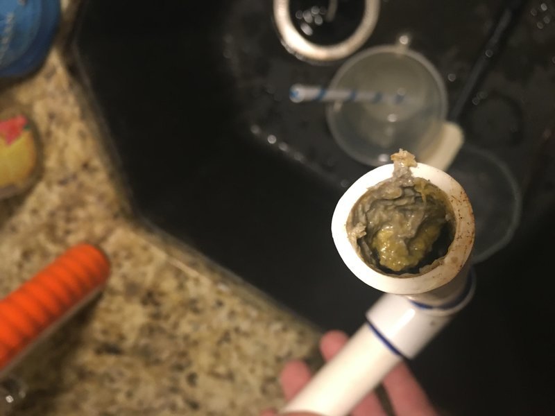

    Had to replace the drain pipe on our AC unit today, got home from school and water was dripping from a return down into the living room.
    Turns out some little pieces of insulation from the panels around the coil were flaking off and clogging the 3/4" pvc drain.
    What's aggravating is the previous owners must have known about it because there was a towel stuffed around the pan that wasn't more than a few years old, but they didn't mention it to us.

    Looks like the ice machine drain that I just spent 3.5 hrs on (at work).:facepalm:
    Previous owners must disclose all known defects.:evil:

    Were the main drain and the back up drain lines both clogged? I'm confused how it'd be dripping on your ceiling if just one was clogged.

    That sure looks like airborne contaminates and algae from lack of maintenance you need too put some pan tabs in to help control that future build up or hook up a wet vac a few months and suck that shit out....

    At least you were getting paid for it, I only spent about an hour re-plumbing it though so it wasn't to bad.
    Yeah, I'm not sure why they wouldn't disclose it as it was a pretty simple fix.
    This unit is only setup with a main drain pan, the secondary drain line was capped off.
    It's an updraft system and the intake is a design that pulls from both upstairs and downstairs, when the pan overflowed it dropped water down onto the filter in the ceiling downstairs and then that dripped onto the downstairs floor.
    It's the texture of insulation and the insulation for the panel that you pull off to access the unit is in bad shape.
    This weekend I'm gonna clean the coils, flush the pan and then add some tablets to hopefully keep everything running smooth.
    Also got some duct insulation to replace the insulation that's on the panel.

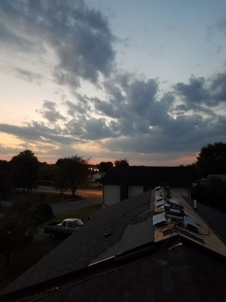

    Roofs done over the house, garage next in a few weeks. Someone drove by taking pictures, then by the time I was down to try and catch them the town stopped by. So either they called or I'm getting an Osha fine for no fall protection, which won't matter since it's my house. Ugh hate roofinh

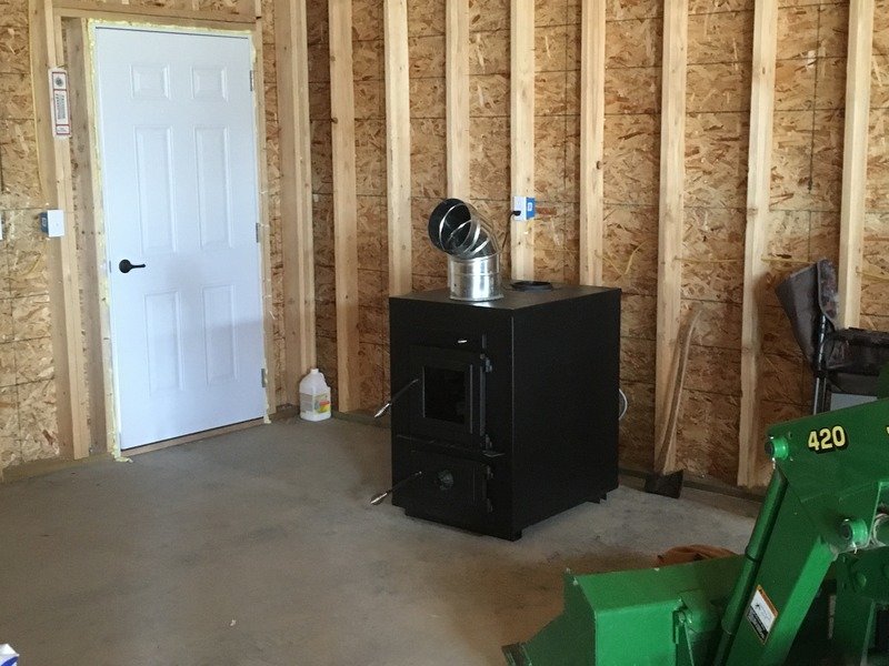

    Getting ready to cut a hole in another wise perfect metal roof for my shop wood furnace
