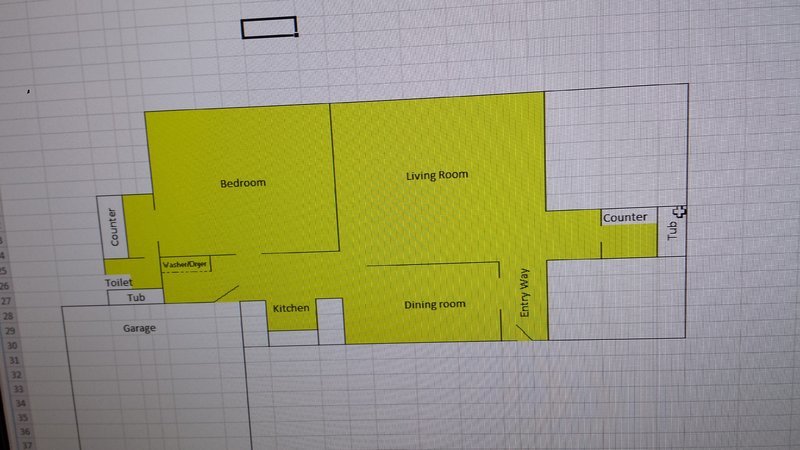

    Half brick pattern on the diagonal if square tile.
    Front to back if rectangular tile. Never run long rectangular tile longwise down a hallway. If your lines are off at all it will show.

    Have the tile down to 2 choices... wood look 6 x 36 or 12" & 6" square :goingcrazy: can't decide :goingcrazy:
    Half brick on diagonal if square?

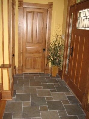

    This is one of my fave patterns. But then again I just don't like long continuous grout line or the checkerboard look.

    With either tile I would definitely go front to back(the narrower part of the rooms. That way you will not be looking down the grout joint on a long run. I will find a pic in a bit of how NOT to do it.

    that is one of the patterns I'm considering. I do like the look

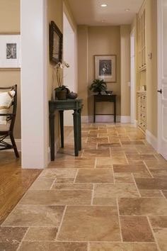

    Similar
