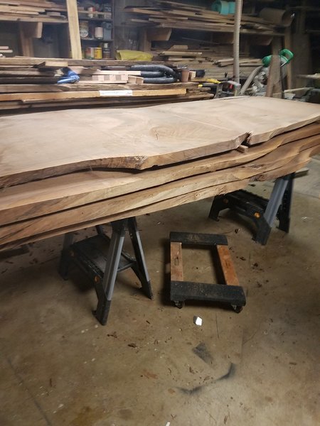

    Picked up some walnut today to do counters for a customer's bar. had to clean up a few spots to see the color and figure. now to figure out how I'm going to flatten them

    How bad is it ?

    Not bad, I'm going to do a routersled setup, i want to be able to take it apart when not in use, so I'm not sure how I want to build it yet
