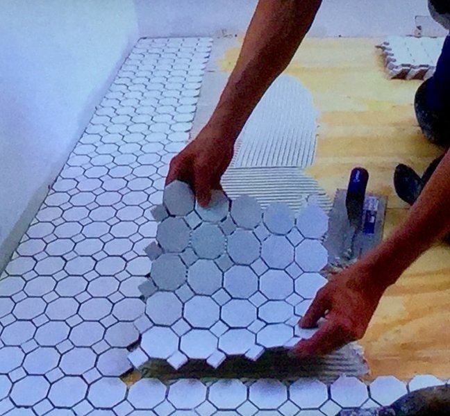

    I'm in the midst of remodeling my master bath. I've layed plywood on the floor and will be putting cement board on top of that in prep for tile. While watching a remodel on TV I saw a contractor laying tile directly on plywood (in a bathroom). Since grout is not water proof this seems very wrong. Is this an acceptable practice?

    I'd never do that!

    I would have put some CBU down or better known as concrete backer board....

    I always use Schluter Ditra , its better than using concrete backer board

    While Schluter may be preffered it's not readily available here and it's damned expensive. I know there are benefits but cement board works just fine, is easy and cost effective. I'm using deck mud, a water proof membrane and special drain for the shower.
    I thought hard about in-floor heating but it adds height and the bathroom floor will already be higher than the hall floor. The bathroom was originally built with vinyl flooring; adding cement board, mortar and tile raises it up. I'm trying to minimize the difference as much as I can...

    In a home with solid framing it works. But there are much better methods available today, backer boards, uncoupling membrane. Ect.
    @OZ-T have you used wedi yet?
