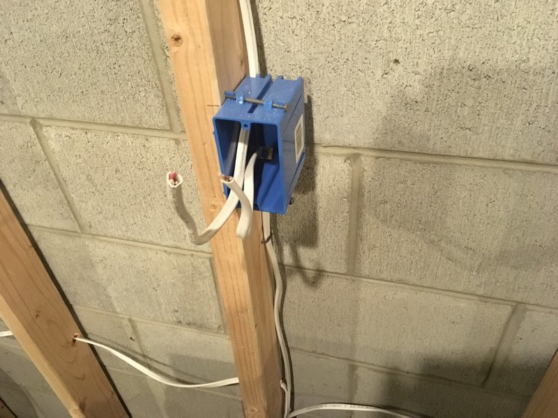

    Yup gotcha....I just ran this wiring for my fan so I have control over the fan and light without the remote.IMG_0026.jpg
    Cuffs likes this.
  19. Jan 29, 2017 at 7:10 PM
    #9179
    Justified
    Justified Well-Known Member
    May 16, 2015
    #155392
    407
    Wayne
    Nevada
    2023 MGM 4x4 TRD Off Road
    14/2 hot wire coming in and 14/3 wire going out to the fan?
  20. Jan 29, 2017 at 7:12 PM
    #9180
    Frkypunk
    Frkypunk "Death is what you make of it."
    Oct 1, 2013
    #113657
    1,736
    Timmy
    Woods of P.A.
    2010 Tundra limited,2015 Highlander limited, Prius(commuter)
    Got the gas mileage down to 13mpg! Modification complete
    Yup...14/3 is the switch leg ....getting fed from outlet. There is only 3 outlets on the 15amp circuit.
