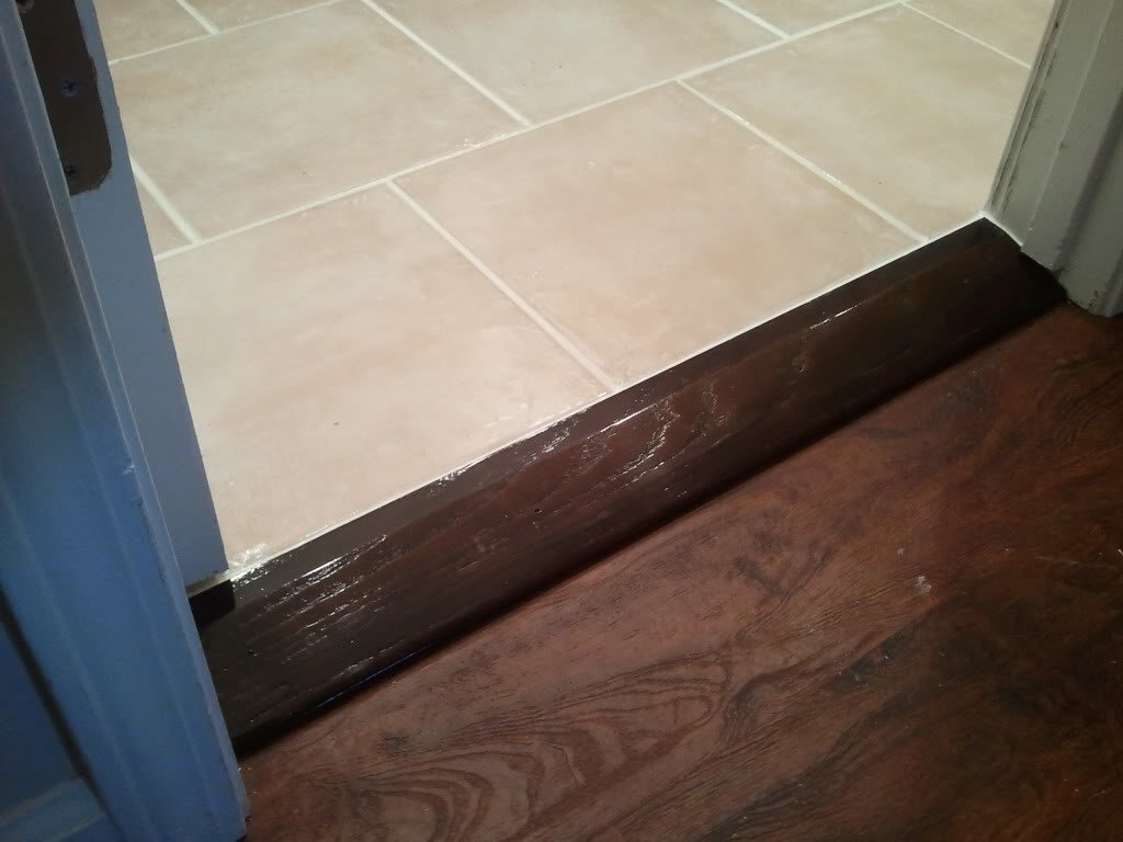

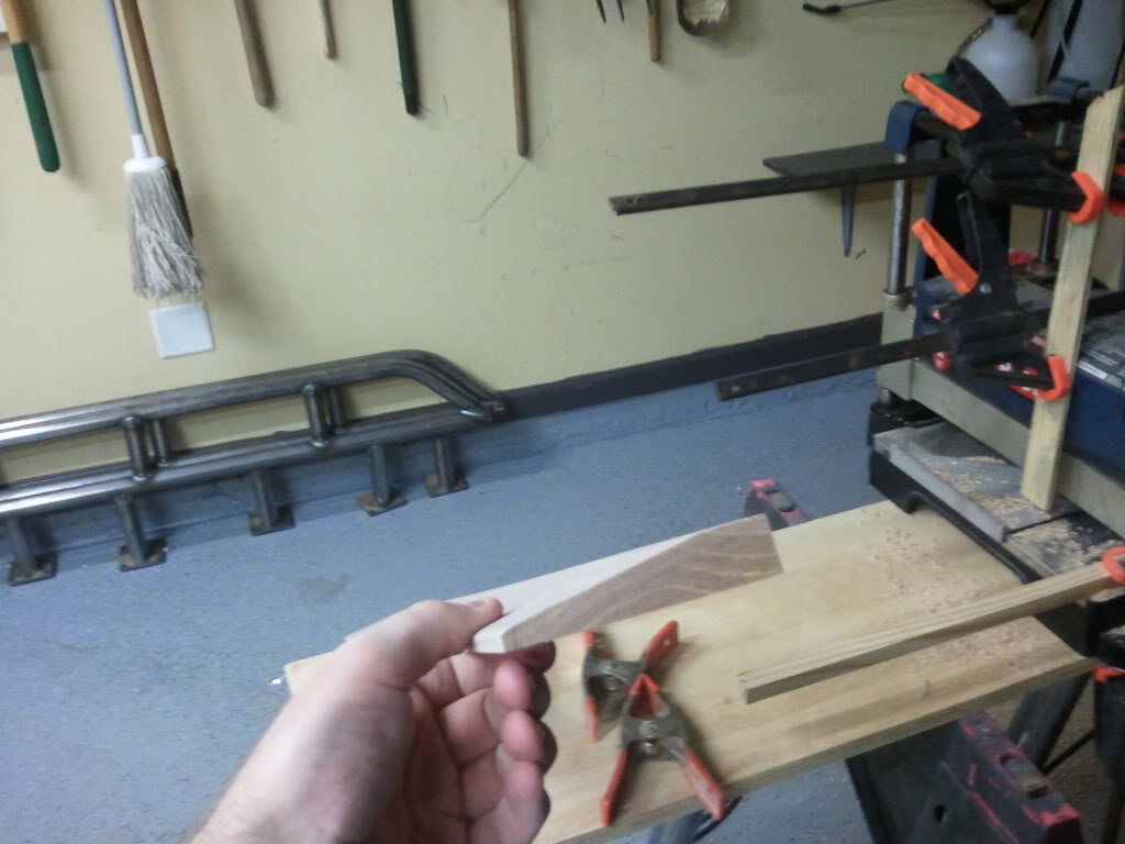

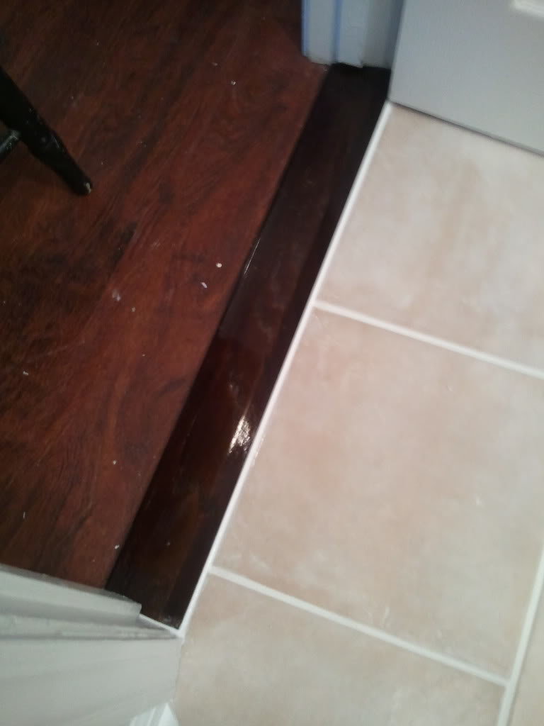

    You can put a transition piece in. Cracked tile doesn't look right either. ;)
    Here's a transition piece I made when I had the same scenario. It only ended up being about 3/4" higher.
