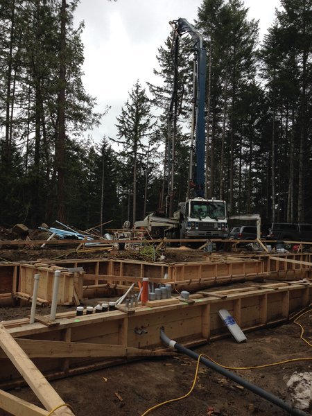

    So we got it all poured today , thank god that's over , calculated at 22 yards and they ended up taking back just under 1/2 yard so that worked out well

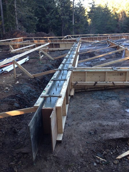

    5/8 x 8 anchor bolts @ 16" OC in the shear walls , 4' OC everywhere else

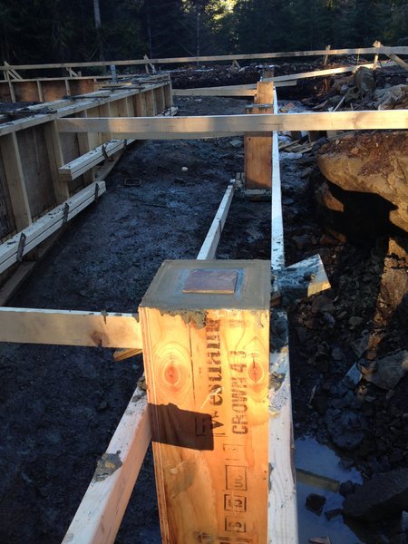

    8x8 columns that will have 3" round steel posts field welded to them

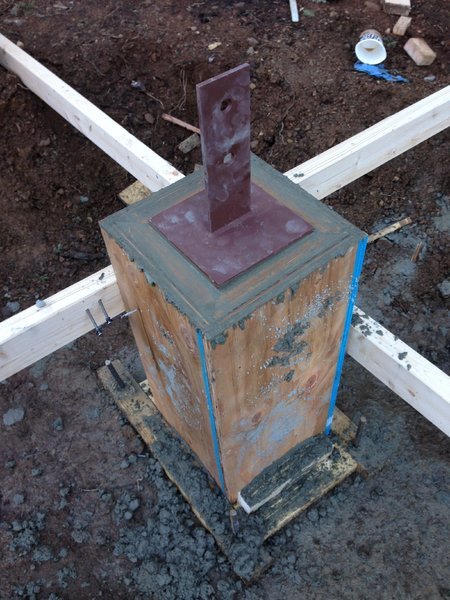

    10x10 column with knife plate for 8x8 wood post
